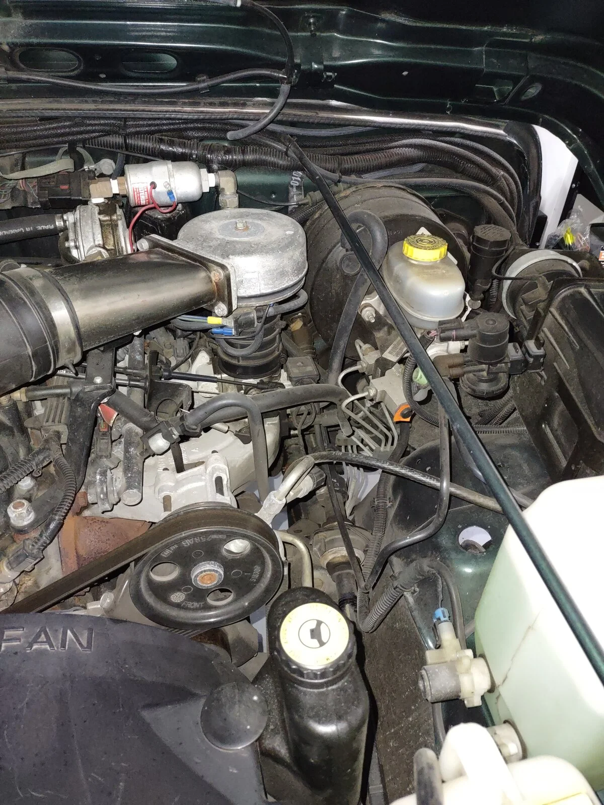

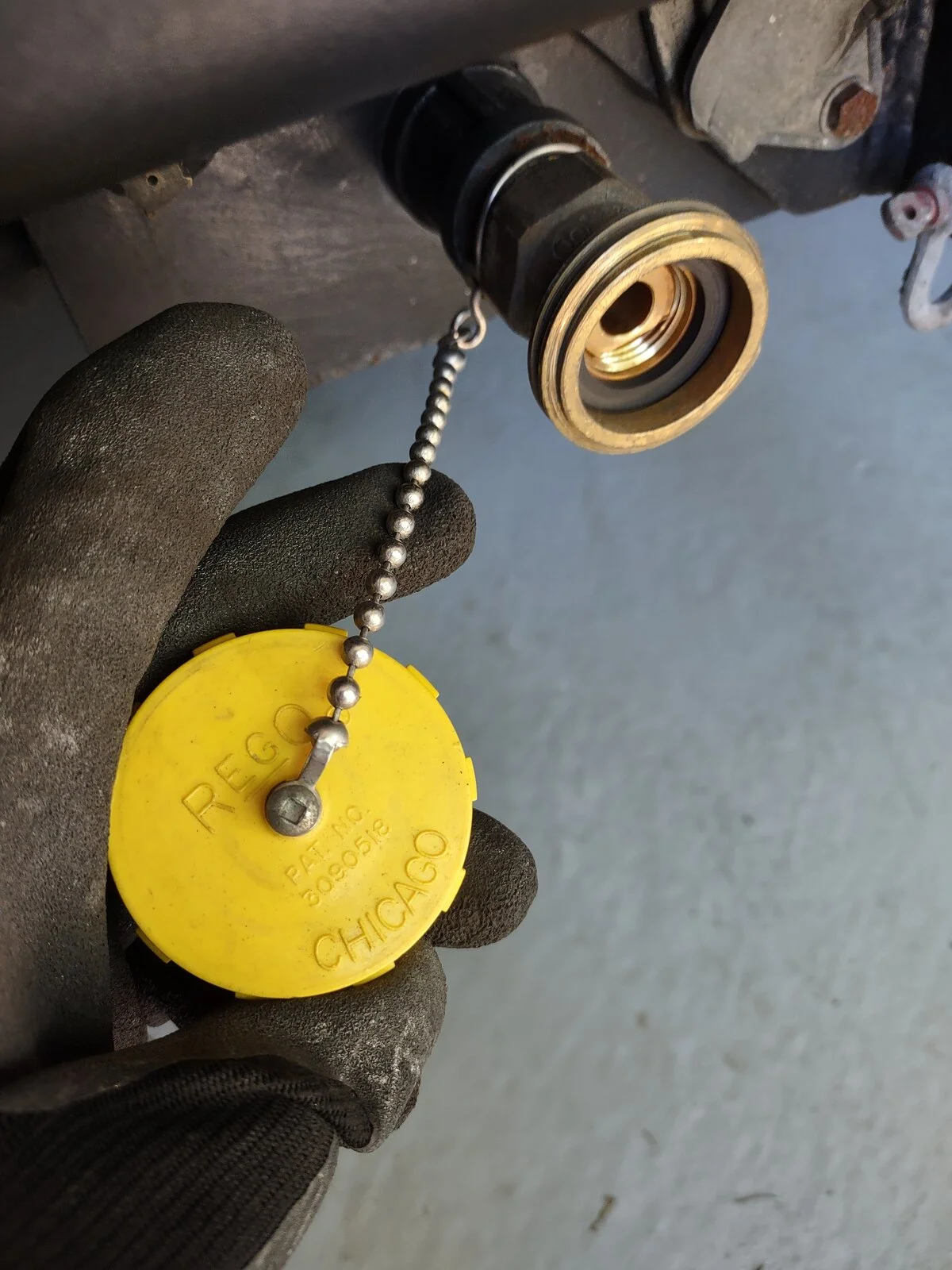

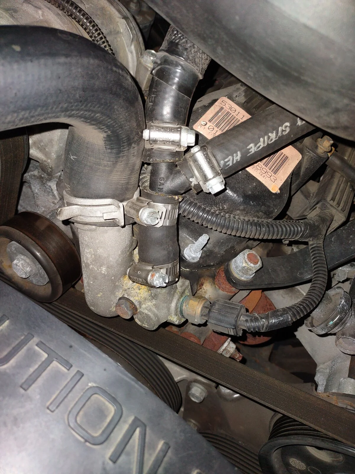

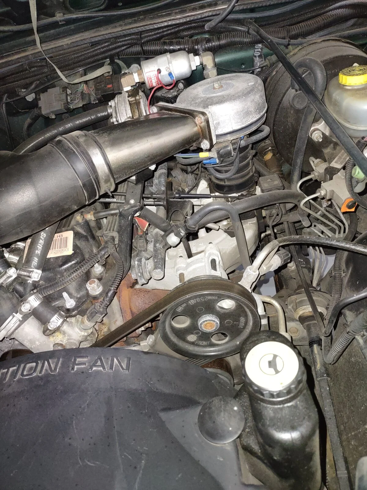

Guys I'm still confused, so my TJ runs on propane?

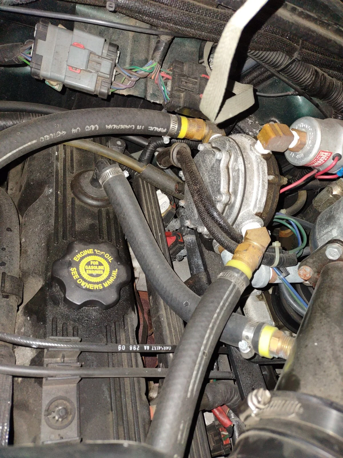

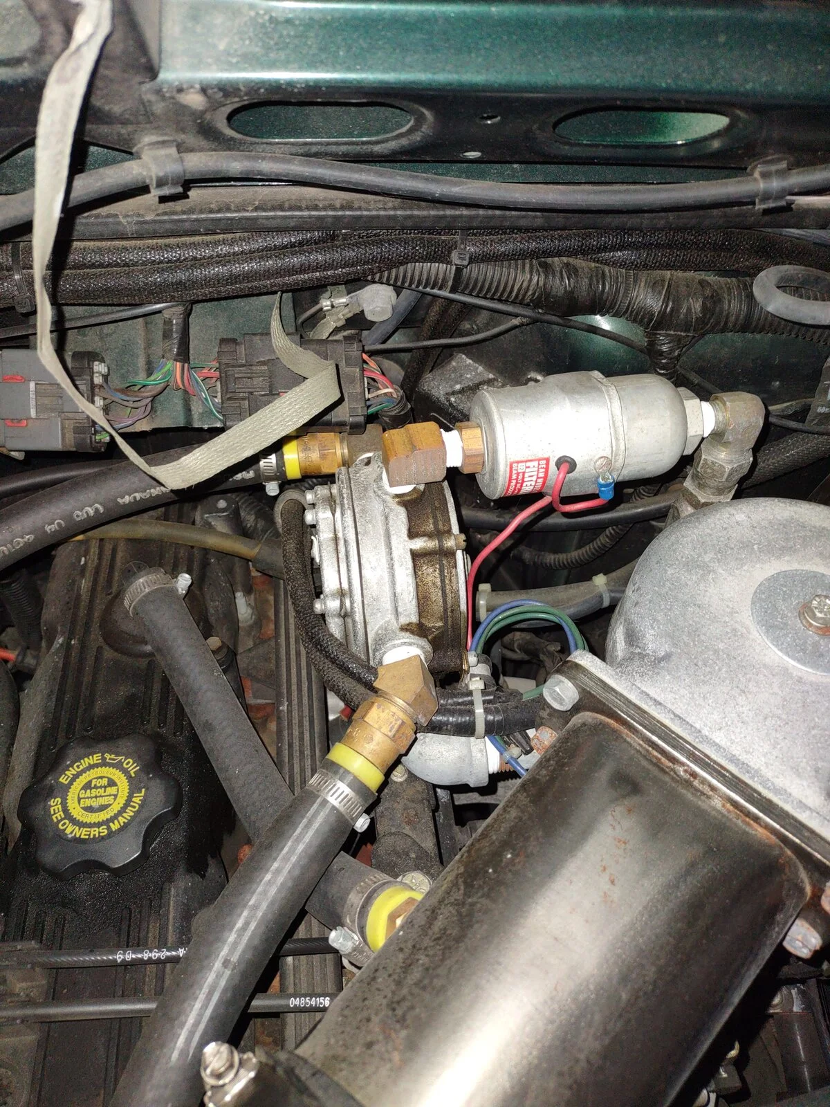

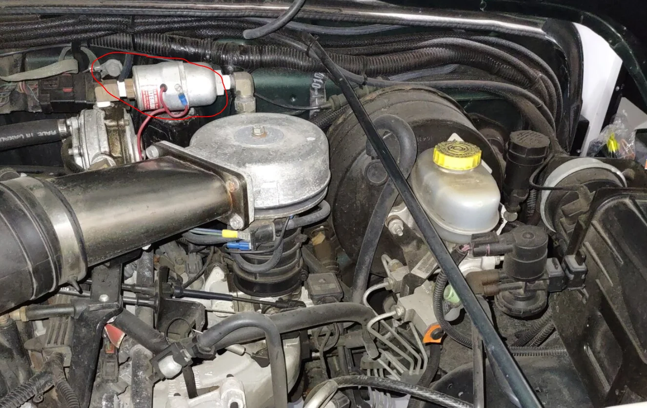

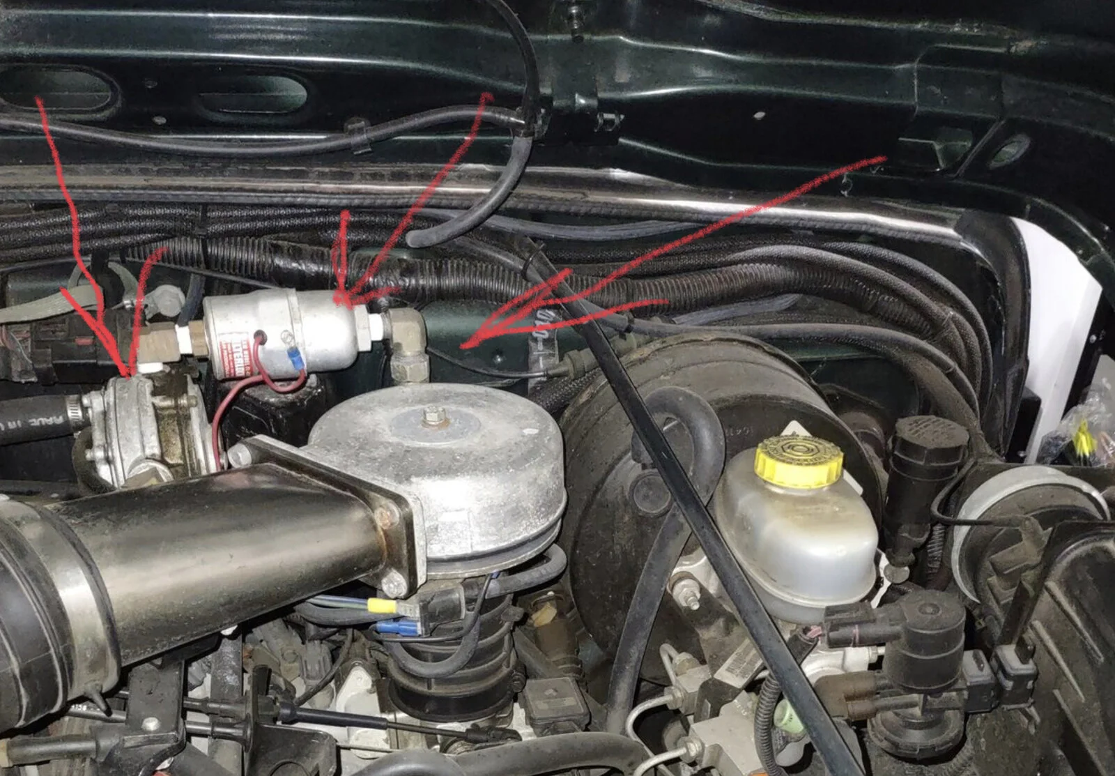

I've owned both a Cherokee and Grand Cherokee with the 4.0 engine converted to run on propane (lpg).
Looking at your engine bay I can see that a heater hose has been tapped into to heat the vapouriser unit attached to the bulkhead.
There also appears to be a solenoid and the intake/throttle body has been modified with a connection to the vapouriser.
It looks as if you have the parts fitted to run on lpg. Both my Jeeps started on petrol and when the vapouriser was warm enough to change the liquid propane, as stored in the tank, into its gaseous state for injection into the throttle body, it changed to lpg.
Being volatile and potentially dangerous it would be a very good idea to have the system checked by a qualified auto lpg engineer before filling the lpg tank.
Can you get some more pics of these areas?
Thank you!!
