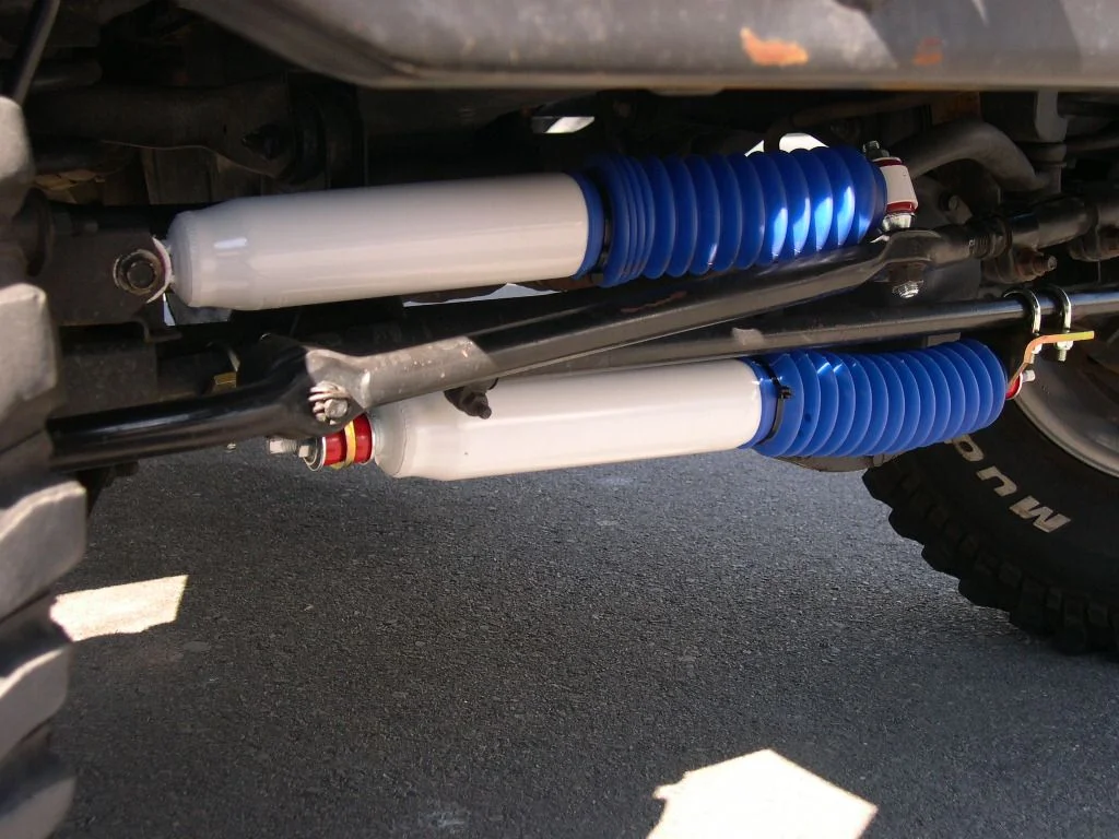

This thread got me to thinking about the various ways 2 steering stabilizers can be installed. Here is the method that should have been used in the original post:

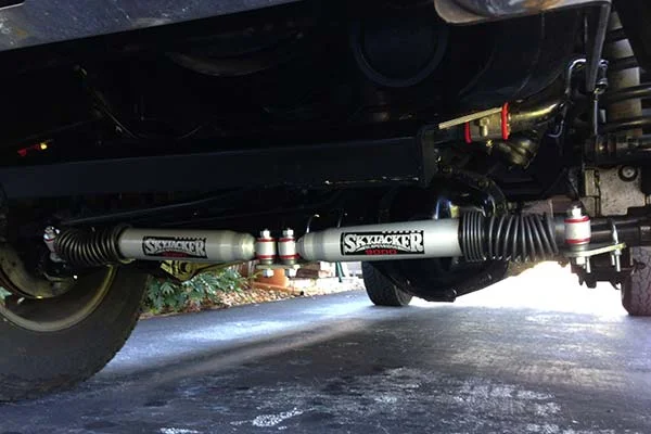

I also found this:
I guess your options depend on your steering parts and your lift. Regardless, you shouldn't need 2.

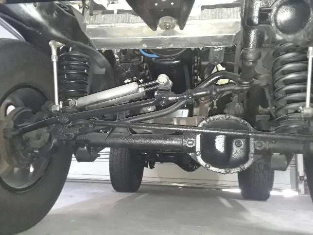

This works for me, but it's just one double shock. Smooth sailing up to 95 mph with no handling issues. The coarse finish is not rust, for some reason I used hammered paint. I was probably socializing with Señor Cazadores at the time.
No doubt but dual stabilizers just aren't needed plus they just make the power steering system work harder. On a hot day when you're on a tough trail with lots of tight turns it could make the difference in an overheated power steering system or not. Mine has gotten hot with just the normal single stabilizer which is why I'm running an aux cooler for the power steering system.
