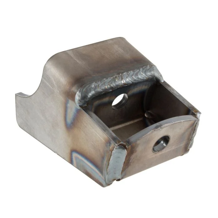

Blaine, what do you typically do for lower front mounts with the 11”? Do you have any pictures of options to give ideas? Thanks
We use the Poly kit, adapt the top to the stock spring perch, mount the lower next to the lower control arm after cutting off the shock mount.
Do you weld a bolt on as a stub on the lCA mount on the front axle? Trying to picture it in my mind…
