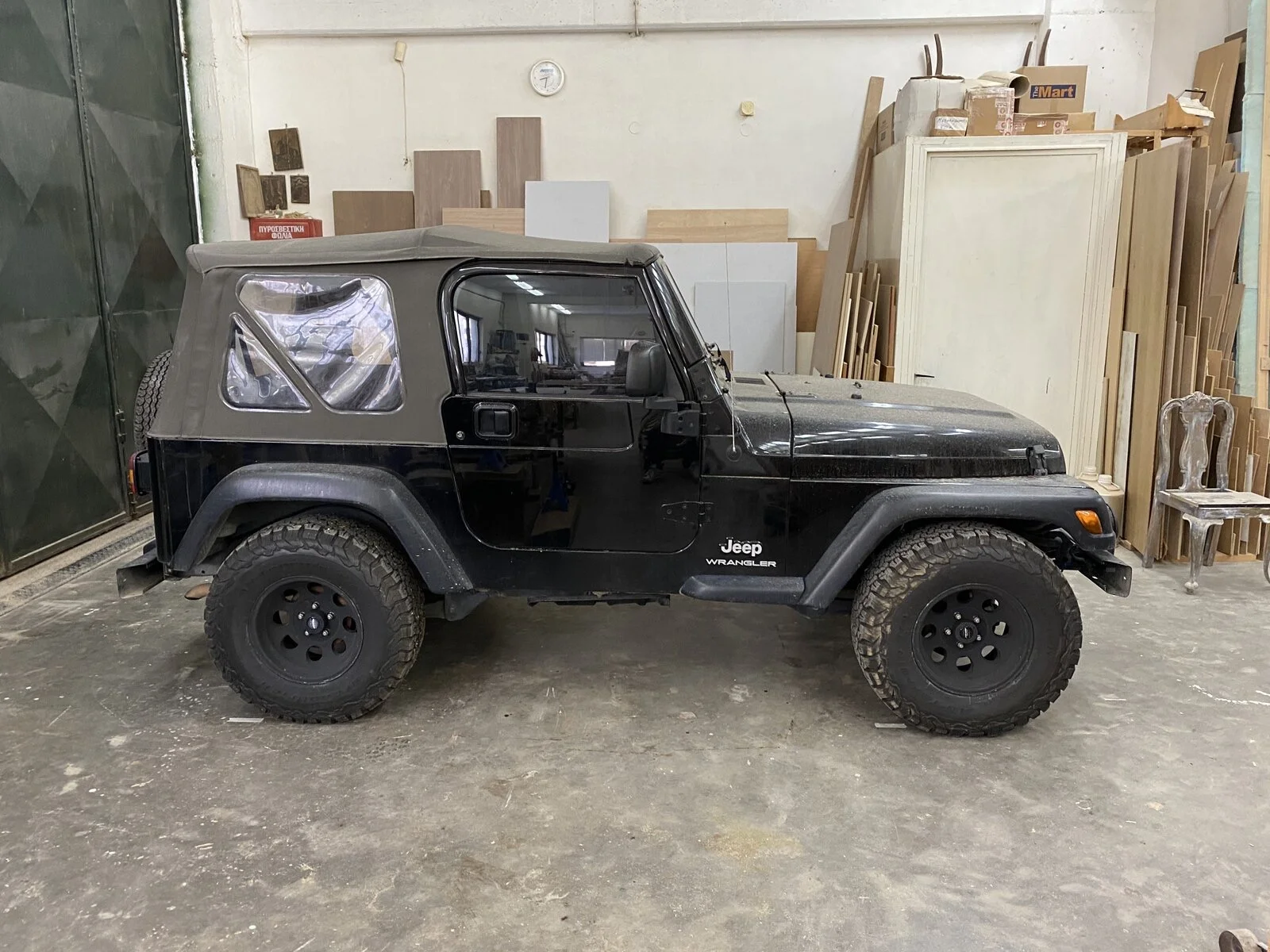

OME Light Duty 2”
It gave me around 3” front lift and around 2.5” back lift
