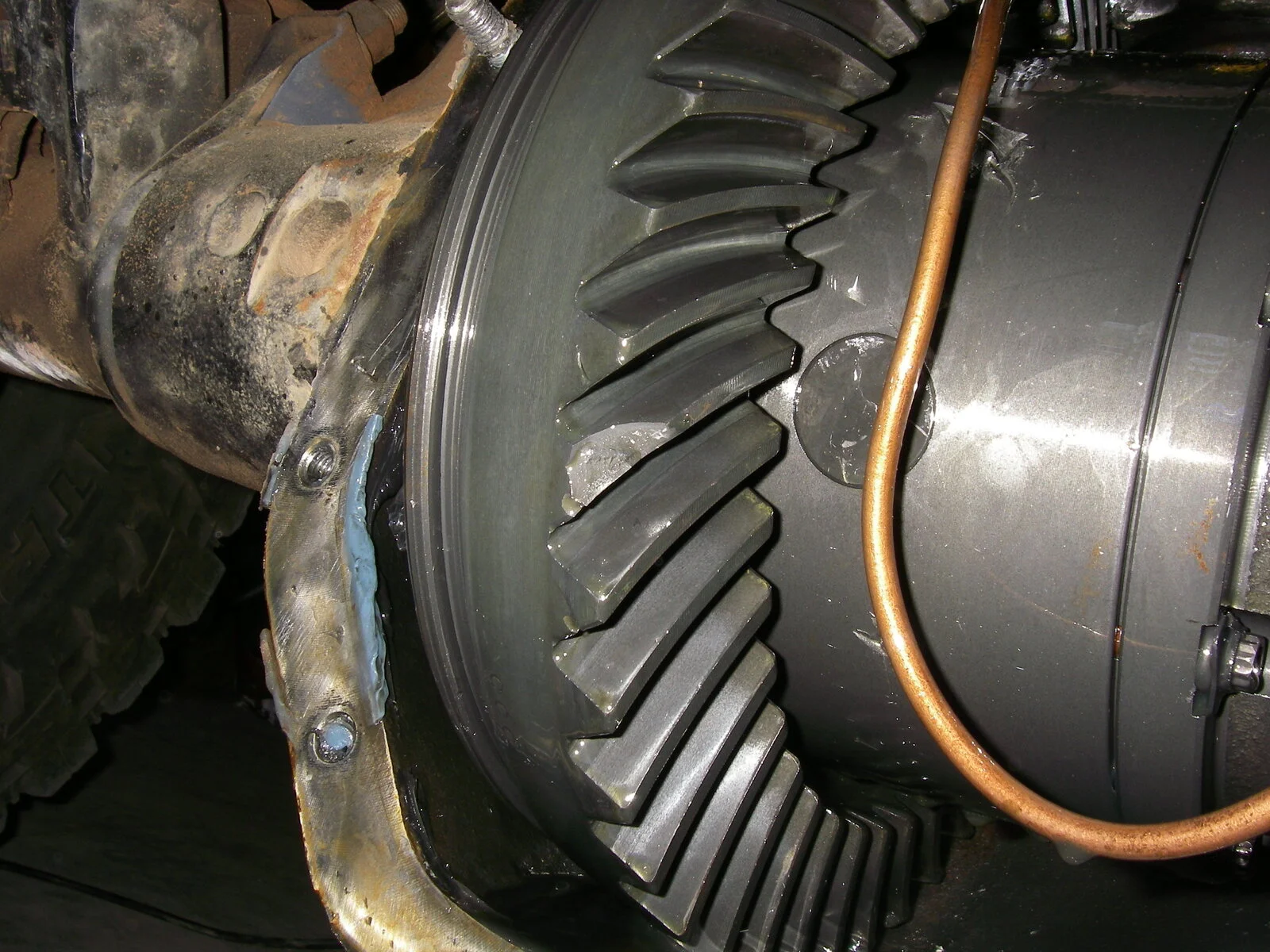

The Dana 60 is hardly unbreakable. I know people seem to think it is, but they fail too if you beat on them.

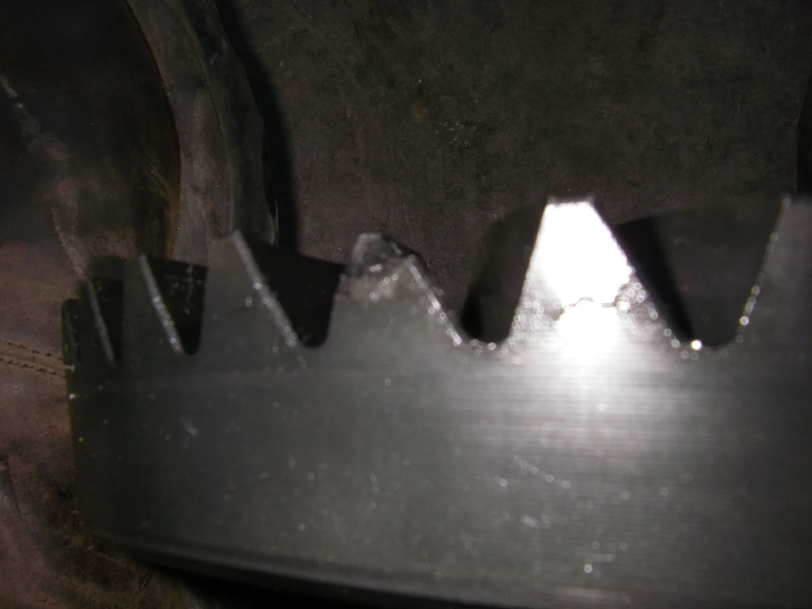

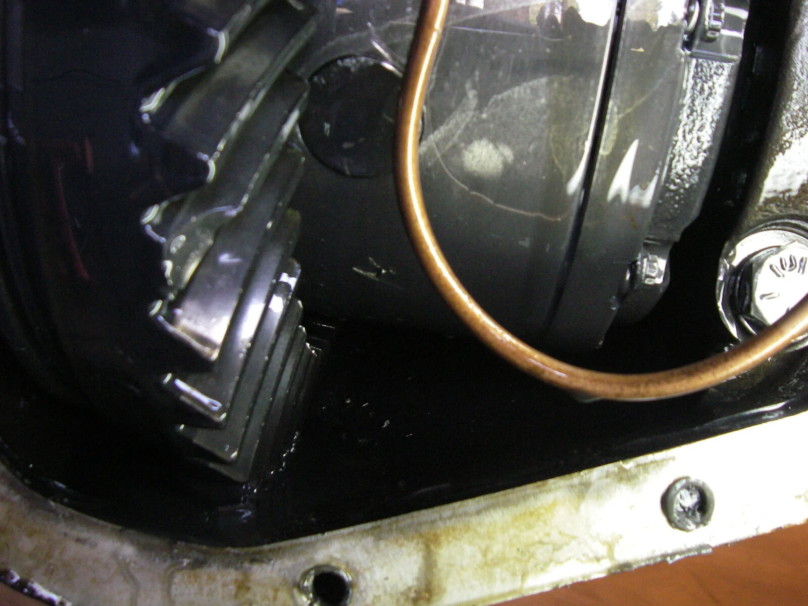

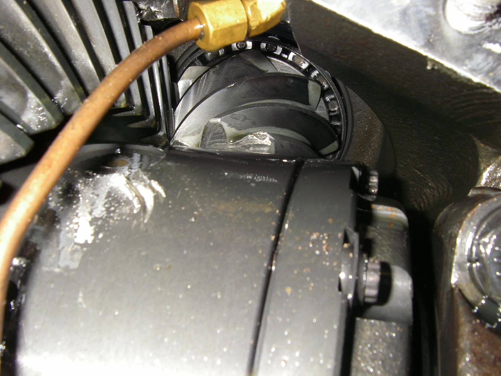

Yep I'm proof of that. I've managed to break 3 R&P sets in my rear HP60.

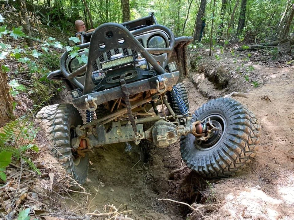

I don't fully agree with that. Just like Boom has said dragging your driveshaft thru the rocks can cause problems so running a HP axle can be helpful. You can run into fitment issues with a HP housing not clearing motor mounts or engine components. And this is where you end up having to move the axle around sometimes.
And as had already been pointed out running a rear HP axle can help with driveline angles on a SWB rig and a long travel suspension.

I’ve heard that’s an issue with the HP60 rears.

But this goes back to what you're build towards. If I'm trying to build a bulletproof rig then I'd want to move my driveshafts up out of the rocks if possible.
But we all have different priorities. I've seen enough ground down u-joints and straps and yokes that I consider it a reason to run a HP axle. And why would there be diff guards & yoke guards and such if it wasn't a problem?
