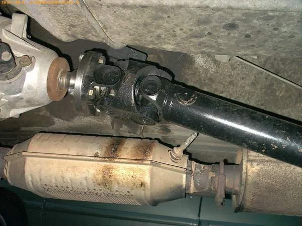

Does your output shaft/SYE look like this?
Yes, I believe it’s called a hack and tap. And yes, mine looks the same as the photoed one!
See attached. Thx for help, I m hopeful the plate is “softer” material than the splined output shaft!!
Trying attachment again …. 🤪 If it doesn’t come through it looks the same as your photo.
