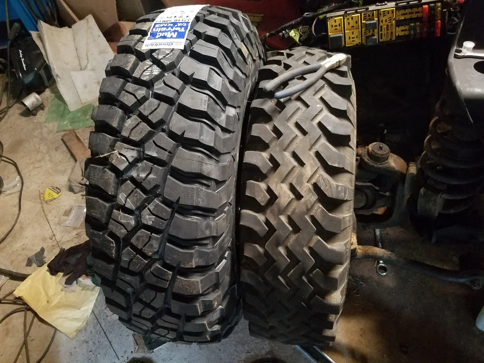

Oh for the KM3s, in the mud my previous tires were better for those specific instances only. It's been a complete mud fest lately and doing steep muddy terrain with a utility trailer sucks. I'm not knocking the the KM3s, but doing slow climbs, I notice that I'm spinning a bit more. If I get some momentum for short stretches, it's not too bad, but it tears up the roads. This is really where automatics and longer wheelbases tend to do better.

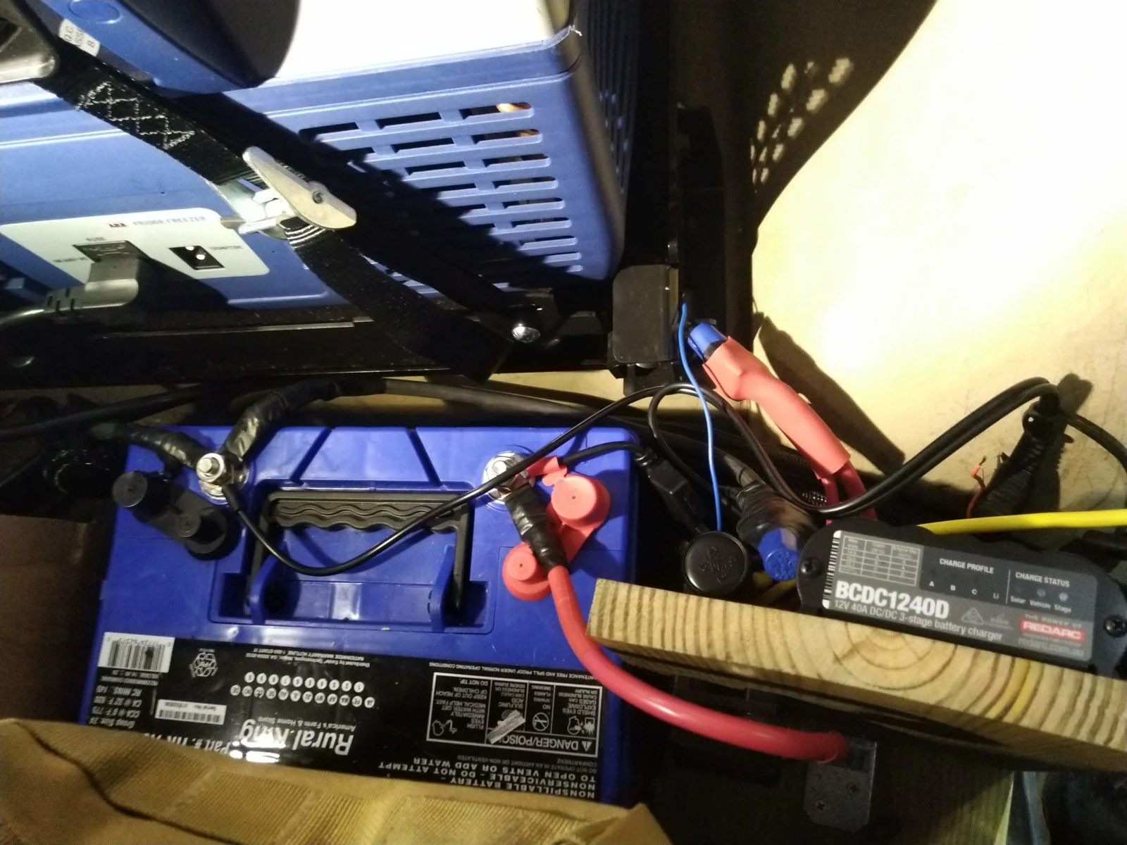

I added a tablet mount as well. And now I'm in the process of adding an Auxiliary battery because I added the big ARB fridge freezer 78L with slider. I installed one of those really cheap Chinese tailgate tables too and though I haven't been able to use either much, its been fun to install.
The battery I used was a cheap marine AGM group 24 battery I got from rural king and it fits nicely behind the driver's seat. I have a Redarc BCDC1240D charge controller for the battery, which I was going to put in my truck, but I don't have the smaller model yet, so it's going in anyway. I have no idea what I'm going to do for a box though for all of that stuff yet, but I'll likely just wing it this weekend to play with the setup.

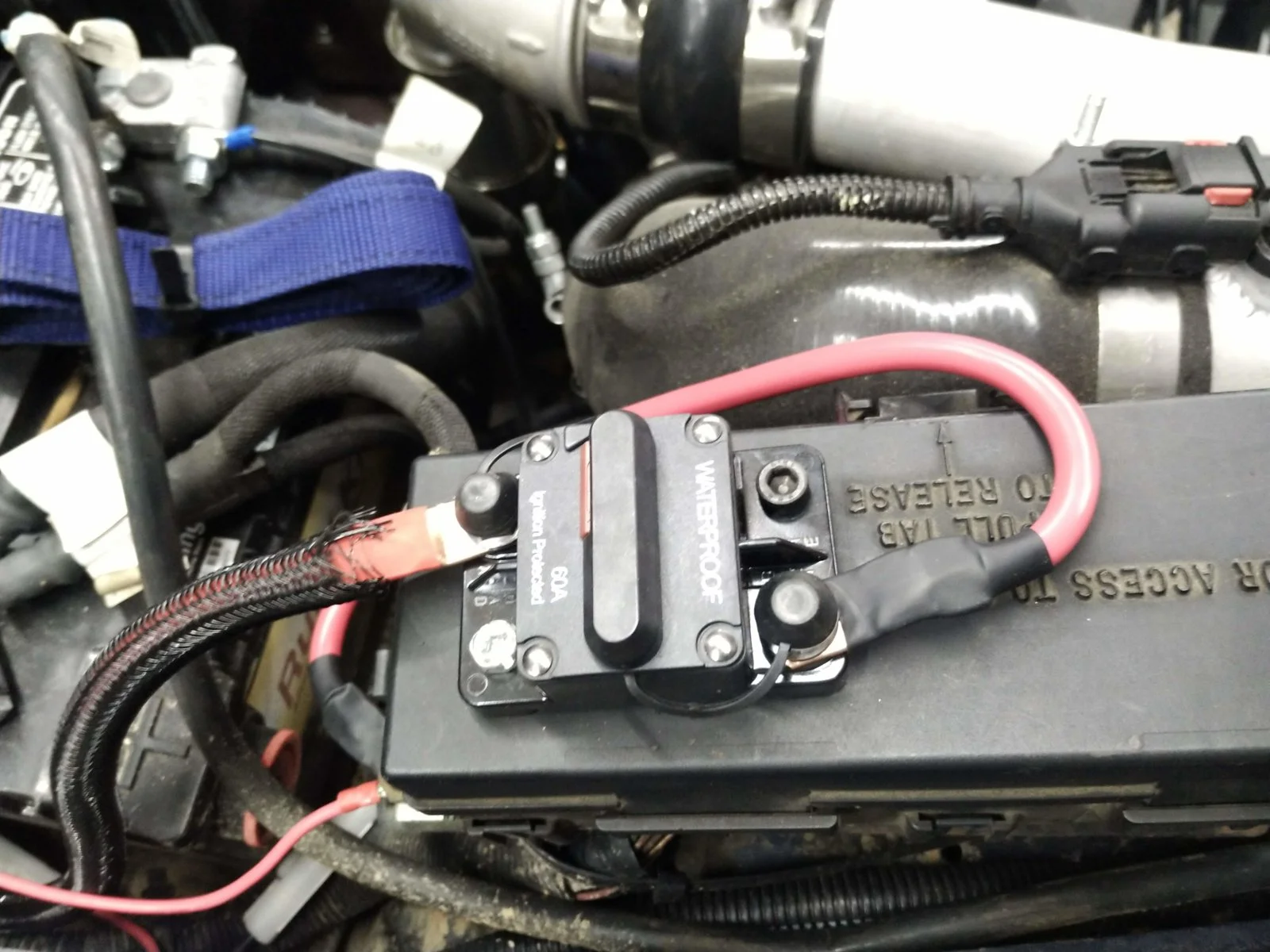

Temporarily installed the Aux Battery, with a 12V outlet and RedArc BCDC1240D charge controller. I didn't have the right fuses, but had breakers, so that's what's there at the moment. I had to route the wires a bit better (like the ground wire right on top of the positive battery post.
Btw I hated the terminals that I found locally. They were expensive and didn't fit well, so much of this will be completely redone. I didn't have the right size anderson powerpole connectors so I just used massive wire nuts in the meantime with electrical tape and heat shrink. I want to figure out a box to put all of this stuff and I want to integrate an inverter and this will likely be in a separate box with a 12v outlet and USB connectors. There's a special ARB 12v plug that I need to install, but I'm not sure where at the moment. Basically I want to use this setup for sometime until I realize what I really want.
There's a yellow wire there that is currently unhooked, but it will be hooked up to a MC4 connector and it will be used for temporary and permanent Solar connections. My plan is to run 100W on the top of the Jeep and then 2 to 4 50-100 Watt flexible or folding panels with 25 or 50 ft extensions so I can park in the shade, but still top off my battery.
