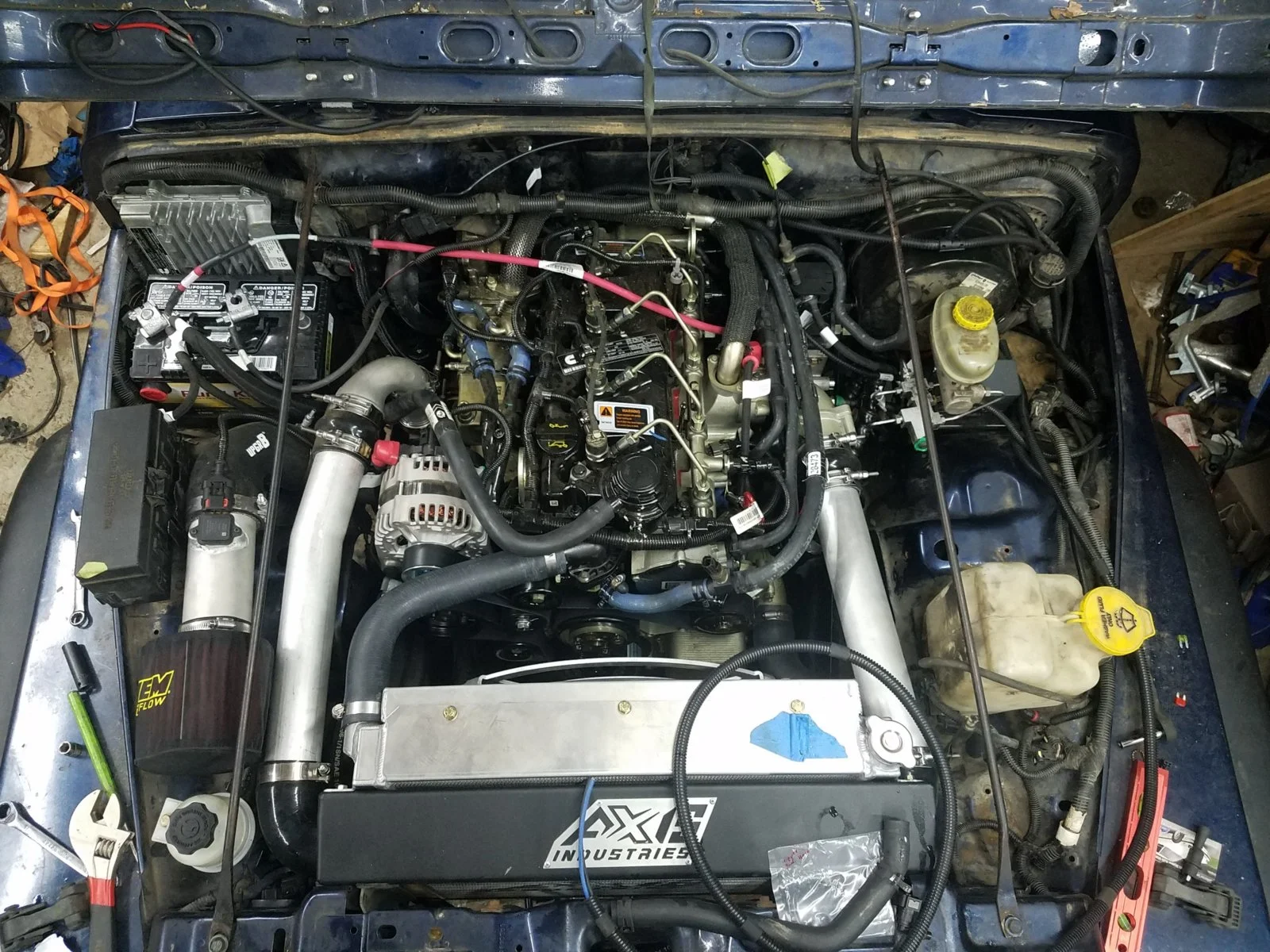

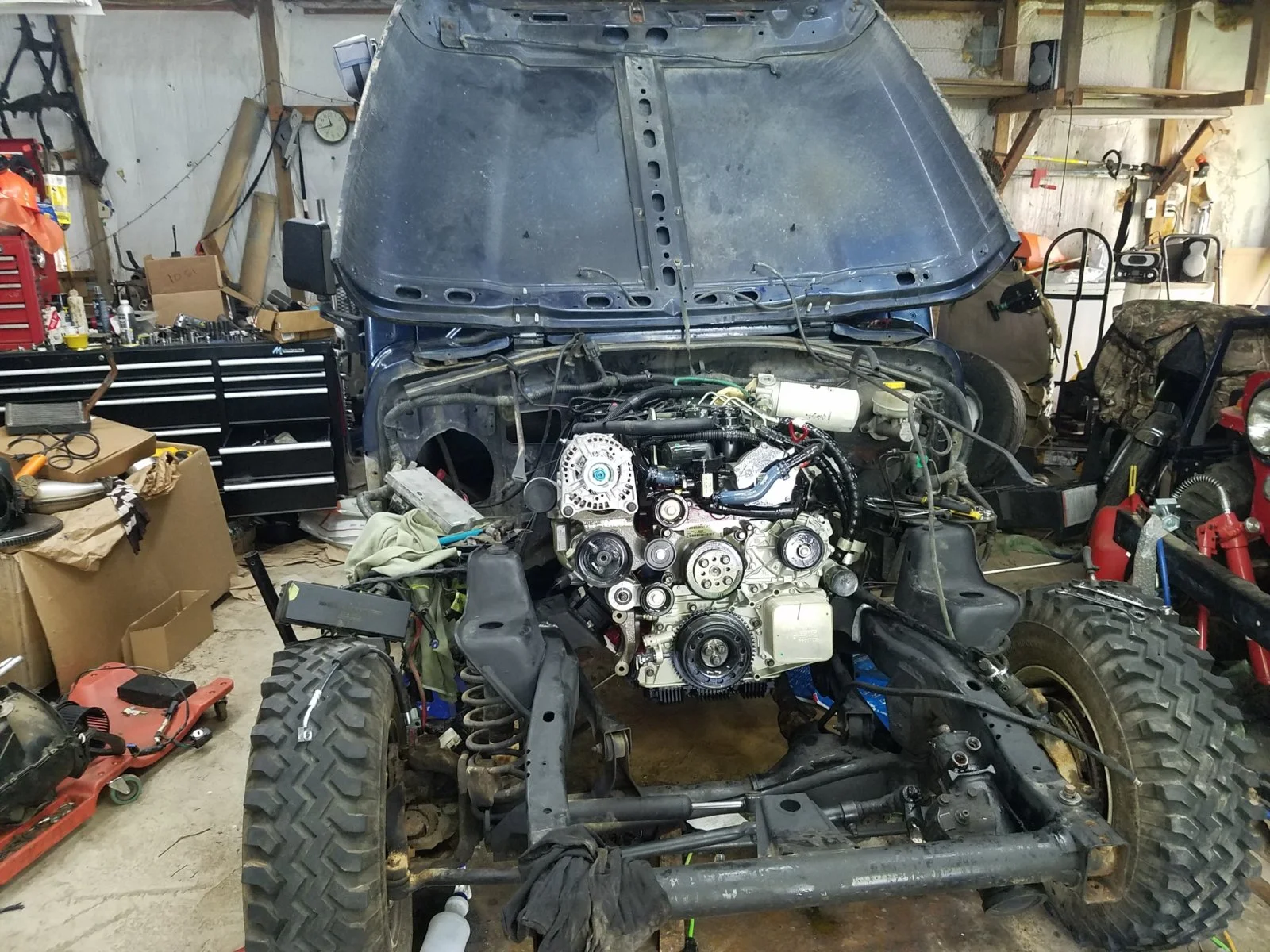

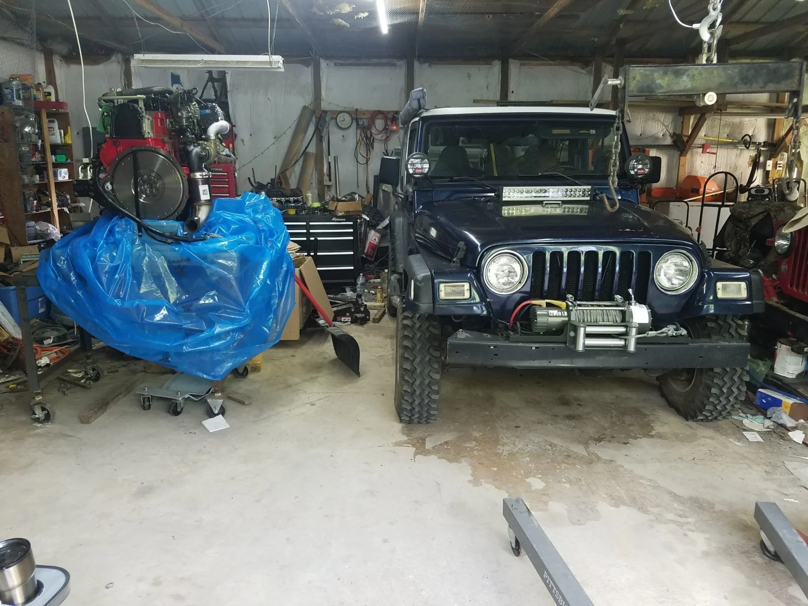

I started with my 1997 Jeep Wrangler Sport with 4.0L engine, AX-15, NP 231, Dana 30/35 3.07 gears. It's not completely finished, but it's very driveable.
I installed:
-R2.8 Cummins
-Axis Industries Conversion Kit (Adapter, CAC, Radiator, wiring, power steering hoses, etc.)
-1" Body lift
-Stainless brake lines from Classic Tubes
-GenRight extended range tank with skid plate
-Dakota Digital VFD3 with GPS module and DSL-1E, diesel Tach adapter
-Luk HD clutch for the AX-15
-New fluids all around
-15X8 5X4.5/ 4.5BS - Part # PCW51-5866
-4x 33x 10.5 BF Goodrich KM 3s
-Corbeau Sport Reclining Seats
-Rear track bar bushing
-New transmission mount
-Probably more that I'll update as I remember
Here's a few pics not in the correct order. I'll try to explain everything but here's just a basic overview of the basic build. I have a bunch of video on the first part, but toward the end when I was routing it was really like watching grass grow or worse.
