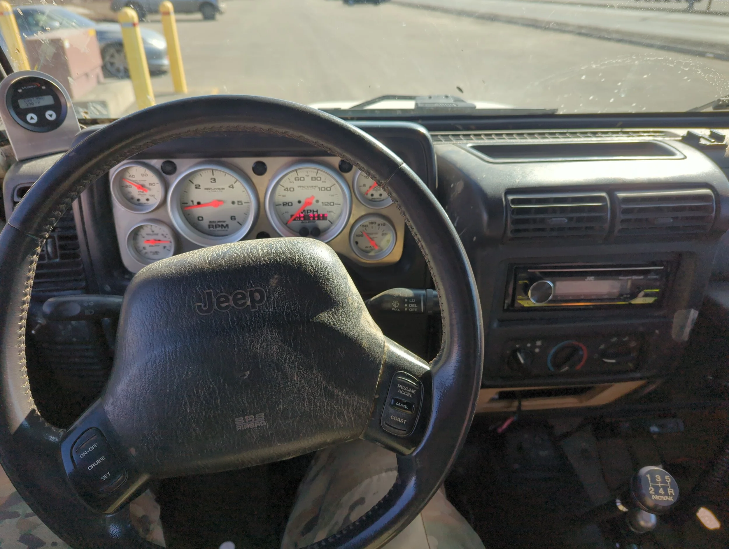

i mounted the Murphy gauge down by the shifter, makes it a lot less usable the. where you’ve got yours.
So I mounted my ox locker shifter next to the shifter. Plus I really like the Murphy gauge! Fun to check engine load, plus it's my main coolant gauge until I figure out my issue with the other one.

So my auto meter gauge shows roughly 100* when the Murphy shows 175*
I'm thinking it's the sender since I ran a smaller one that didn't come with the gauge.

I love that cluster! Way better than the OEM look

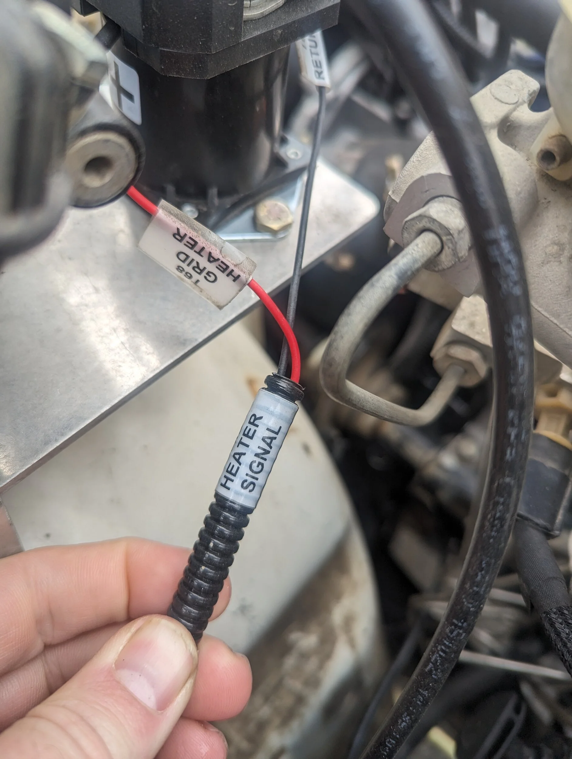

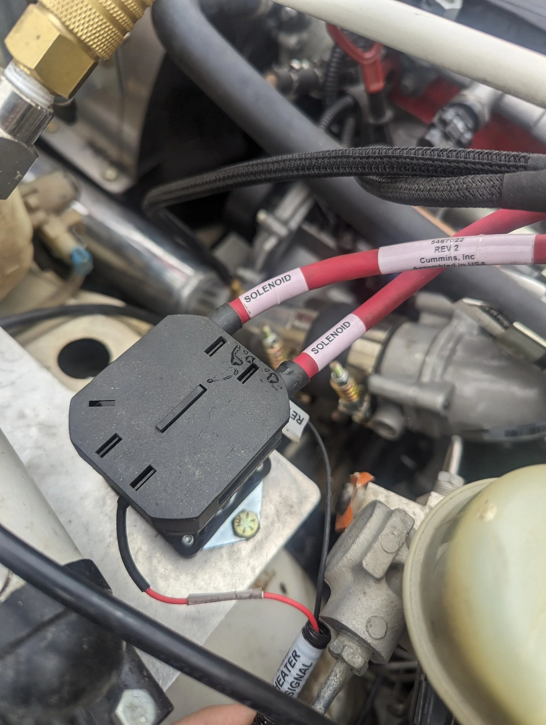

when you get a chance post a picture of that. never worked for me and the drawling was lacking on how it was installed .
Just walked out to the jeep and snapped a few pics. So my harness was labeled with signal wires to a solenoid. Then one wire to grid heater and the other to the battery.
