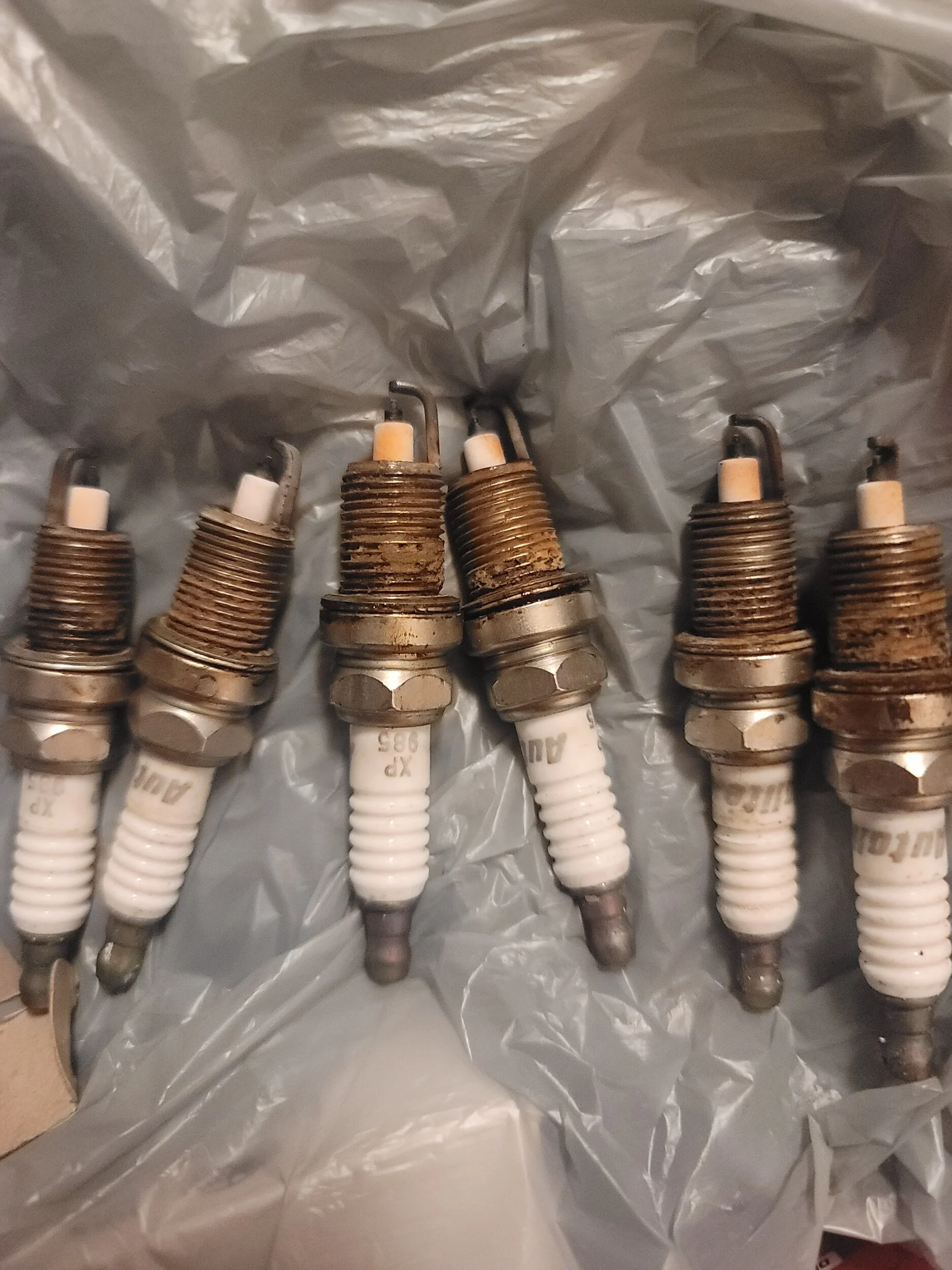

P.S. Post pictures of the old spark plugs...what did they look like and did you note which one was in which cylinder?
P.P.S. Have you put a screwdriver to each injector and verified all of them are clicking?
Well, crap, I didn't mark them. I didn't see oil or anything on them, but here's a picture.

Some look darker than the others...or that's just shadows...wondering if we could equate the tanlooking ones to cylinders and that black one to the one not firing at the right time.
-Mac
It's hard to tell, but they're all the same pinkish color, barely any discrepancies between them. Just bad lighting inside.

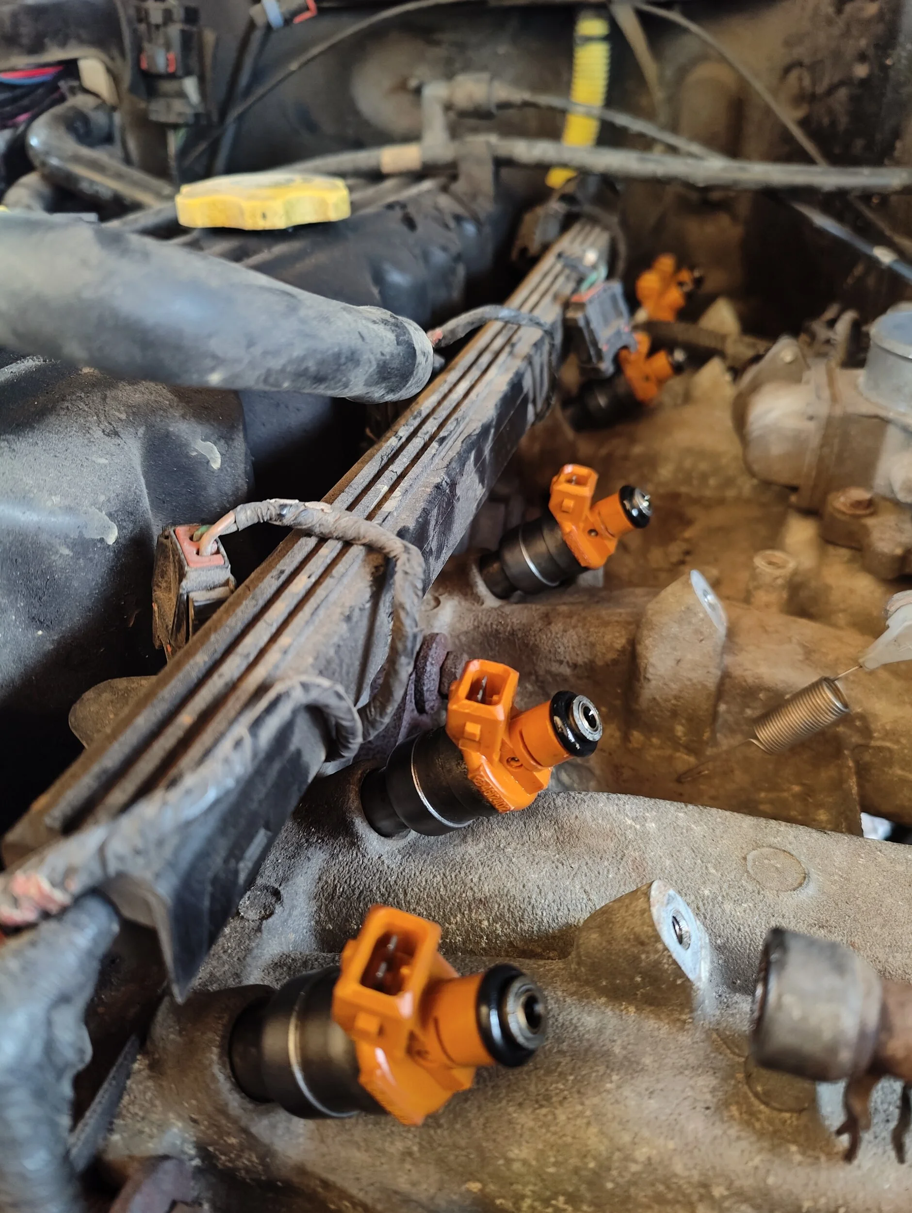

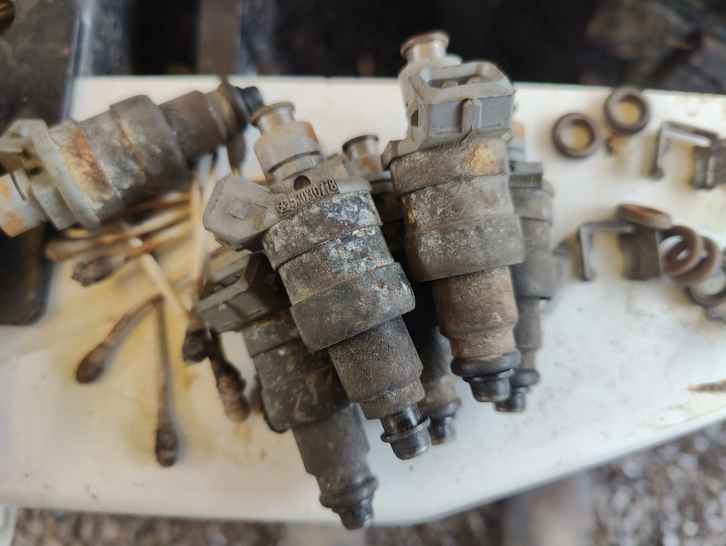

I don't know if the injectors were replaced, I just know the wiring harnesses are. I'll look at the injectors and look for a stamp.
Here's some pictures of the set I received from Precision Auto Injector and my old injectors...
