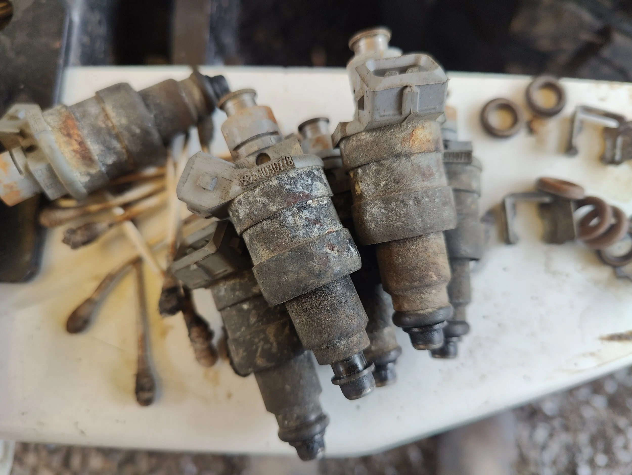

Screwdriver to the injector and one end to your ear and listen for clicking.
My old ones looked like shit but my guess is they weren't bad at all.
-Mac
So check for the clicking. I think my buddy felt them with his fingers, but I can check again.
