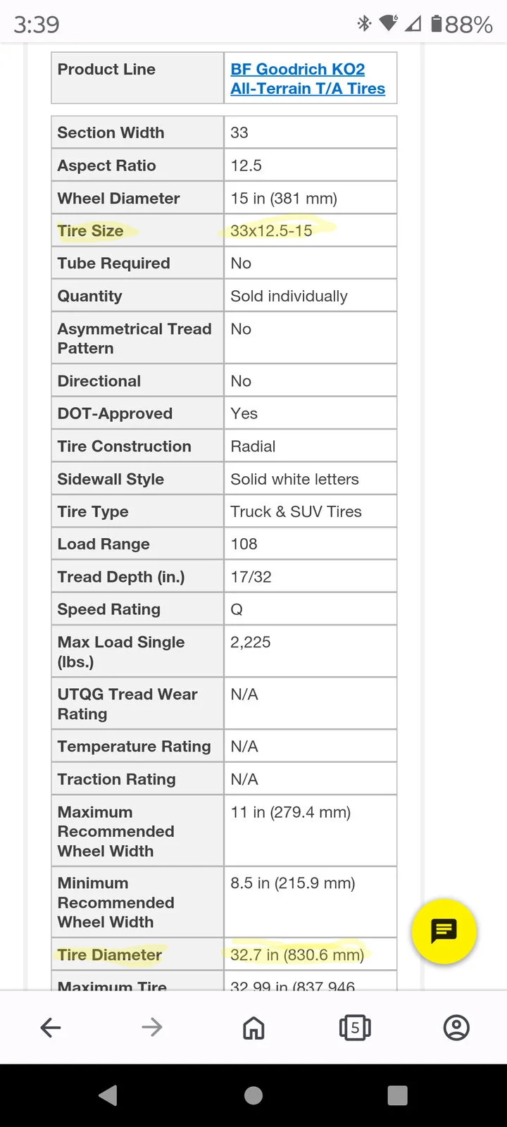

If you were to go drive with a 33" BFG KO2 and did the rpm vs speed calculations, 32.7" will not be correct.
I would like for you to back calculate the advertised revs per mile (640) and tell me what you get. It will not be 32.7" and clearly both specs can't be right if they're different, right?
BTW, Blaine does not agree that the hub height x2 gives erroneous information and I have never known any method Blaine uses to be erroneous.

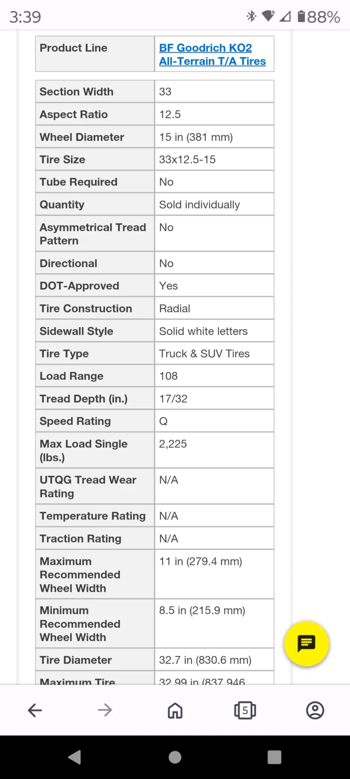

Look again... even BFG, its manufacturer, says its actual diameter is 32.7" at the bottom of the screen shot.
Hub height x2 is different than whatever rpms per mile the tire manufacturer came up with. Hub height x2 will be more specific to the vehicle because it accounts for variances in tire pressure and vehicle weight. The tire manufacturer does not know these things.

I don't really care, I go by what the tire's manufacturer says. They certainly know the precise diameter of the tire they manufactured.
Jerry, you are not paying attention. I know what BFG lists the advertised diameter as. It is not correct.
BFG lists that exact tire as 640 revs per mile. 5280/640 = 8.25 feet per Revolution. 8.25 X 12 = 99” per rev.
99/3.14159 = 31.51”. THAT is the correct diameter for a new and not heavily worn 33” BFG. Not 32.7”.

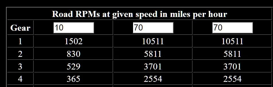

With the RPMs from the Torque app and ground speed from GPS what would be the reason? The difference @ 70 between hub distance and 1 rotation calculations is about 30 rpms.
With the RPMs from the Torque app and ground speed from GPS what would be the reason? The difference @ 70 between hub distance and 1 rotation calculations is about 50 rpms.

Measuring from the ground to the center with the tires on the ground at normal inflation gives an erroneous diameter. Especially since the hub height would vary with tire pressure which of course does not affect the tire's true diameter. Go to the tire manufacturers website to get its true accurate diameter which won't vary by air pressure which does not affect its circumference. Its circumference is what dictates the tire's rpm while driving.
This is the BFG 33x12.50 tire whose actual diameter is 32.7"
Next time you drive on the road/hwy, note the rpms and speed very carefully and jot them down at various speeds.
Then go play with Grimm jeeper calculator and plug in different tire sizes to see what matches what you see on your jeep and report back :)
You will see that what @jjvw said (2x hub height) is pretty darned close. If you don't believe us, ask Blaine who will confirm that you are incorrect.
I'm suggesting that your measurement of a single tire rotation is inaccurate.
Doing it 6 times carefully and having them within 1/8 isn't terribly inaccurate. Pretty easy to see when a mark on the side of a lug is touching the road. Not worth debating over 30 rpms.
