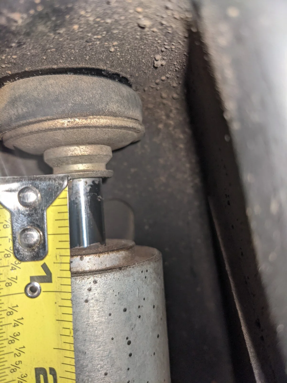

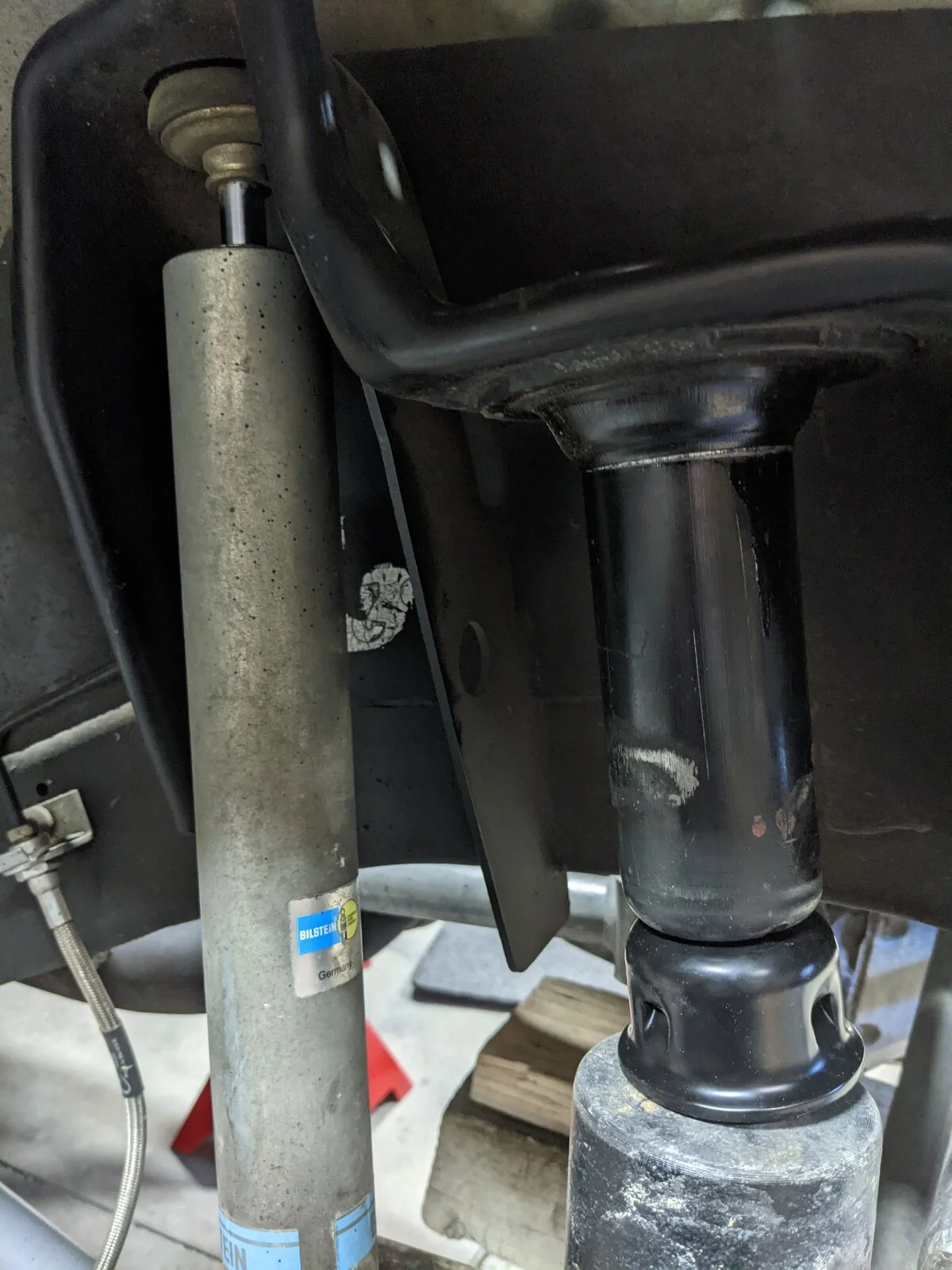

Am I getting somewhere?
No springs, trackbar loosely connected, no wheels. Looked the same with wheels. Just touching cup with lower bump, 3/4" shock shaft but it's 1/2" at full compression.
My untrained eye says these shocks are correct length after removing ACOS that was adding 2".
Shocks 14.25" compressed
24.25 extended.
15.25" as pictured. Top of barpin to bottom of upper stop.
