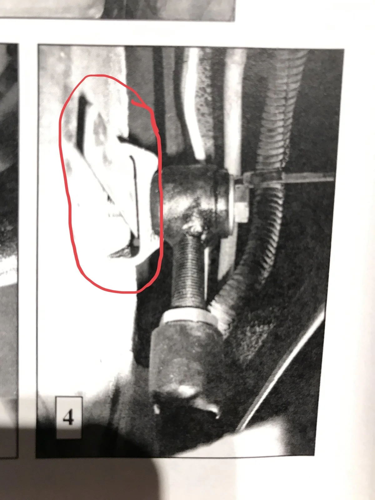

Here’s a pic with the part circled.
Question for you Jerry, I need to know a part number or the size of the factory nut/anti rotation tab. It’s in the attached pic.
Mopar 6503648
NUT AND RETAINER, Hex Flange Lock,
m8x1.25
It is known as a flag nut. You can also just buy an M8x12.5 nut and insert it with an open-end wrench.
