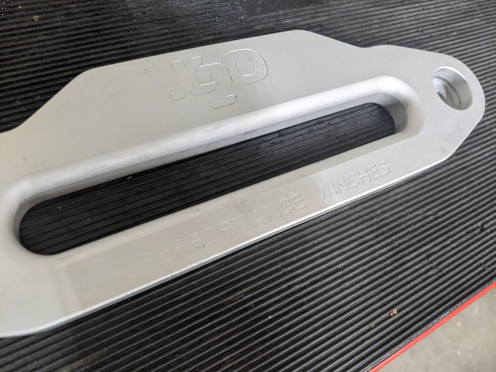

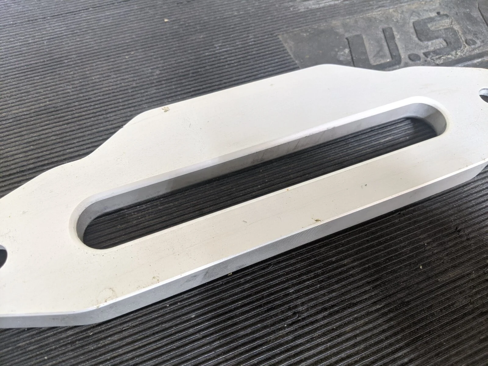

@Mr. Bills - Thanks for this. I took a look at my Shittybuilt bumper yesterday, and I definitely do not have the minimum 3/8 clearance on top and bottom for the fairlead, so I will be doing a little trimming this morning. Is the radius on the TRE the same on both sides? Looking at mine, there is definitely a difference on the front and back. Thinking maybe a different fairlead along with when I get their snatchblock.

The entry radius on that fairlead is too sharp. This is where most the import and cheap Hawse style fairleads miss.

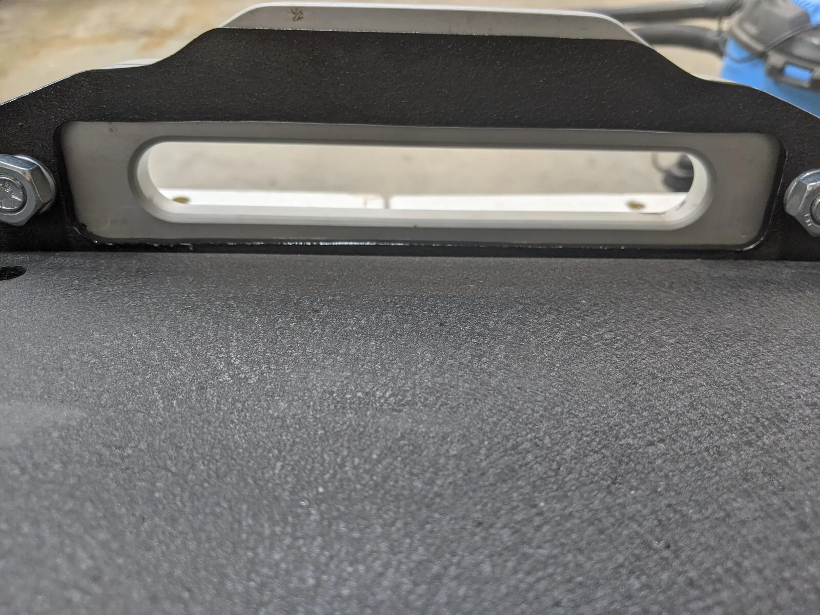

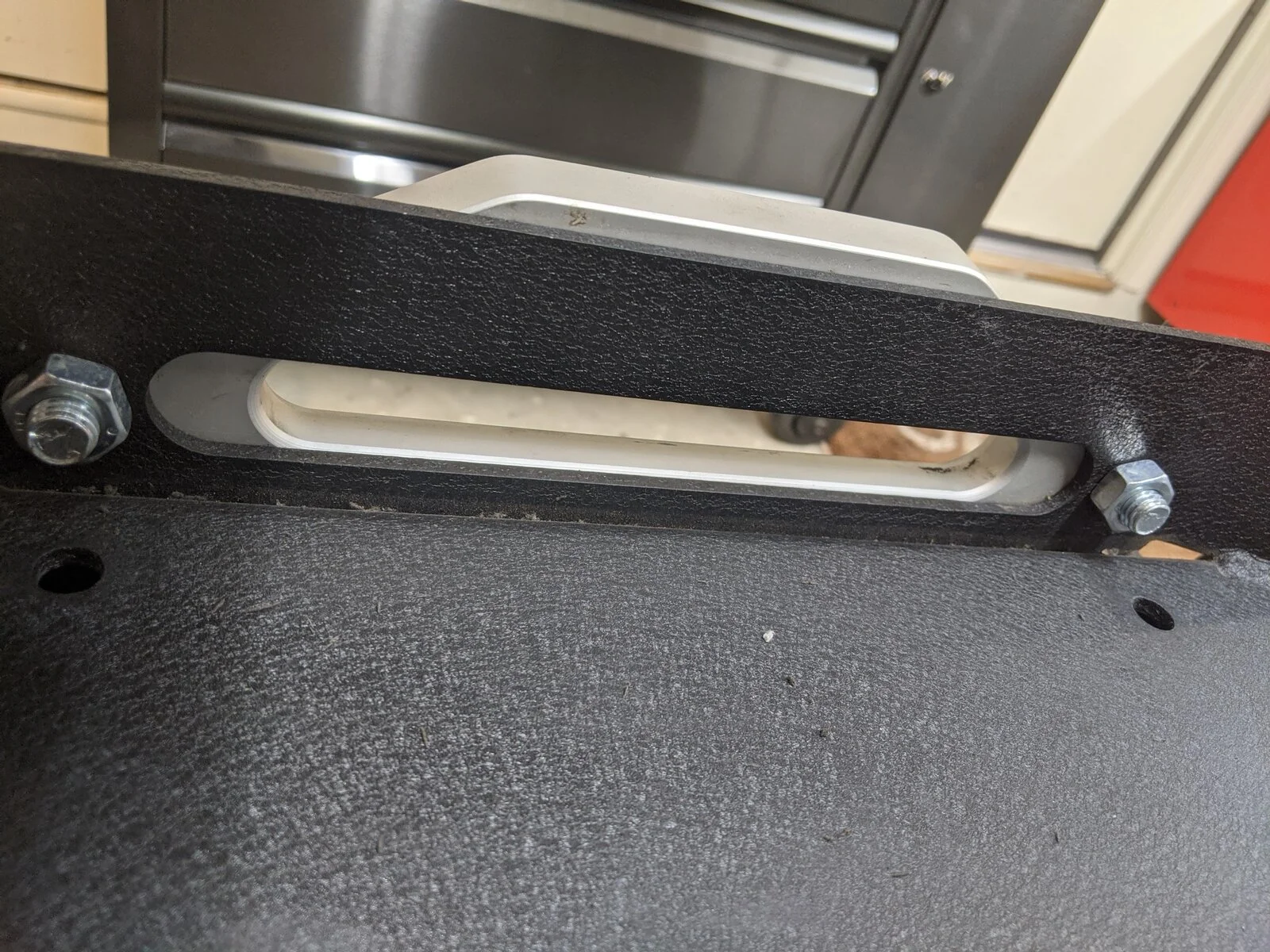

Shittybuilt missed on the bumper mount too
Fixed it- bumper not fair-lead

Good catch, and good you fixed it. I wrote articles on many of the topics in this thread. This being one of the most important and I feel overlooked. It's always unfortunate to have a customer call me who just installed a new rope only for it to break on the first use. It's this 100% of the time.
