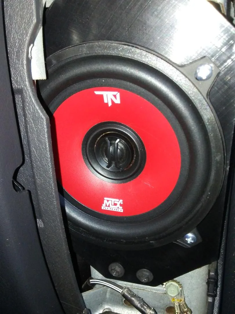

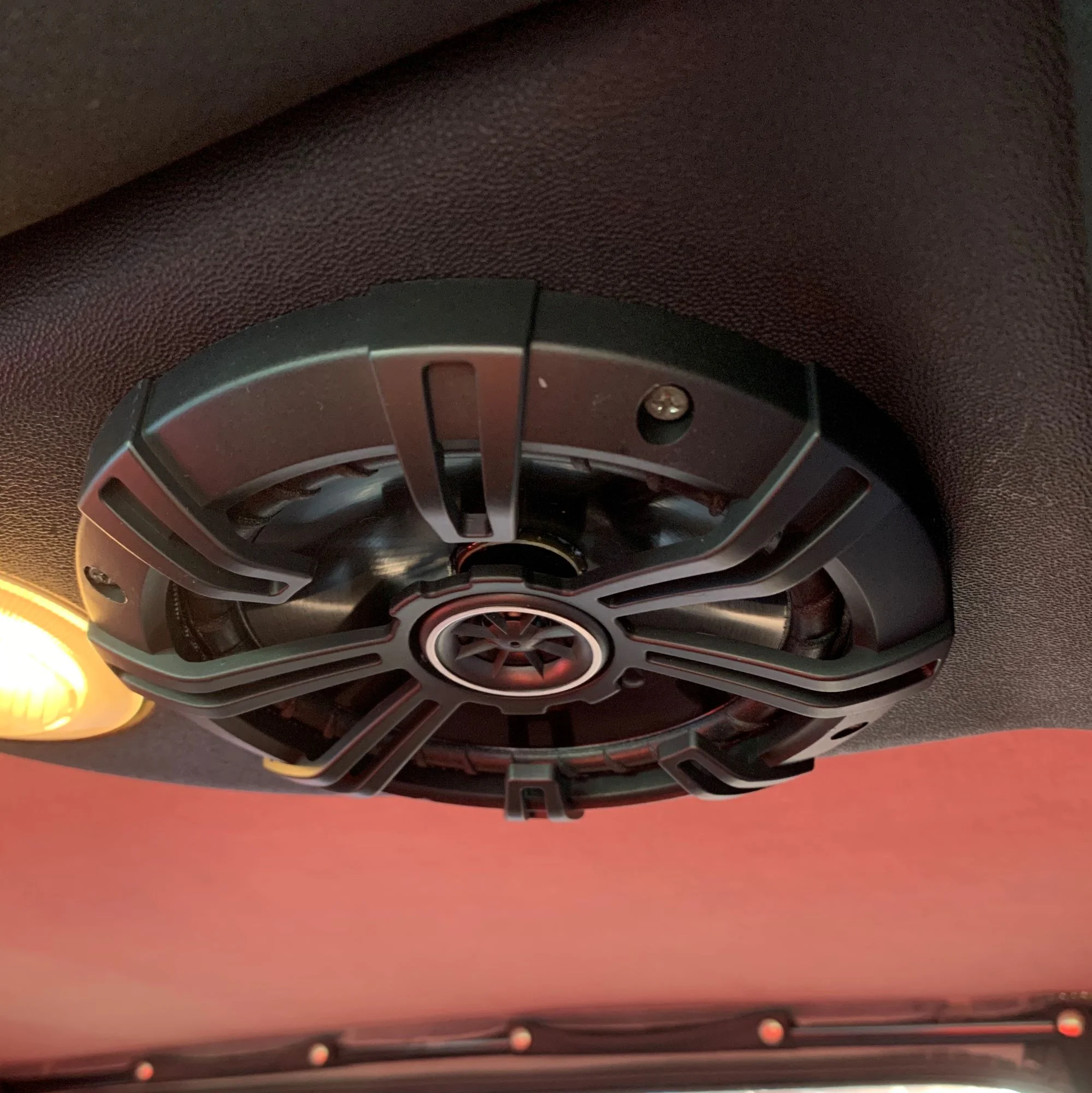

I am in the process of redoing the audio in my 2000. I am probably over what would be considered a budget install. I also reached out to some knowledgeable people on here for advice. I added new 5 1/4 speakers in the dash and soundbar. You can go bigger in the soundbar (6.5 maybe?) but I decided to spend the extra money for a better quality 5 1/4 than lower quality larger speakers.
To swap the front speakers to 5 1/4 you need an adapter, they are cheap on Amazon or eBay. I actually have a spare set I can send you if you want to pay shipping, but new it was only $12 with free shipping on eBay so I don’t think I would really be saving you much money.

For speakers I went with Blam, a lot of people here rave about the polks and they are priced right. If you search for Polk in the forum search you will find the specifics.

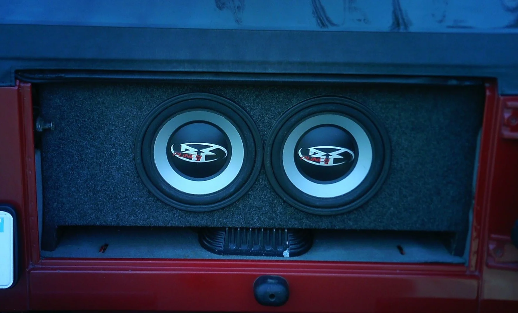

I don’t have a sub yet, the plan is a powered sub with built in amp that will get bolted inside the back seat frame. Once again out of sight. But honestly it already sounds so much better that I am not in a rush and have other priorities for Jeep funds at the moment.
