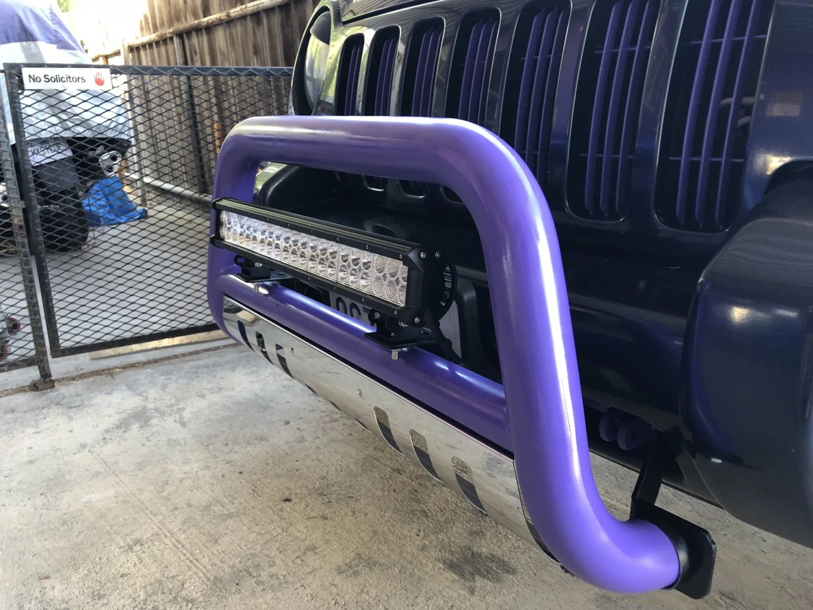

Here is the bull bar I am going to try to put on. I know it is not made for actually doing anything, but I liked the looks of it. Just don't know if I will like it on the TJ. Looked great on the Liberty. LOL
Do you still have the light bar that is in the picture attached to your Bull bar? That would be nice on your TJ.
Yes, I still have it and plan on using it on the TJ. Just waiting for the bull bar first. It will either attach it again, or if the bull bar doesn't look good, I will attach it to the bumper itself. :D
I'm not sure how that bar mounted to the Libby bumper, but if it just bolted on, it could work...I suppose you would paint it black...?

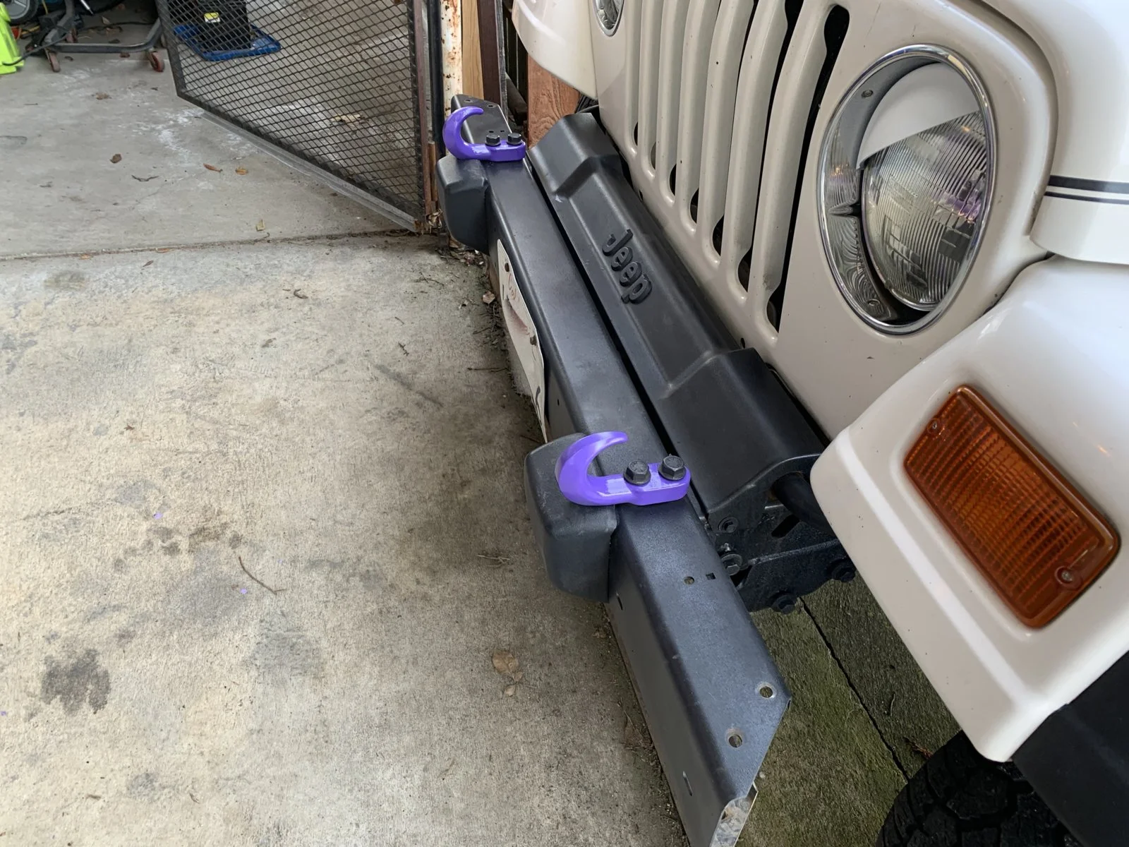

LOL, Umm, no. It stays purple. :D Purple is my favorite color and my Jeep will be white and black with purple accents. :D Just got done painting my hooks purple and waiting for them to dry so I can install them. You guy's realize I am a girl and like doing foo foo things to my cars? LOL :D

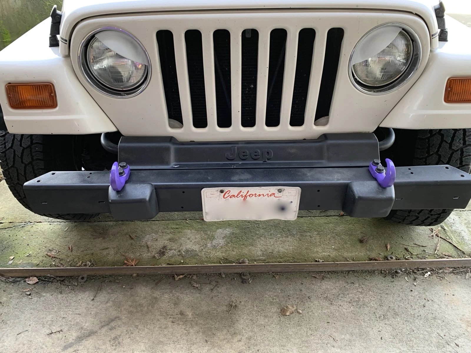

Ok, got Grade 8 bolts but had to get them with hex head as Ace didn't have the torx head, but that was fine by me. I kinda like the hex head better. :D
Here's a pic. I just let them squish the bumper guard down a bit. Also, angry eyes will be removed once my headlight guards get here. :D
