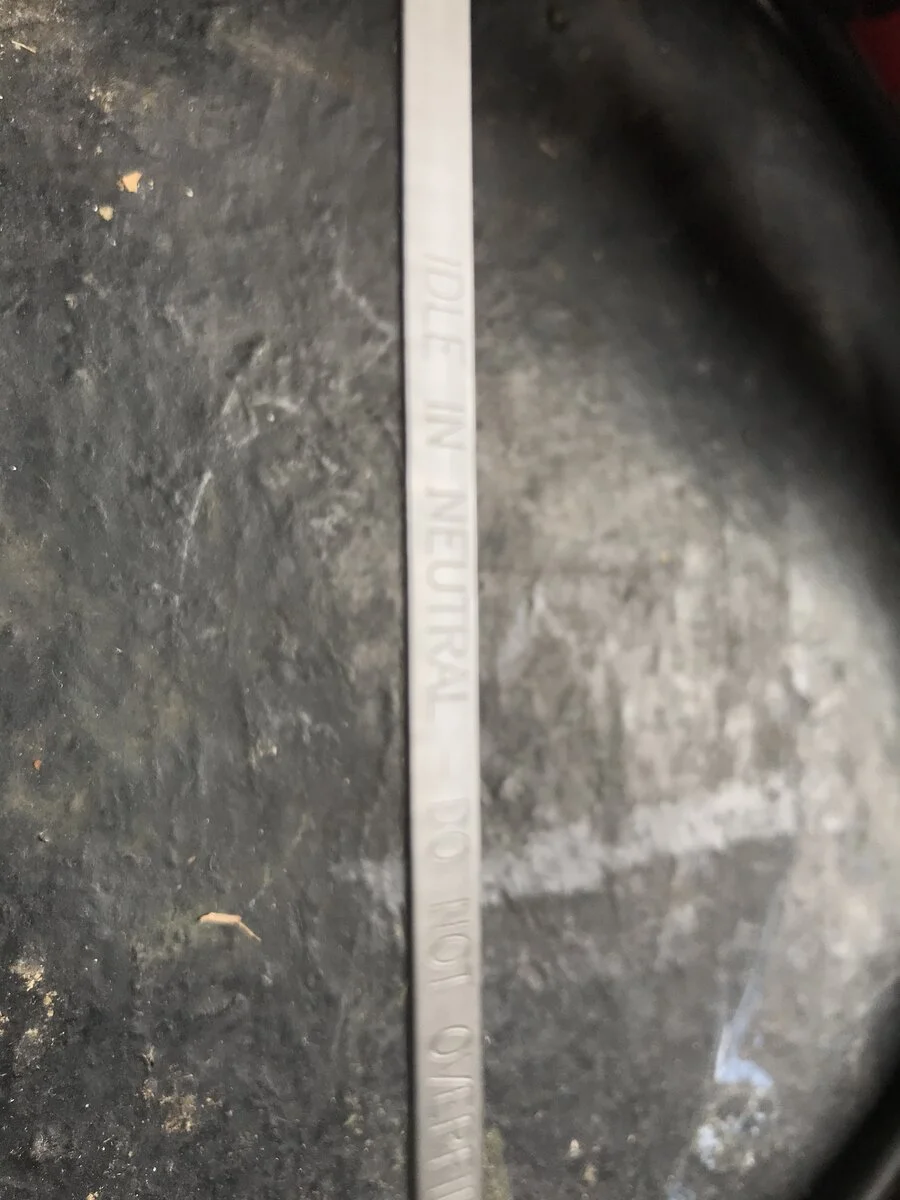

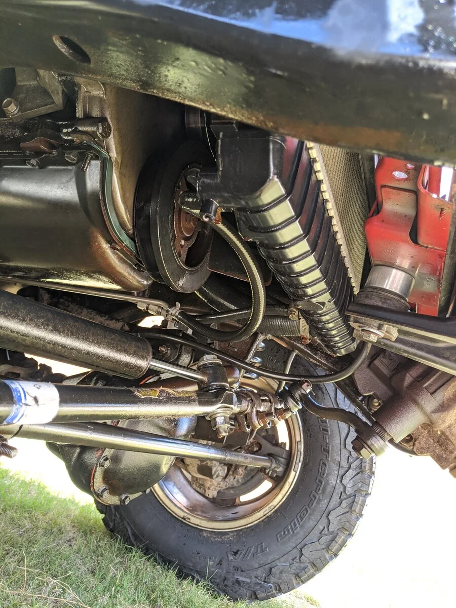

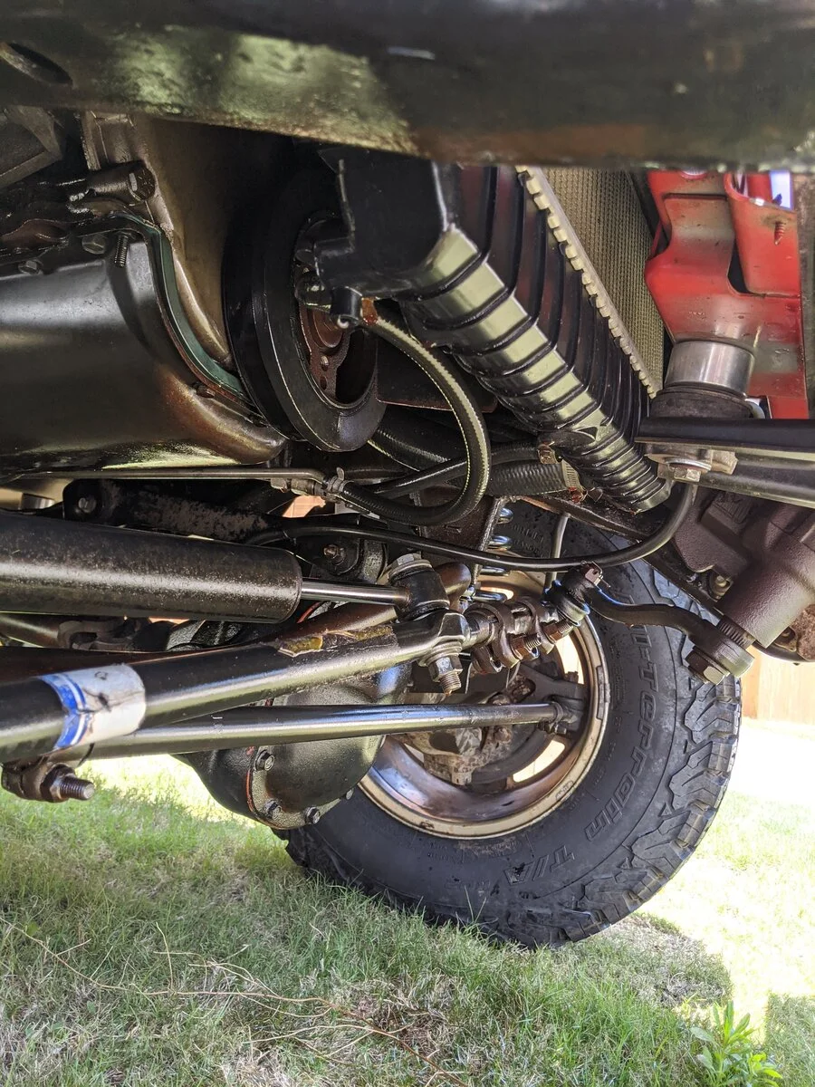

It's all oily now, definitely need a belt. Been working all day, will get pics asapI wouldn't just fill whatever is low unless you want to either spray the new fluid out the same as earlier or just drain it out and waste it.
You obviously have a major leak. And it is obviously near the radiator. And it obviously is transmission fluid. And you obviously had a shift problem. So to just add fluid makes no sense to me.
It appears to be the trans cooler lines at or near the radiator or trans cooler. That big of a leak should be easy to find once you get everything cleaned up.
Be sure to replace the acc drive belt if it got coated in oil too.
