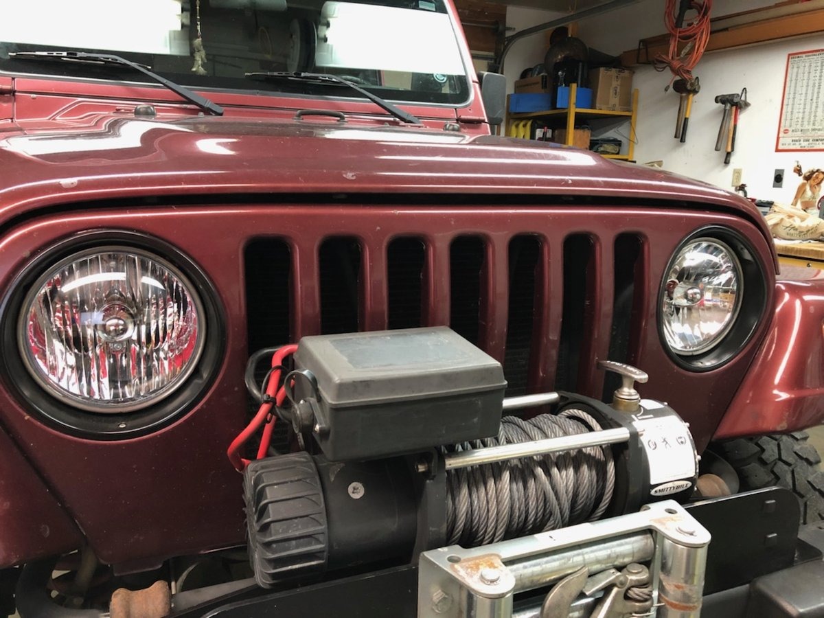

Original sealed beam on the left, JK housing on the right.
And below is with both JK housings in.
Those look good too. Nice bezels also

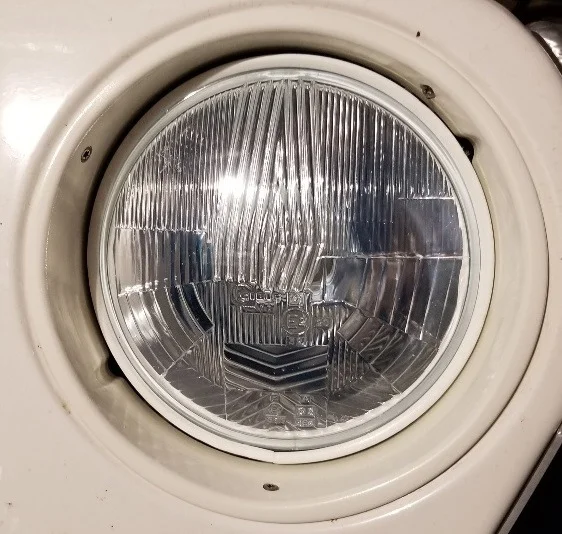

This is the e-code Cibié H-4 glass housing. The bluish effect is from Osram Night Breaker bulbs.
Reactions: JMT and alittleoff
The E-code housings disperse the light in such a way that it produces a nice cutoff point and illuminates the fog line and road signs well. The Extreme Vision bulbs produce a higher color temperature, but not so much as LED bulbs do, so they work well in snow and are easier on your eyes. The wiring harness upgrade is not needed, but if you decide to up the bulb wattage, then I would recommend it. I'll let you know if the harness upgrade is useful, as I ordered it last week.

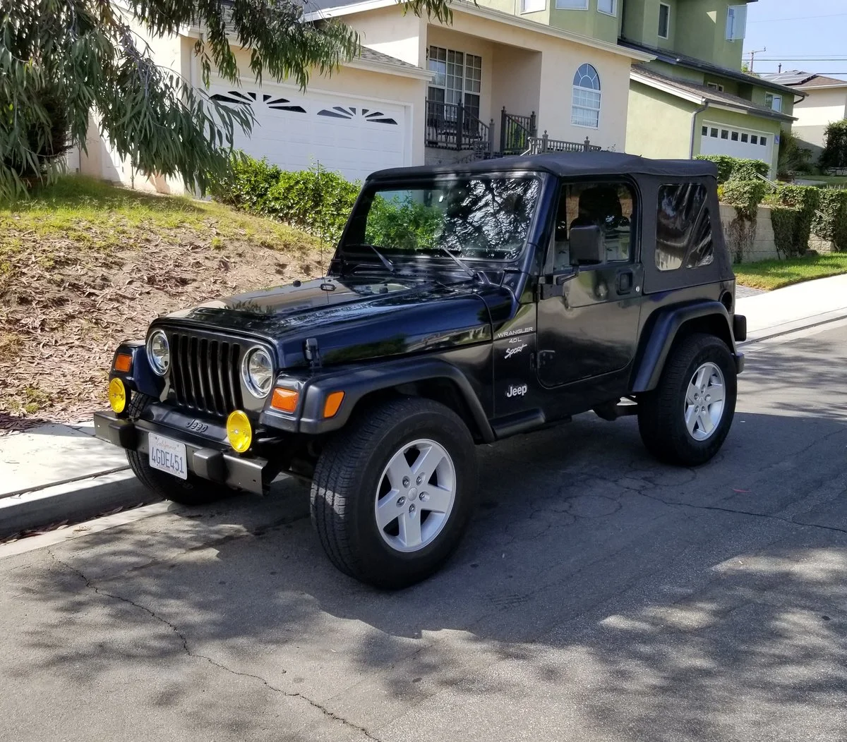

These are the Truck Lite knock offs on my TJ.

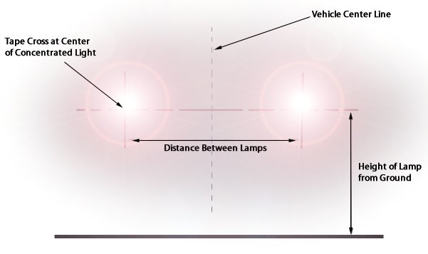

Proper headlight adjustment goes a long way. Understanding color temperature will help with your decision.
Had worked as a pressman (ran a printing press) for a decade or two 🤓so color temp is easy for me. Why folks run headlights out of adjustment is a mystery to me🤯. They see less and so does everyone else.
