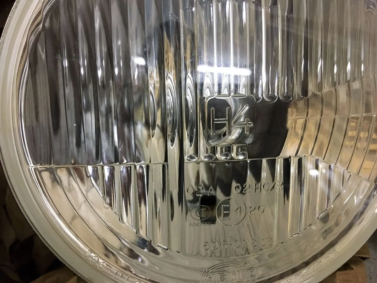

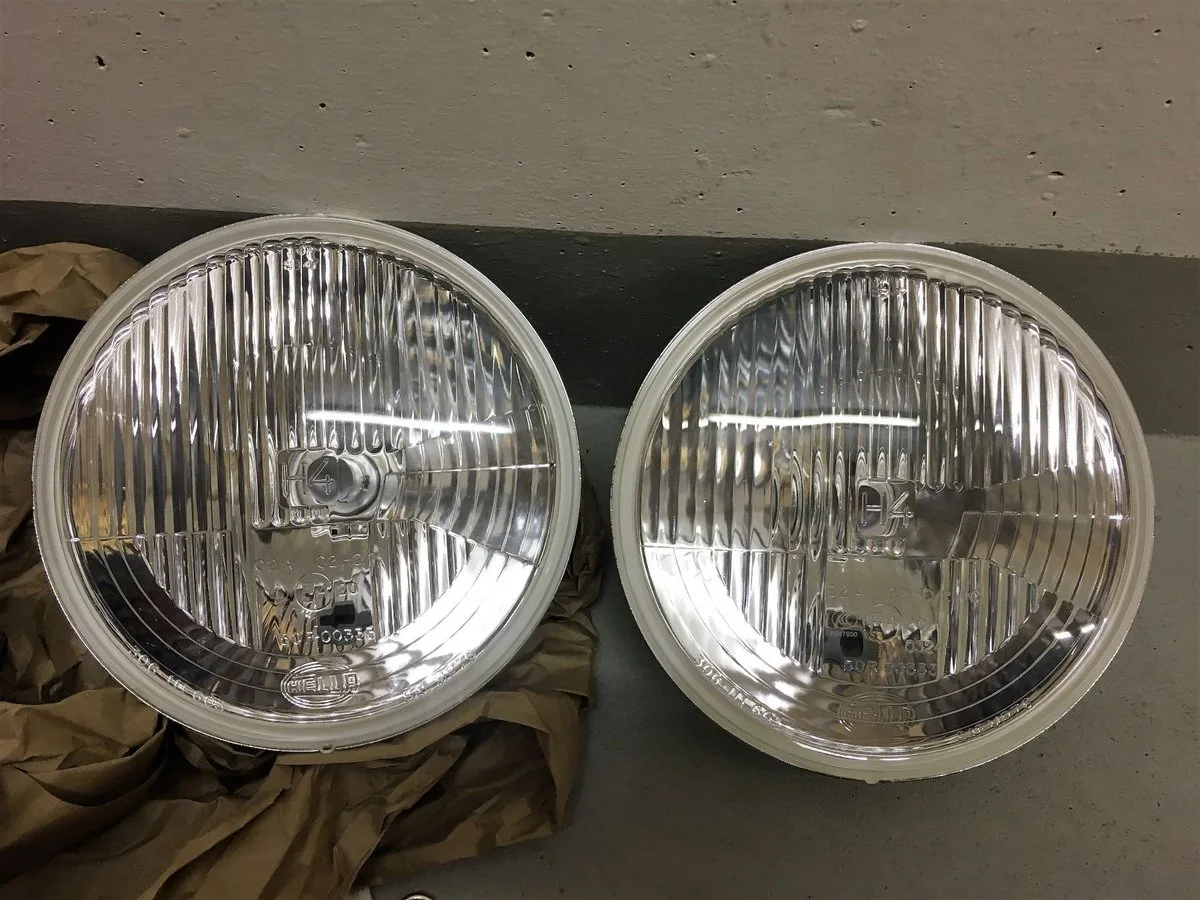

Hella Ecodes arrived today. Quick easy swap. Haven’t tested it on road yet but much much more tame light than the truck lite knock off LEDs. I don’t drive the Jeep a ton at night but I do like the stock look much better.
To me, these are plenty bright enough, and I'd rather sacrifice some performance for a stock look as I hate just about any LED light I've ever seen for TJ's.

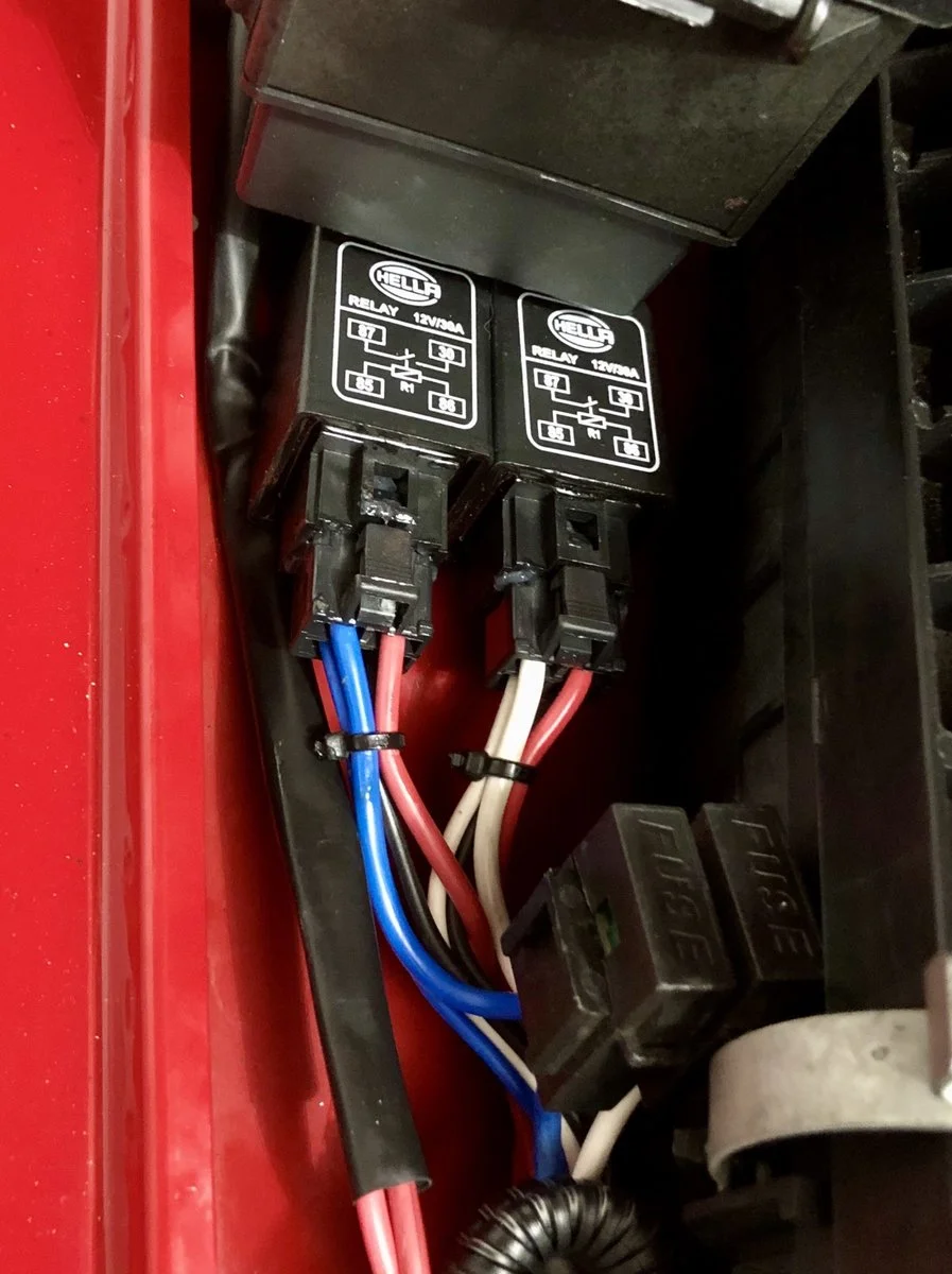

The E-code housings disperse the light in such a way that it produces a nice cutoff point and illuminates the fog line and road signs well. The Extreme Vision bulbs produce a higher color temperature, but not so much as LED bulbs do, so they work well in snow and are easier on your eyes. The wiring harness upgrade is not needed, but if you decide to up the bulb wattage, then I would recommend it. I'll let you know if the harness upgrade is useful, as I ordered it last week.
How’s the harness? Is it this one?
https://www.amazon.com/dp/B078XV8PL7/?tag=wranglerorg-20
I went with this harness,
https://www.ksuspensionfab.com/store/p6/H4_Upgraded_Headlight_Harness.html#/
But the Amazon one looks the same. Mine was $25 shipped. It was super easy to install and came with good quality pigtails and relays. Fit pretty much like a glove. I mounted the relays on the front side of the distribution panel under the hood. Hooked the hot lead to the distribution panel hot stud, and plug-n-play.
I looked up Hella P/N 50R-0033, shown in the photos. It traces to H4 housings used by the factory to equip JK's for the European and Middle Eastern markets. Whether it is the identical "E-code" light pattern used in Canada and the U.S. aftermarket I do not know, but it is certainly an appropriate pattern for @mouks in Switzerland.
BTW, these same housings are shown in several Ebay listings as fitting TJ's. That stands to reason because the Hella housings for the TJ and JK are the same size.

I went with Hella E codes, and a Hella harness that I got on Amazon. The harness is very easy to install and I used one of the front mounting screws for the fuse block to mount the relays for the harness.
