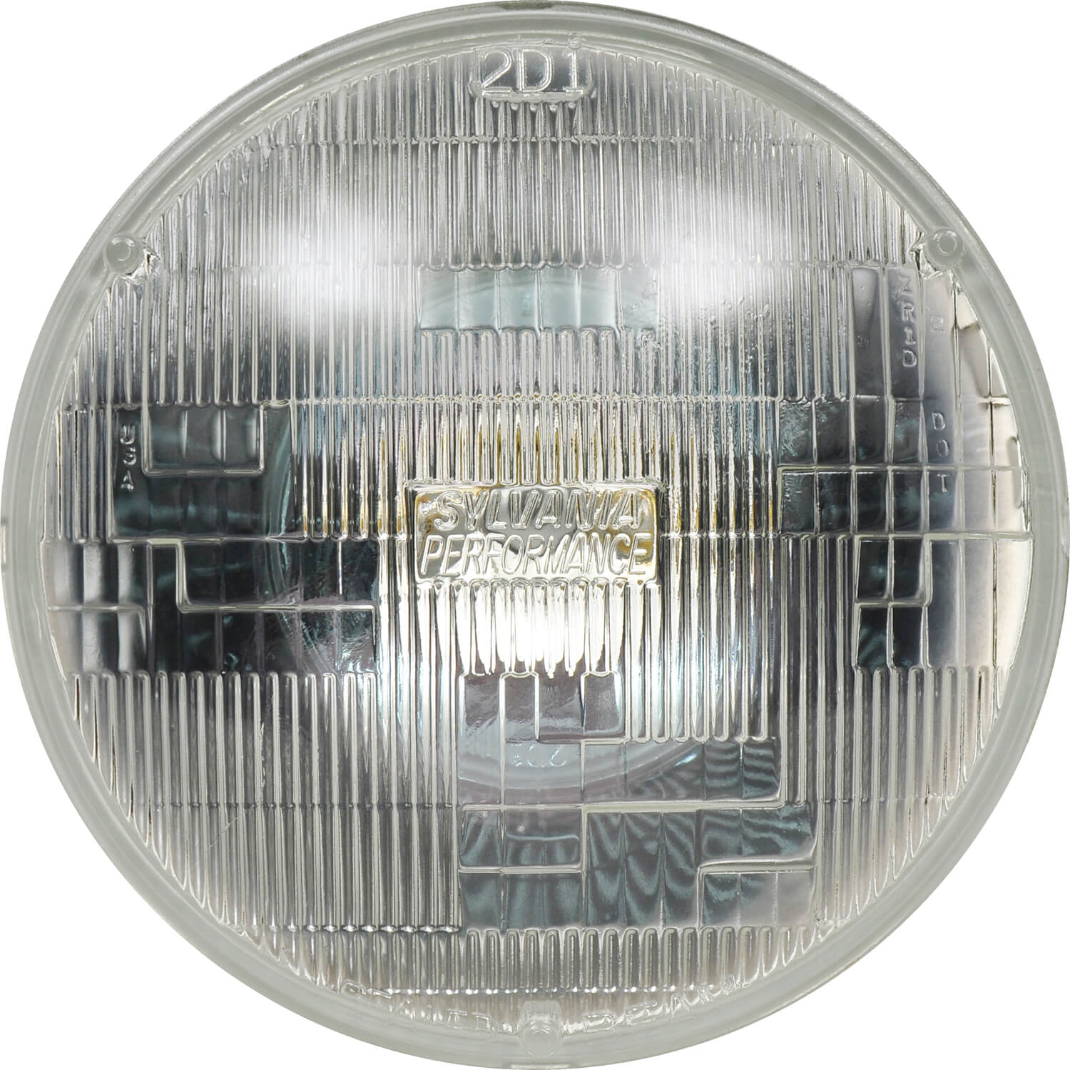

I am going to replace TJ lights with JK lights. I assumed I would need to replace the complete assembly that holds the light in but after looking at some videos it seems like the JK lights fit into the TJ light assembly. Can someone who has done the swap straighten me out on this.
Yes, it's just like the video. ;)
It's a simple swap, the JK light housing fits where the TJ sealed bulb sits.
No extra parts are needed to hold the JK lights.
You will need the plug adapters though.
