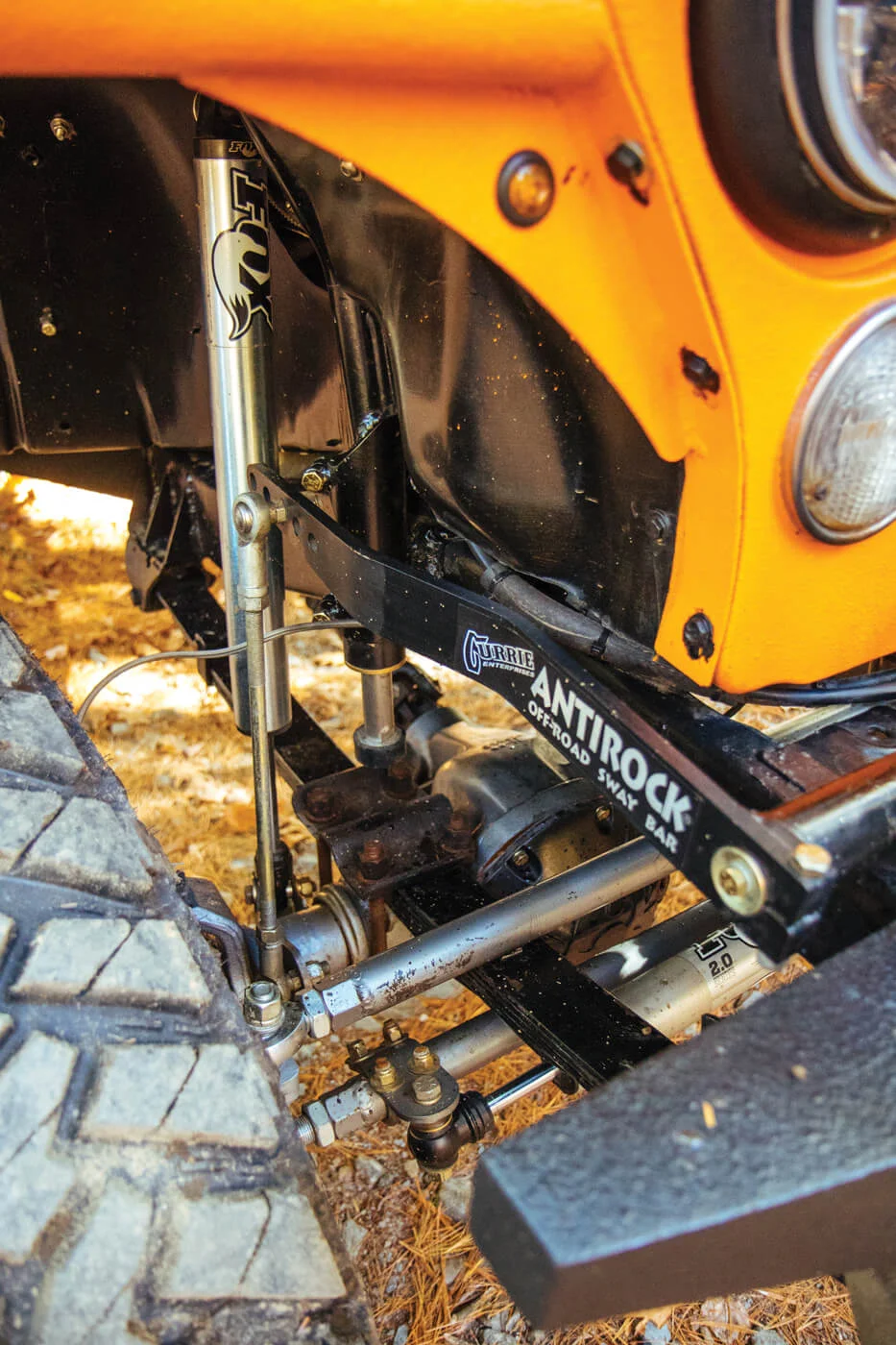

Then I need you to explain how an antisway bar can stabilise a coil spring. Especially an Antirock that has rod end on either end on the links.

Correct. And of equal importantance in the case of the Antirock, they work to keep the body centered between the articulating axles.

You might be surprised how much better the Jeep crawls rocks when fully connected with a softer front like the AR.

X2, exactly. Keeping the front & rear axles working together instead of fighting each other like using an Antirock up front and having no antiswaybar in the rear wouldn't allow the suspension to work as well as it would with a rear antiswaybar. That's what I run for rock crawling... an Antirock up front and a rear antiswaybar.

Looks can be deceiving and in that case, they are completely deceiving. Teraflex designed their product to resemble the Antirock but that's where the similarities end.
