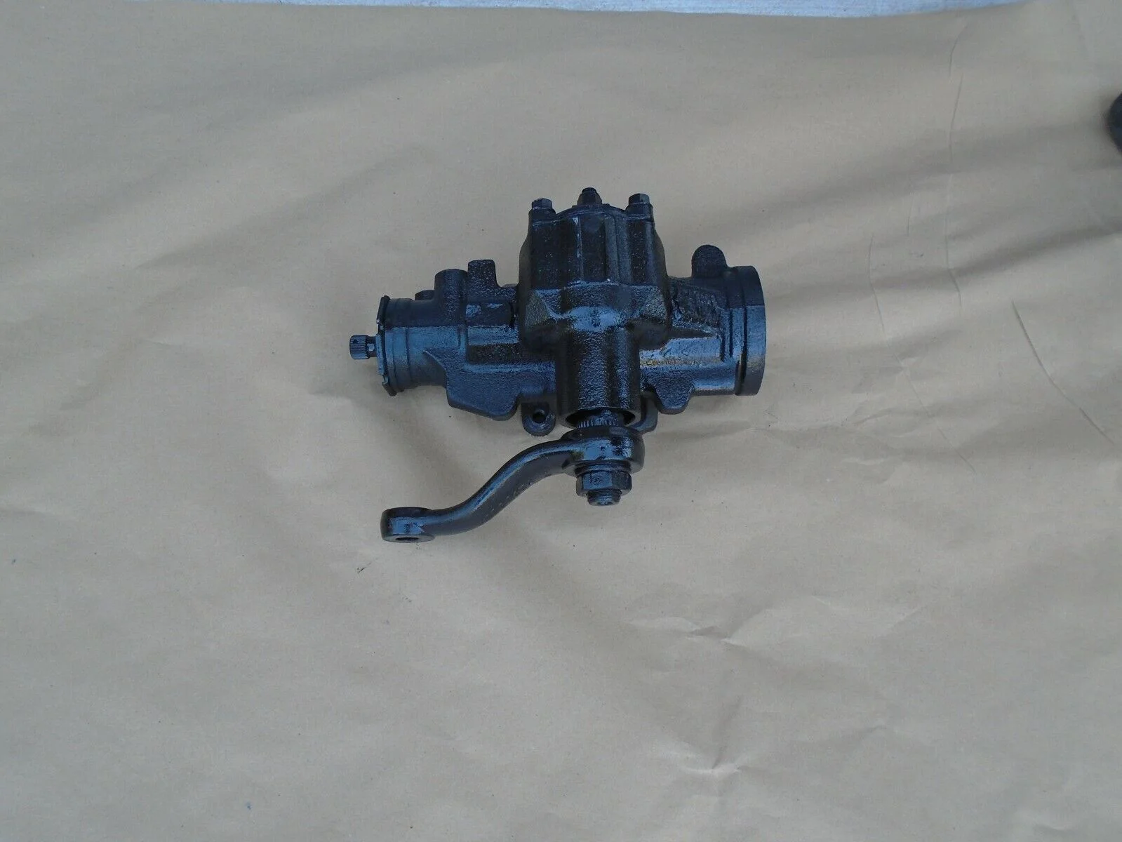

The steering box on my 2000 has started leaking; rather than throw a band-aid on it with stop-leak, I'm going to buy a remanufactured one off eBay. I've watched a bunch of videos, all of which show using a pitman arm puller to remove the pitman arm.
Looking at eBay, there are many listings that just come with the pitman arm attached. Is there any reason I can't just buy one of those, and remove the old pitman arm from the steering linkage to avoid having to use a puller?

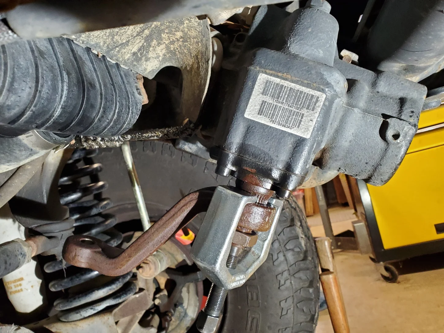

This seems to be the best thread to jump in and ask for help with my issue: After 3.5 years finally made time to "Currect" my steering and remove the dropped Pittman arm. Dropped the linkage without issue but the Pittman will just not turn loose. I've sprayed multiple days/rounds using PB Blaster and Liquid Moly to give everyone a fair shake, and tried the puller to no avail, and lastly with great tension on the puller applied light 'shocks' from the air hammer around the Pittman collar in an effort to vibrate the bond loose. Its a very firm gear box with no extra movement, but I'm down to thinking about replacing it because I'm out of ideas.

Cut it off since it is not needed. Start cutting through in same front location. Once it is close to all the way through it should release. Carful not to hit the splines.
How tight are you running the puller? Using an end wrench or a large breaker bar?

Second cutting a slot at the thinnest spot. Go as deep as possible and then hammer in a chisel into the cut. It’ll split the uncut part and fall off.

Had previously considered, but now think I'll give it a go. Have about 150 ft/lbs + on the puller trying not to break it, but will definitely remove it to cut so it doesn't explode off.
