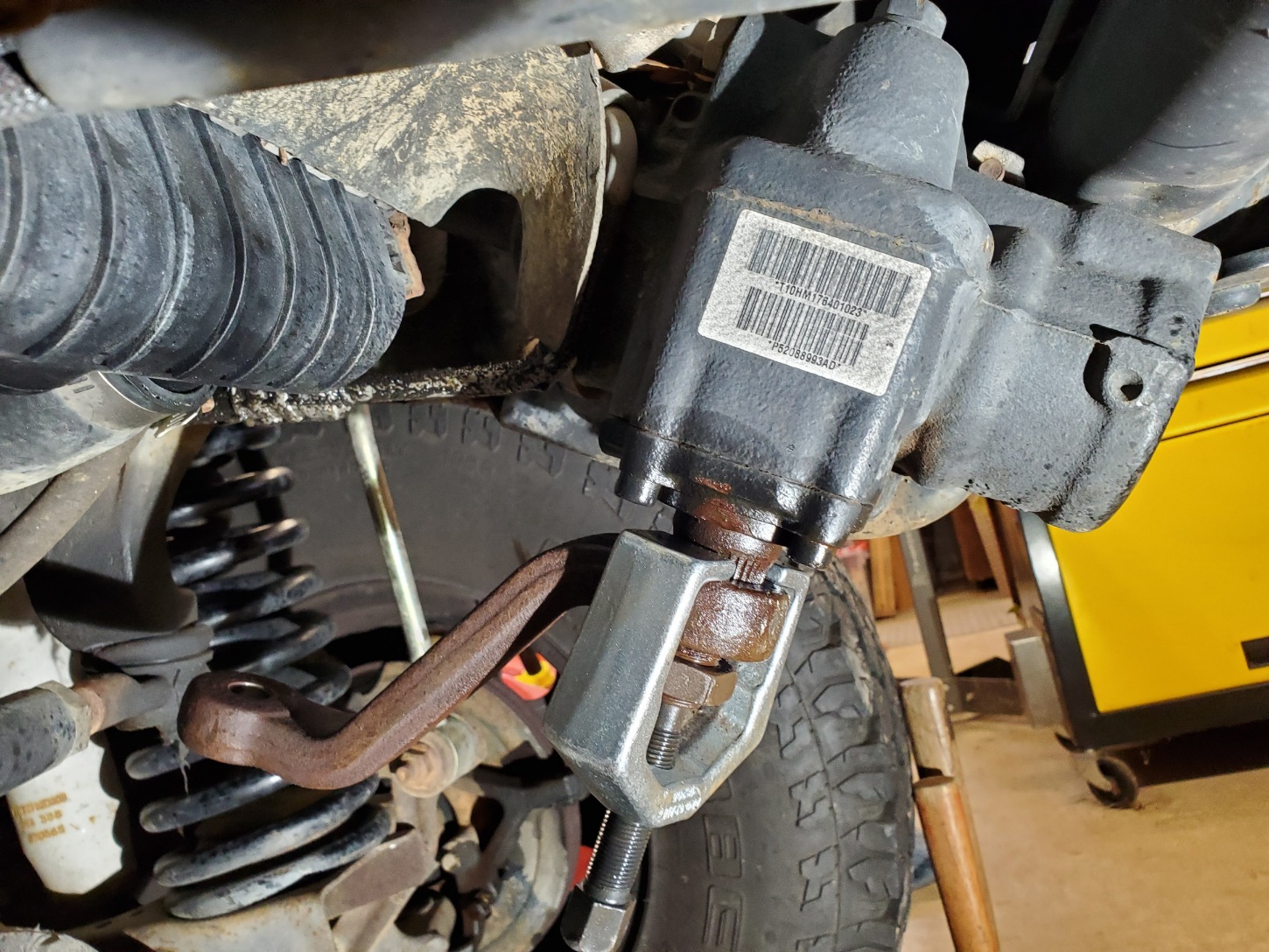

Had previously considered, but now think I'll give it a go. Have about 150 ft/lbs + on the puller trying not to break it, but will definitely remove it to cut so it doesn't explode off.
If you aren't in fear of breaking that particular puller, then it isn't tight enough. And you need a real pitman arm puller.

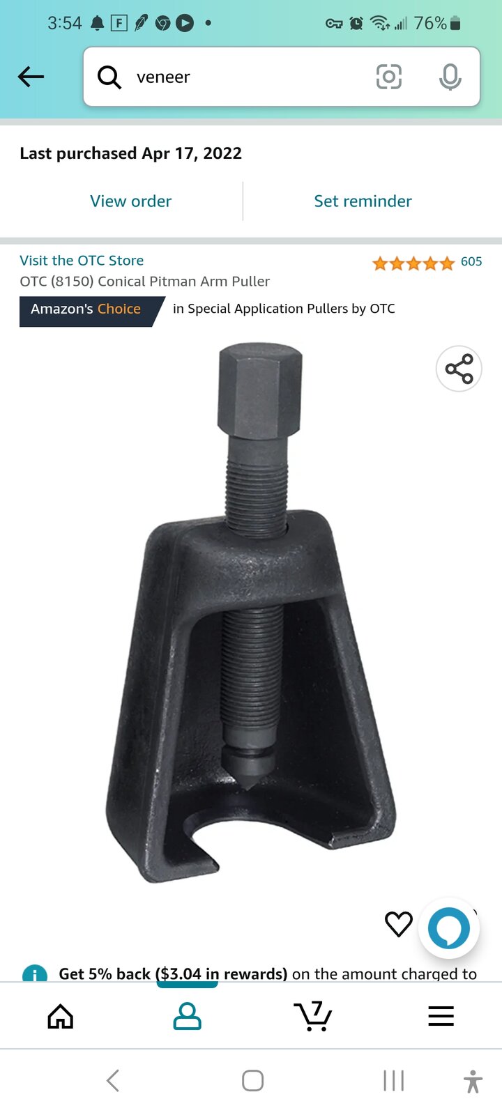

OTC (8150) Conical Pitman Arm Puller https://www.amazon.com/dp/B00061SMS0/?tag=wranglerorg-20

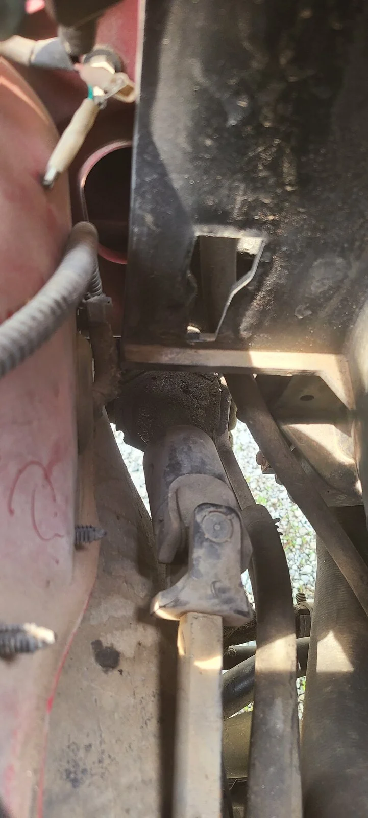

Now I have a new major dilemma. After removing the Pittman I realized my steering wheel had rotated 180° to the lock point; on further assessment the steering column spins freely in the gearbox . . . what is going on??
I cut off the pitman arm to replace on my 17 Duramax due to clearance and the fact the box is partially electronically controlled and would have required major disassembly...WTF were they thinking on that. Anyway, I took my time with a cut off wheel and used a chisel inside the cut to separate. Just take your time when cutting and check often so you don't get into the sector shaft.
The pitman arm will only fit on 4 ways, there are 4 large splines. The pitman arm faces towards the rear.

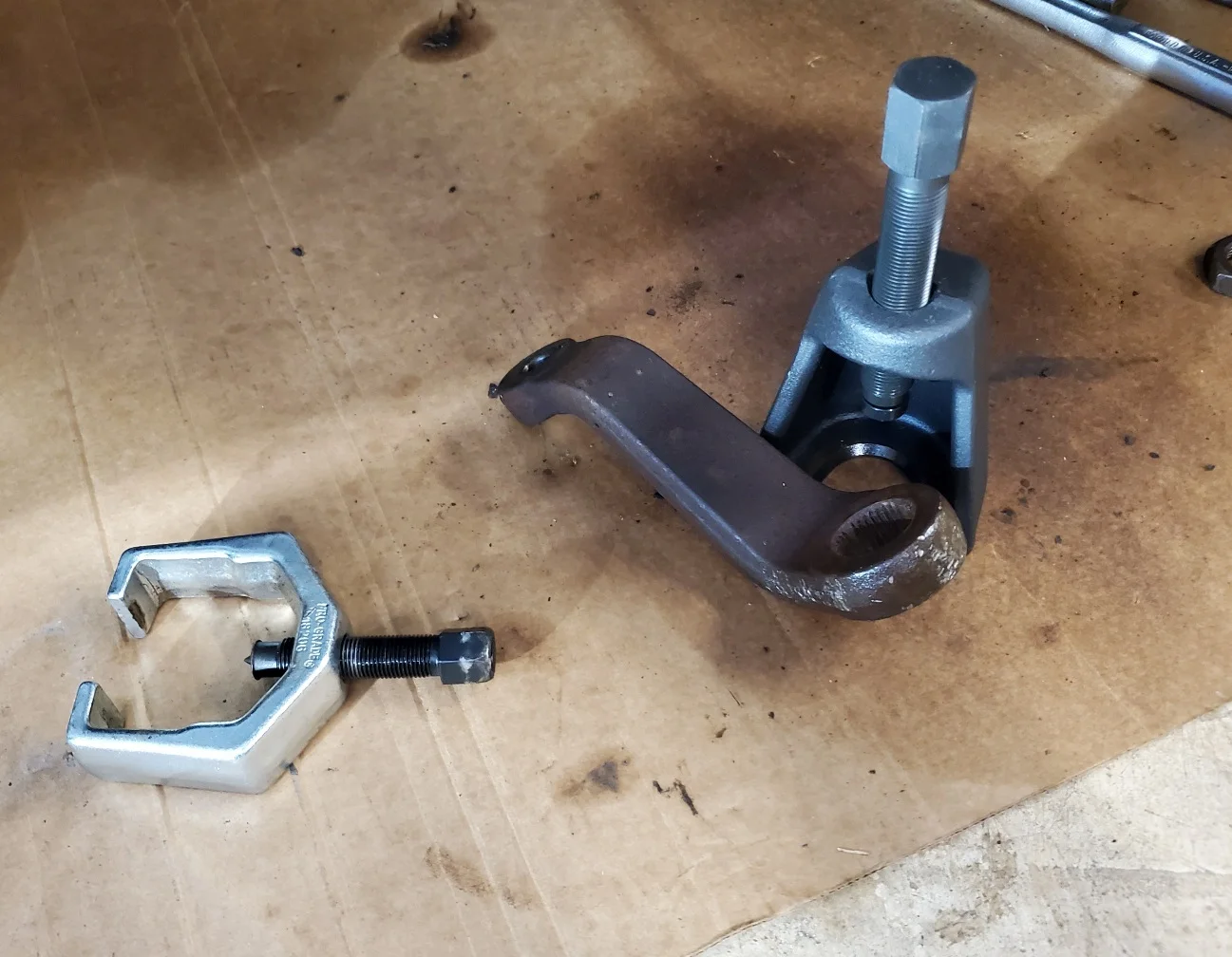

This seems to be the best thread to jump in and ask for help with my issue: After 3.5 years finally made time to "Currect" my steering and remove the dropped Pittman arm. Dropped the linkage without issue but the Pittman will just not turn loose. I've sprayed multiple days/rounds using PB Blaster and Liquid Moly to give everyone a fair shake, and tried the puller to no avail, and lastly with great tension on the puller applied light 'shocks' from the air hammer around the Pittman collar in an effort to vibrate the bond loose. Its a very firm gear box with no extra movement, but I'm down to thinking about replacing it because I'm out of ideas.
Take that pitman arm puller and throw it in the trash where it belongs. Then buy the OTC clamshell type.
