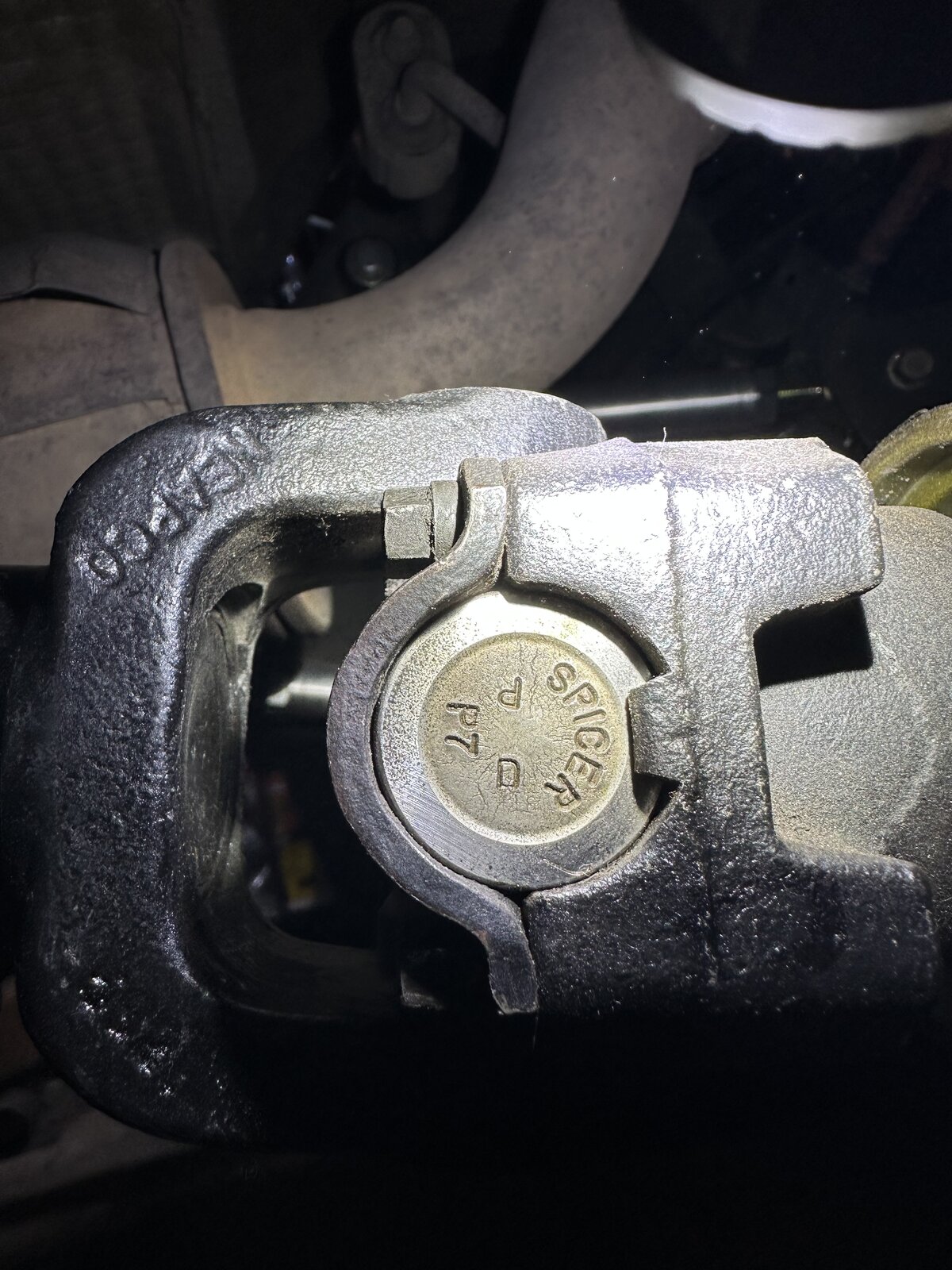

  • We use our own brand joints for various reasons.
    • A long long time ago, when we were just a small company, Spicer would not sell to us due to politics involving the company my dad (Tom) used to work for, which was at the time a large Spicer distributor. They went out of their way to prevent us from accessing their parts. At the time, my dad was a strong advocate of using only Spicer parts. Plan A of using only spicer parts fails, you gotta come up with a plan B. When we did finally get authorized to buy direct from Spicer we didn't jump ship on the other suppliers we had established, partly out of principal and partly out of pragmatism. We do currently purchase a lot from Spicer though.
    • Turning an obstacle into an opportunity, my dad took the opportunity to have joints made with a bit of a design change/improvement. Instead of putting the grease fitting in the body of the joint where the hole creates a weak point, we put the grease fitting in the end of the cap. Also, when grease fittings are in the body of the joint they are difficult to access. The harder it is to grease a joint the less likely someone is to do it, hence the grease fitting in the cap.
    • Availability. During the supply chain shortages and ridiculous backorders of recent years we have moved more of our parts away from Spicer and Neapco. It is not uncommon for orders to be 3-4 months backordered. These are orders that are placed at the beginning of the year as monthly releases, its not like we didn't plan and just drop an unexpected order on Spicer. Normally, we stock a ton of Spicer joints, we try to keep a couple months' worth on the shelf (see the attached photos). Whenever we have been out of Spicer joints it was because Spicer couldn't keep their obligations to fulfill orders. When we don't have parts for months at a time, we can't sell drive shafts for months at a time. That's a quick way to piss off our customers and to go out of business. This applies to more all parts, not just joints.
  • Addressing the idea that we are using "cheap" joints to cut costs.
    • All joints are cheap, by "cheap" I mean inexpensive relative to the rest of the parts of the shaft. All 3 universal joints account for about 7.5% of our total expense when looking at our cost to build and ship a shaft. If we were looking to use cheap parts to cut costs we would look at parts that cost more, like the cv weld yoke which costs more than all the joints combined. We could easily sneak this in as nobody ever asks what brand cv weld yoke we use. Do that with all the other parts and we're talking some serious savings. But we don't do that, we use spicer and Neapco parts for almost all the parts in our shafts. We use these two brands, spicer and neapco, interchangeably. They are both premier quality parts and we use them both so that we aren't totally dependent on just one supplier. If we used bargain bin joints we might be able to cut $10 (approximately $3 per joint) total from the cost to build a shaft. Not a significant amount.
    • We don't charge extra for Spicer joints. Whenever a customer specifies that they want non-greaseable joints we default to spicer. This is primarily because Spicer is the brand that people usually request when requesting non-greaseable joints. That used to be the only brand non-greaseable joints we carried. However, over the last couple of years there have been times where Spicer didn't ship us our orders for several months at a time so we started carrying Neapco non-greaseable as a backup. The reason we don't charge extra for Spicer joints is because the price difference is negligible and because we want people to choose what they want based on what they think is best for them, not on price. Frankly, I don't care which joints a person wants us to use which is why I go out of my way not to lead the customer's decision. I don't however remember a time where we were out of non-greaseable joints altogether or didn't have spicer greaseable joints on the shelf. Your understanding that the goldseal was your only option was, I believe, a misunderstanding.
  • Addressing the statement that the goldseal joint is "prone to failure". I believe this statement to anecdotal and extrapolative. The fact that it can happen does not mean it happens often. We use about 25,000 goldseal 1310 series joints a year. Naturally, statistically, some of those are going to be bad or fail prematurely but it is not a common thing. If it was, we'd change course real quick.
  • I don't actually see visible wear on the trunnions of the joints. I know you said you can feel some play and I know you said that replacing them fixed the issue but I still don't see where or how the joints are worn.
Bottom line(s) to all of this:
We aren't making a decision to use the joints we use based on cost. In fact, there is a line of Spicer greaseable joints that we could use that actually cost us less than the goldseal joints cost.
For those of you who prefer the spicer non-greaseable joints we are happy to accommodate that preference at no additional cost. It is a standard selectable option on our website and a question we always (unless we maybe forget) ask over the phone
Sometimes things do fail or wear out or have problems though. @HornedToad, you seem to have had some bad experiences with our joints and for that I sincerely apologize.
