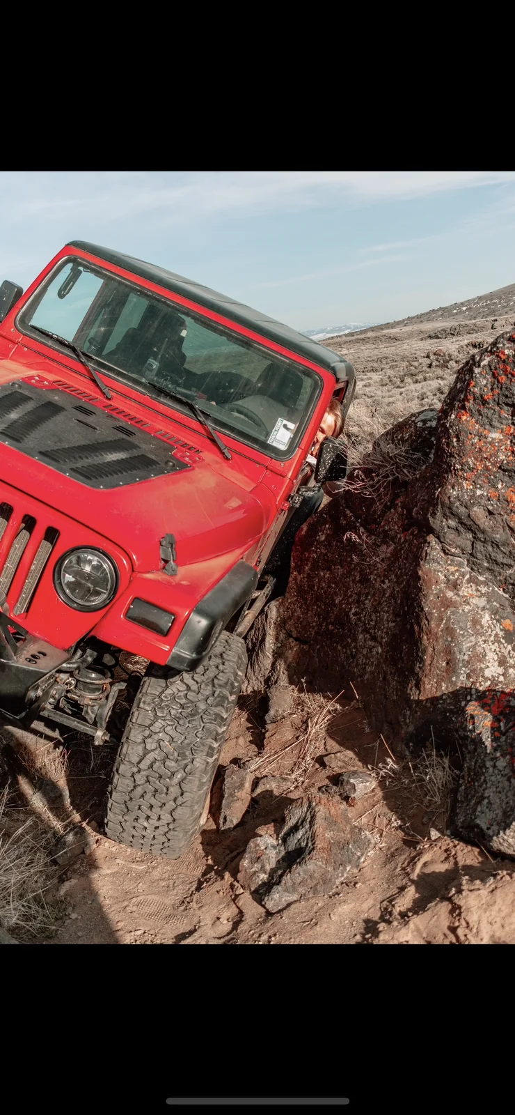

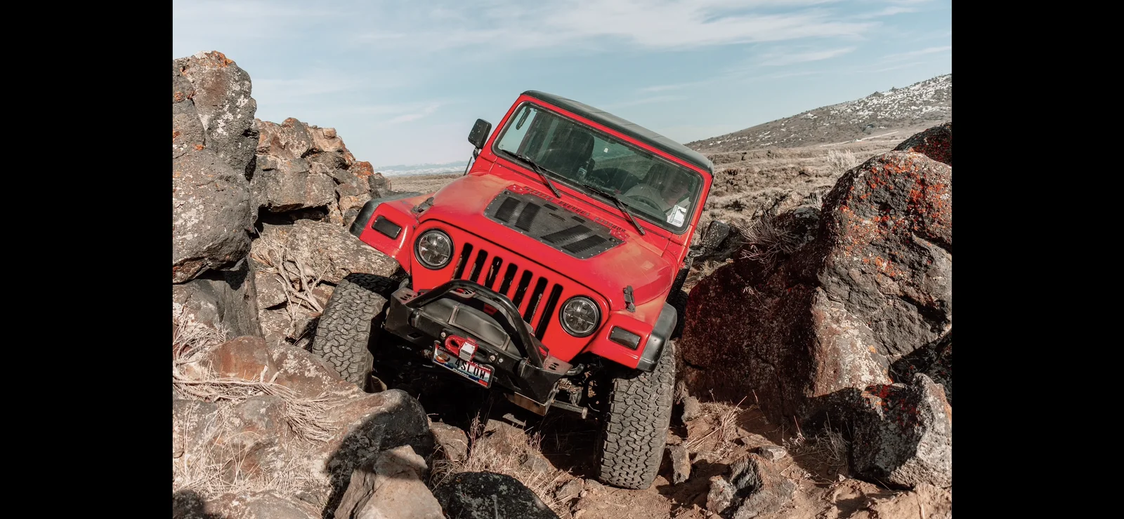

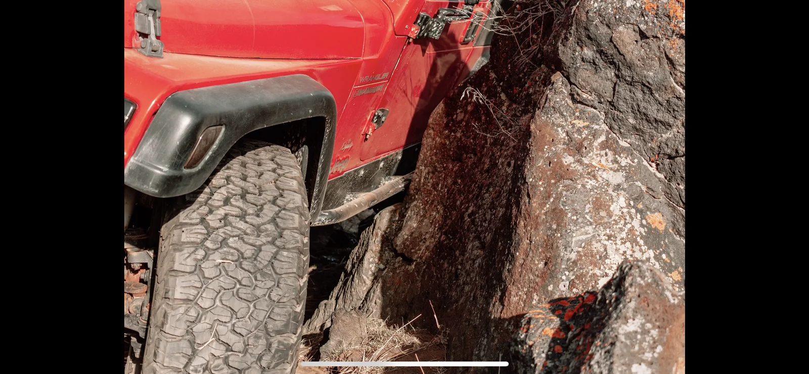

I didn’t think I cared for the tubes till I found this obstacle. In the pic I still had to climb that front passenger tire which ended up just leaning the whole jeep on the tube and just missed my door. I only use the tube when getting in the back seat or I swing on it to slide under the jeep real fast.
