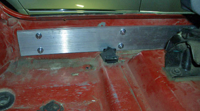

This is a good point Jerry. What are the rough dimensions of that plate Savvy provide?You could easily make your own internal reinforcement plates that go on the inside of the rockers. This is what Savvy provides, it's a thick piece of aluminum.
My TJ is under a locked cover or I'd measure it. Basically it's as big as will fit to completely fill the open area inside the rocker area. It's probably 1/4 or 5/16" thick. @mrblaine would know, he designed it.This is a good point Jerry. What are the rough dimensions of that plate Savvy provide?

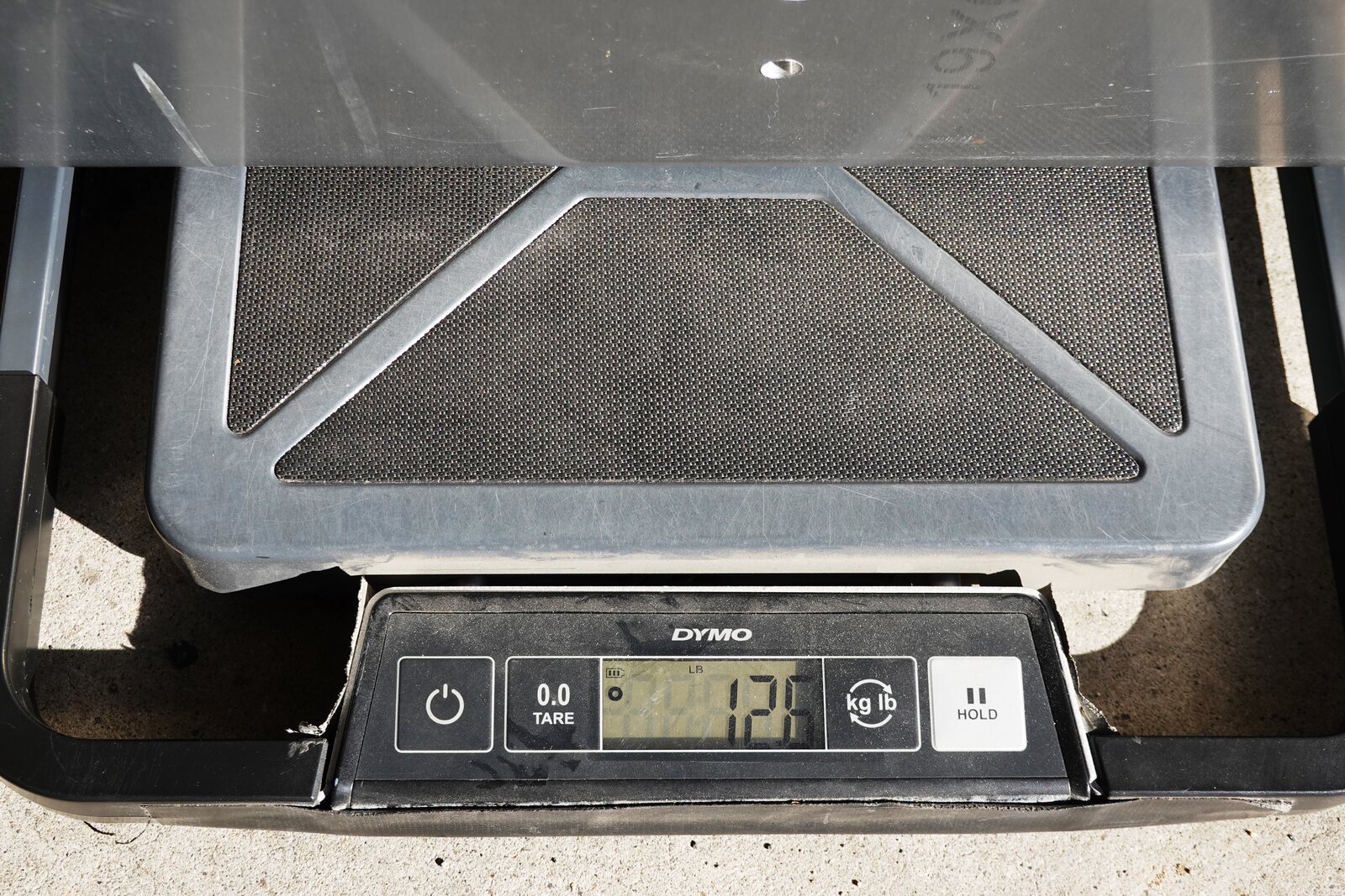

Savvy backer less the plate inside-Somewhere I gathered that the Savvy are around 80lb for the pair. The ARB are 63.5lb for the pair. The weight difference of 16.5lbs is the near equivalent of a gallon of water on each side. Nothing to lose sleep over.

Let’s get that fixed in the OP!Savvy backer less the plate inside-

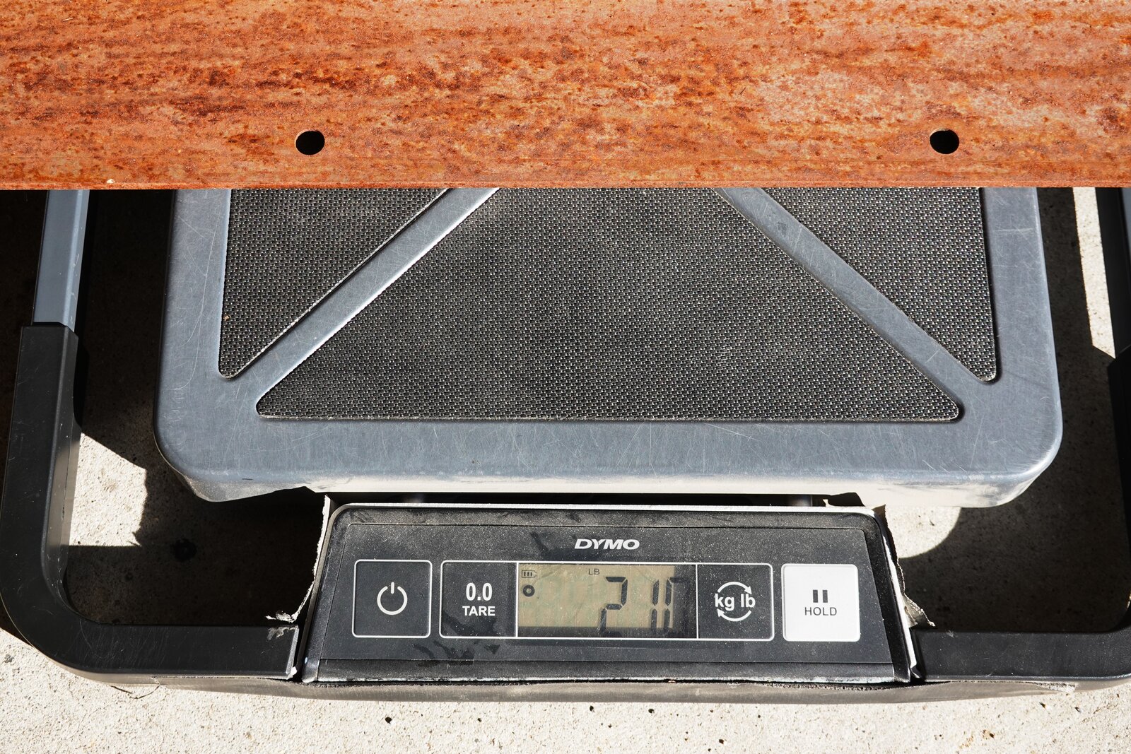

Both together are 33.6 lbs x 2 for the pair = 67.2 + a couple of pounds for the internal backers. Not much difference. View attachment 300163
Savvy slider-
