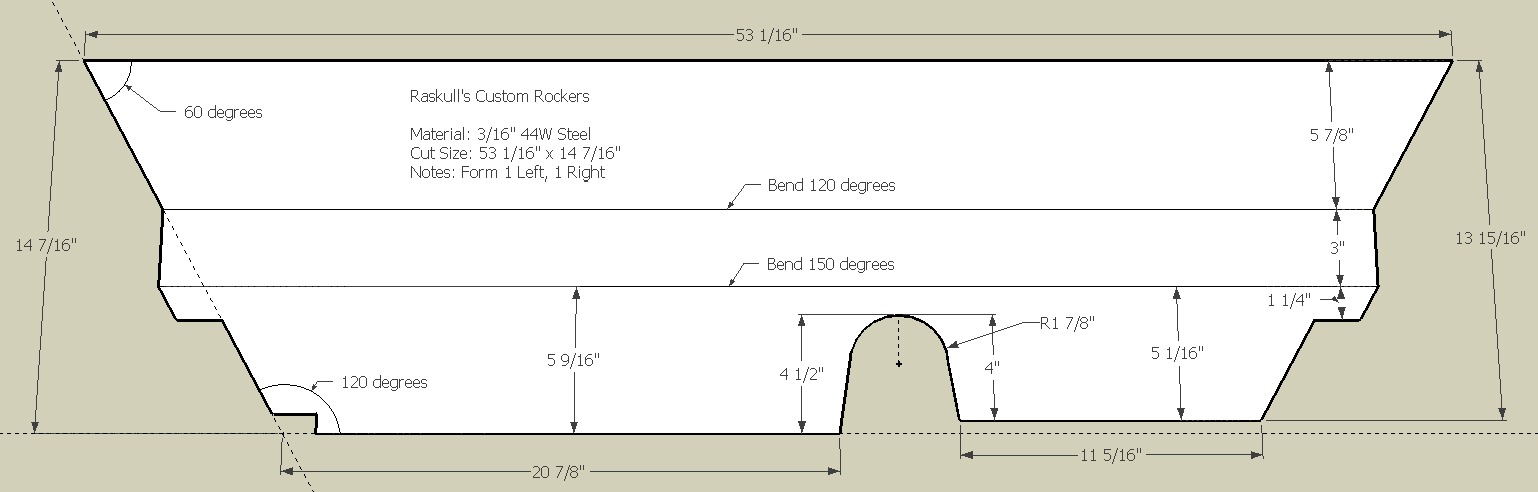

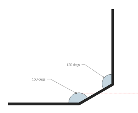

Small update for DIY Fabricators. I found this design on a website, so it is not original with me. It looks very good, although I have not measured the length to see if it is WW2WW. The double bend is an excellent feature (120* and 150*), and it appears to have plenty of underbody coverage where you could tub mount, the preferred method. If someone could fab some of these up for <$300, they might have a venue...
I've come back to this old post. I know somebody tried to model it previously, but I don't believe they got it right. This is what I get in profile, which I think looks far more what the original designer was looking at.

The original drawing shows it in 3/16" steel. If I wanted to go for aluminium, as per the Savvy slider what thickness would be reasonable? Or put another way, how thick is the aluminium part of the Savvy slider?
I do know that the bends could not be sharp as shown above and would need a minium radius, but I am not a CAD expert and have very baic tools, so have ignored that for simplicity at this stage.

This is what your are looking for as a template, if the goal is a GenRight style mini boatside as depicted.
Use 3/16" steel. Aluminum is not an appropriate material for this application, unless you put a steel skin over the aluminum.

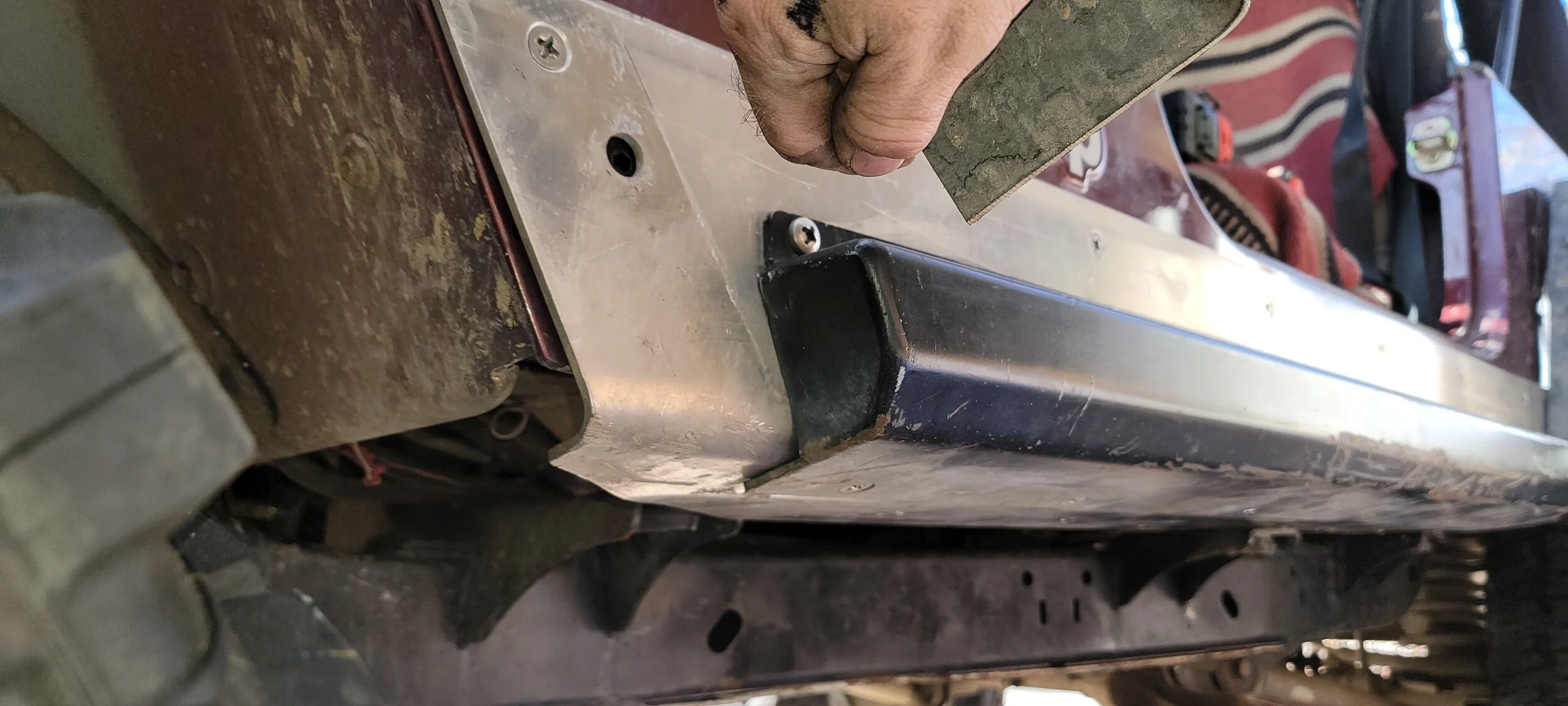

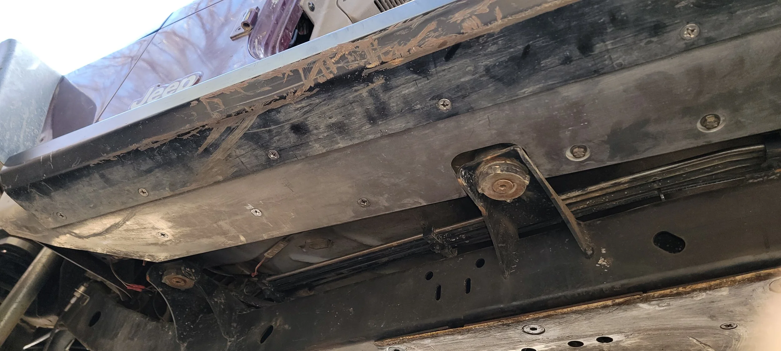

Thanks, that's helpful. Having looked at the list of ideal slider features near the start of this thread I was thinking of something two piece, like Savvy. This seems to have two benefits. First, the outer part can be repaired and / or replaced without having to replace the part that attaches to the body. Second, it means it is possible to use different material for the two parts, reducing weight.
I note the GenRight aluminium version is specified as being for snow or sand only on their website, but that is all aluminium. The Savvy has the step part in steel. If I understand correctly how the two parts fit together that would mean the face on the body and the angled down section would be protected by the steel step. The section under the Jeep protecting the torque box would be protected by the aluminium part the steel step attaches to. Is that correct?
What i'm interested in is the appropriate thickness for that aluminium part the steel step is attached to.
The Savvy aluminum rocker is 3/16" 6061t6 aluminum.
Reactions: UKTJ
You are only reducing the weight of an equivalent built slider system if both pieces were in steel. The aluminum is to reinforce the tub with a lot of bending resistance, the steel is to protect the aluminum.
Correct
Also correct.
US- .188" or 3/16", approximately 5mm in your neck of the woods.
