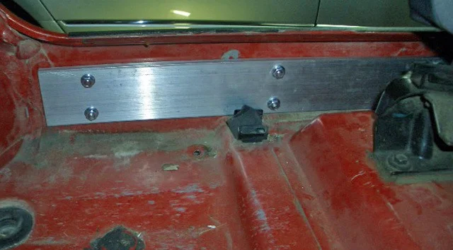

From what I understand its to reinforce the tub mount. I look forward to learning if it truly matters or not. :)

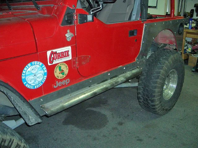

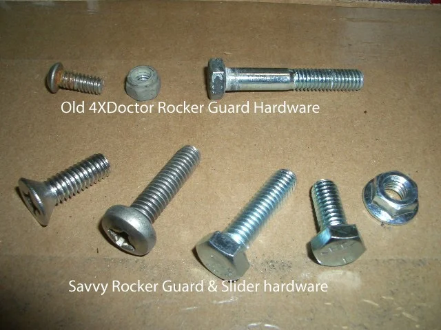

My previous TJ's 3/16 rocker guards from 4XDoctor bent inward and bent/wrinkled the tub underneath them. They had no internal bracing. It took a BFH to beat that side flat enough to install the replacement Savvy rocker guards.

Oh yes, I talked to Tanner at TNT, no countersunk underneath, but swears bolt heads never damaged beyond removability. I was thinking hard about the Genright’s. JCR looks interesting. Will see where the fundage is in May. If good then maybe Savvy, but I got to save for lockers, regear and s35 in Jan 2019
Reactions: JamesAndTheSahara
Nearly all of the ones I have seen use regular bolts on the underneath vs countersunk bolts, let me spit some words. If your Jeep touches salt with a countersunk bolts, you will strip the head so easily trying to get it out. Grade 8 bolts will hold up just fine down there. Remember your body mount will 99% of the time before it hits one of those bolts. I do have countersunk bolts holding the step to the rocker although those are backed by a flange nut and not a nutsert (Although had I had some additional nutserts I would have put them on the aluminum panel to hold the step).
I guess what I’m getting at there are trade offs on which hardware and used, just be aware of the consequences of the countersunk bolts on the bottom.

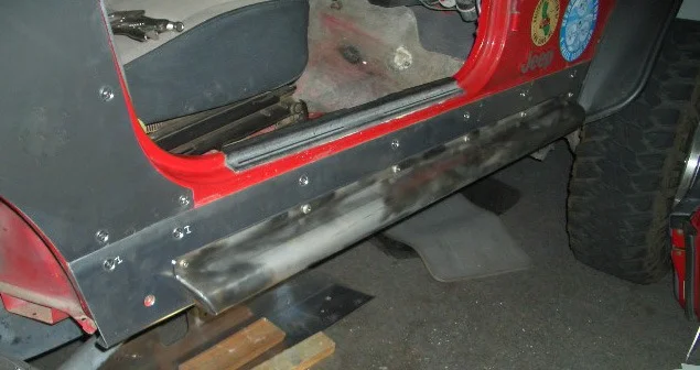

My info will be biased towards actual use in the rocks where it matters and it will follow a set of general rules that one should adhere to when designing a slider system for the same application. Fair warning, if you do not have the need for a proper design rail, then ignore the rules and do whatever you like.
Do-
Use small fasteners and large quantities of them. The tub sheetmetal can be deformed and pulled outward simply by overtightening the very small 5mm bolts that hold the flares on. That means you have to adopt a fastening solution that functions in similar fashion to how they build airplanes.
Use an internal brace to sandwich the unsupported areas of the tub. Lots of small fasteners to spread the load out over as large of an area as possible and then an internal brace needs to be incorporated in the larger unsupported areas under the doors.
Use a slider that contacts the rocks which can be replaced without welding or replacing the whole assembly. We have seen far too many damaged tubes and slide rails that would cause you to replace the whole rock rail or cut and weld a new tube on.
Wheel well to wheel well is mandatory. The unprotected bits under the flares are in danger, protect them.
Go under the rig and get the torque box protected. We have crushed and mutilated the torque box many times and it has to be protected.
Don't
Ever use any part of the body mounts to mount a slider. That is dumb, shortsighted, and shows a very clear lack of understanding about what constitutes a proper level of mounting and protection for the rig.
Cut the corners of the rock rail into the corner armor. That leaves a small tab hanging that does shit for protecting anything. If it isn't wheel well to wheel well, don't use it.
Use a small number of big fasteners. The sheet metal isn't strong enough.
Miss areas because you don't want to install nutserts. Nutserts are good, use them to your benefit.
Hang down below the edge of the tub. Put two bends to go from the edge over to the torque box and then flatten out there. Otherwise, you are giving up precious ground clearance in an area you need it the most.
Put a tube step on a slider backer. The leverage from the step increases the rotational force against the slider and isn't good for anything or anyone.
Generally-
Put anti-seize on the countersunk part of a flat head. The surface area being large relative to the shank size is what causes problems.
Bolts on the underside away from the edge of the tub are not really an issue.
Slideability is dependent on radius size. The smaller the radius, the harder it is to slide against a rock. The worst is a sharp angle iron corner that digs in. The near best would be something about the size of the rear corner bend but that is obviously too large so keep the radius as generous as is feasible. Sharp bends are bad, don't use them.
Any rail that has a 90 degree bend at the bottom edge is not worth owning. Send it back.
