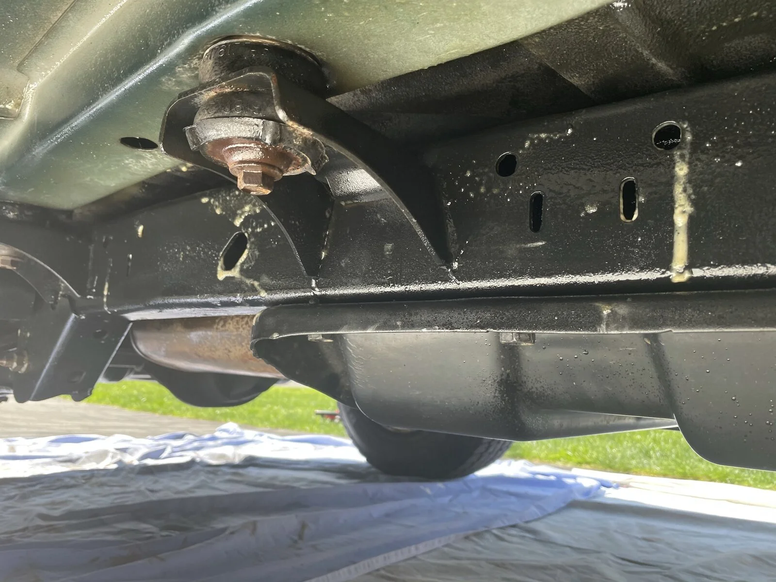

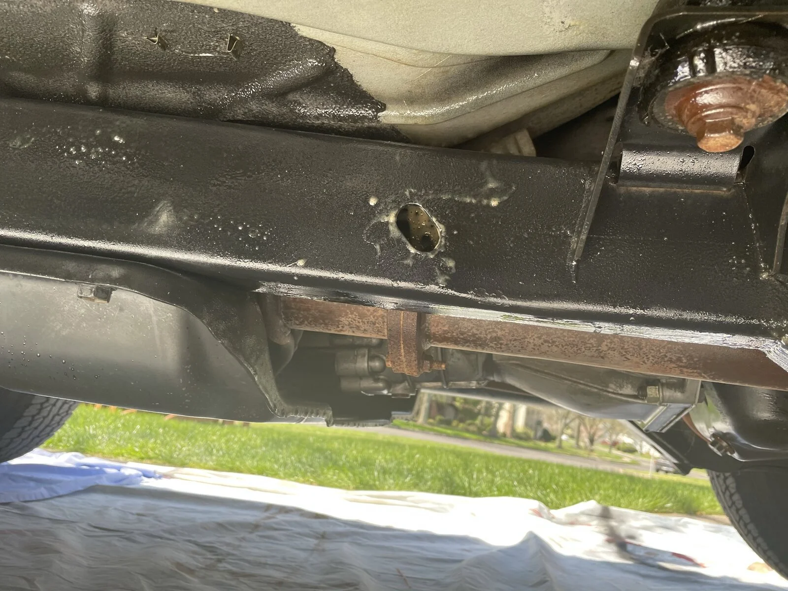

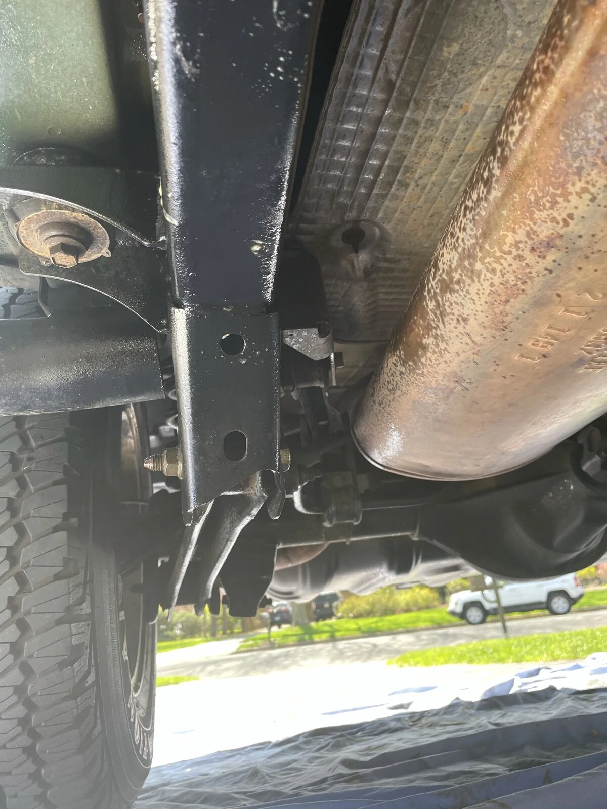

Weather was beautiful here in the Philly suburbs today so I finally had a chance to Fluid Film my frame. Here are the steps I took, it went pretty smoothly.
1) I used my air compressor to go through the whole frame front to back and back to front getting out any debris. As a note, my frame is completely rust free so there were no additional steps of dealing with rust first.
2) I parked the Jeep on some drop cloths to avoid dripping onto the driveway.
3) I worked front to back using the 360 wand that came with the Fluid Film three pack from Amazon. I pushed the applicator all the way in and then started spraying and slowly pulled it out. I then moved to the next section and repeated the process. I think I pulled the applicator too slowly and probably over did the application. I ran through 3 cans very quickly. I would pull it out quicker next time.
4) after coating the inside of the frame and the torque boxes I moved on to coating the outside of everything. This was much less of an organized and strategic process. It is messy and the basic can nozzle is more of a jet than a spray. I ended up switching back to the 360 nozzle. It got messy and I just sprayed everything working my way around the perimeter under the Jeep. I avoided the exhaust and the brakes. I still got some on the exhaust so I wiped that down as best I could.
5) I let it sit for awhile then drive it to burn off any excess, there was a small amount of smoke, nothing major, I had to look for it after I came back from the ride. I parked it in the garage and put drop cloths under it.
6) in the end it was an easy job. Doesn’t smell as bad as others have said. Good coverage of everything and I am good for a year, I will clean it off and do it again next spring.
A few photos of the process.
Reactions: Mac and Cheetokps

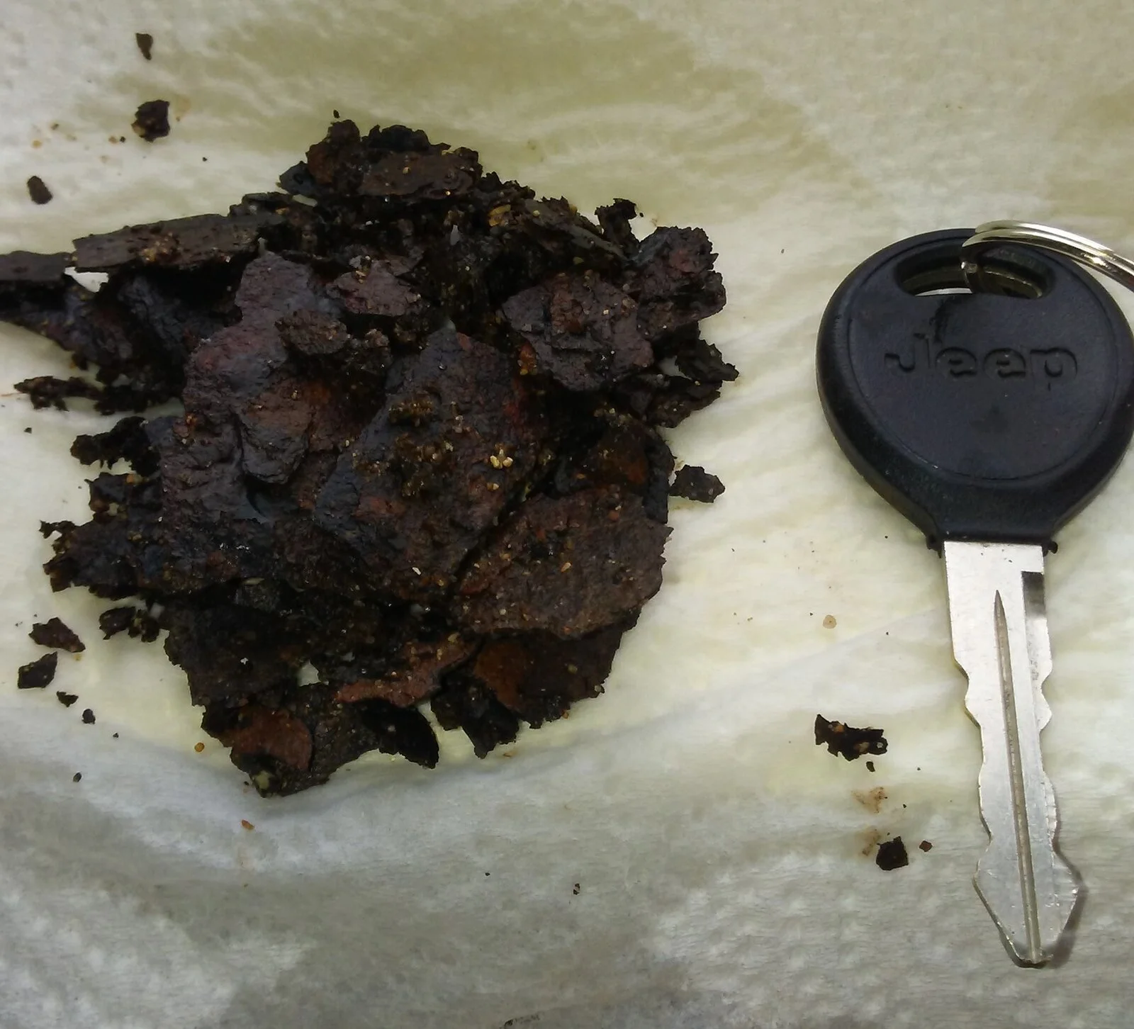

I started cleaning mine and unfortunately found rust inside my frame while spraying out all of the road chemicals at the car wash. I've been scraping, power washing and using a magnet for the past couple of days. I ordered some Eastwood internal frame coating today. $30 a can! Hopefully I can stop it now.
p.s. I drilled the drain holes when I bought it almost 4 years ago.
