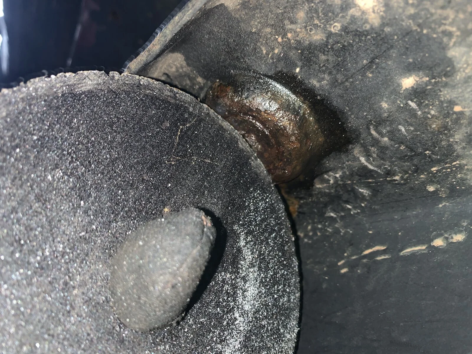

I just put a cutoff wheel on my electric angle grinder & cut the heads off. The shape of the skidplate makes it a little tricky but it can be done.
https://wranglertjforum.com/threads...aid-i-need-this-stuff-build.45882/post-803877
My spacers were actually rusted to the bolts themselves, so once I cut the heads off I had to beat them with a hammer to actually get the TC to drop.
If I were you I'd order a set of new nutserts from Blaine's site & replace them all. It's not the easiest thing but also not the worst. And air chisel helps. There's a link on his page here to a BFH video that explains how to do it, took me about half a day to replace them.
https://www.shop.blackmagicbrakes.c...ep-YJ-97-02-Jeep-TJ-and-03-06-Jeep-TJ_c79.htm

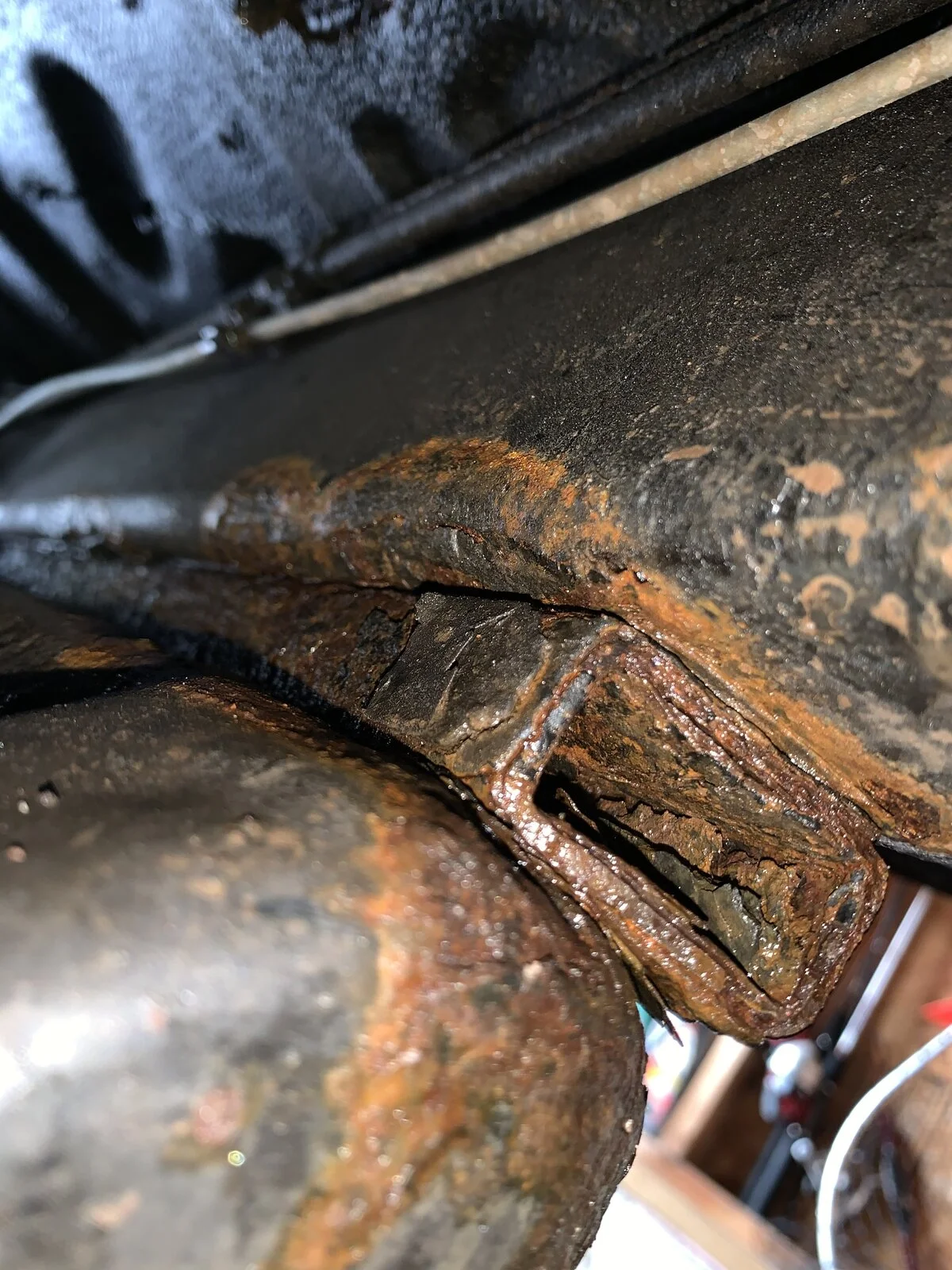

The factory bolts probably stick out more, but with mine I would be cutting into the skid plate if I did that so I’ll probably just cut through the bracket.
My nutserts seem fine, they aren’t spinning it’s just the heads of my bolts are all stripped. Might as well replace them all when I’m under there though, and definitely new bolts and getting rid of the skid drop (maybe a few washers instead)
I’m going to have to take care of the frame rust under there too, I’ll wire wheel it down
and spray sone rust preventative paint on it. Hoping it isn’t too bad
Edit: Looks pretty bad to me. Hoping this won’t need to be professionally repaired, I’ll check it out more when I get the skid off
Oooof, yeah definitely better to have a single small spacer in there instead of that long bar.
Reactions: Ephry73
Yeah, damn previous owners lol. I'm hoping it would be easy enough to cut through the bar to get to the bolts. Not even sure why there is a spacer on it, it only came with a 2" budget boost
When I cut my bolt heads off I neglected to mention that I also used a grinding wheel. I was able to get part of the bolt off with a normal cutting wheel, when I couldn't get the rest I put a grinding wheel on & ground down the rest.
