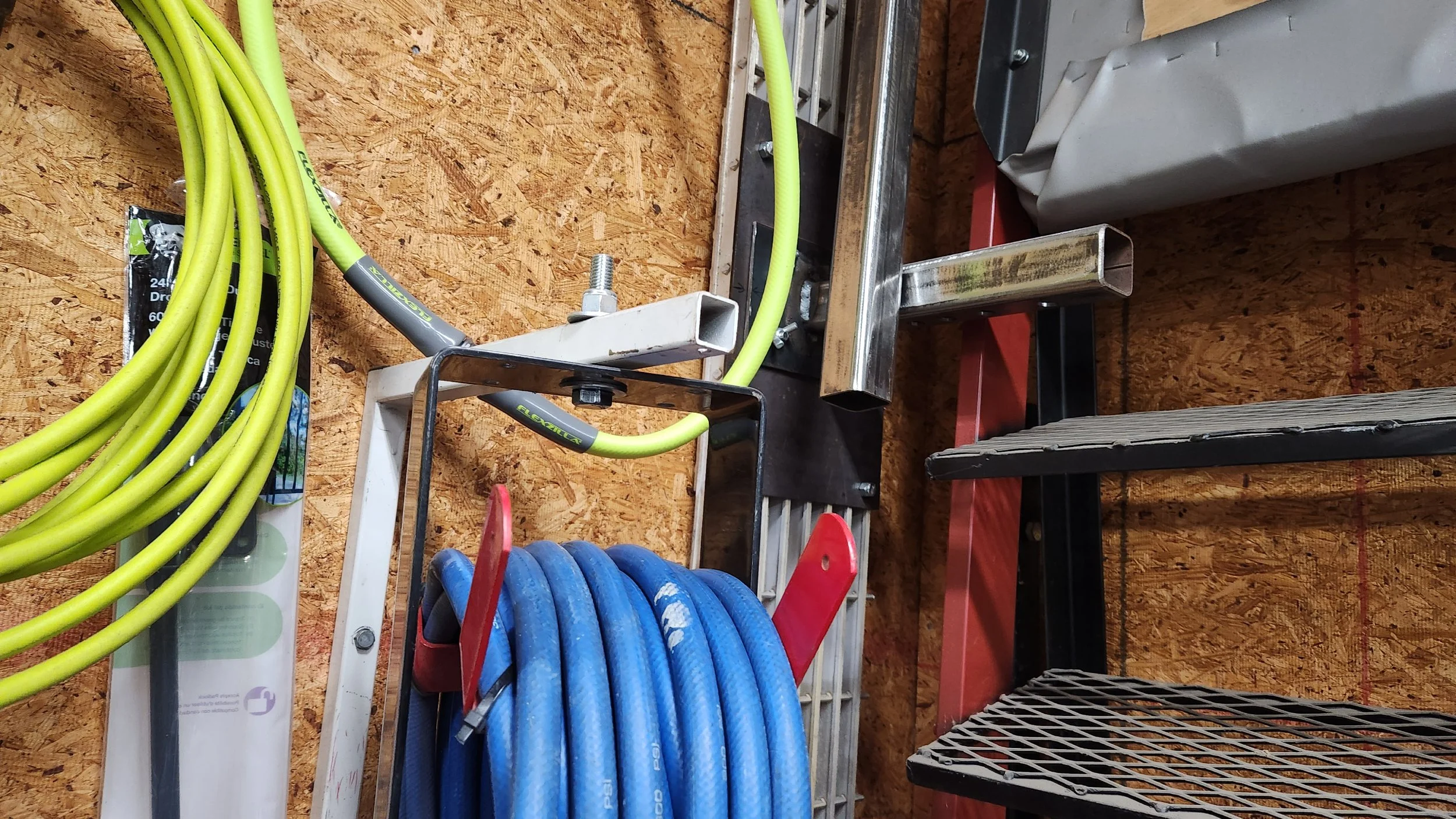

Instead of bolting mine to the wall I used an L shaped piece of square tube, bolted the tube to the wall with the other part sticking out from the wall then I bolted the reel to the tube with a single bolt in the center and some washers, loose enough to allow the reel to swivel in any direction. A Nylock keeps the hanger bolt from coming apart.

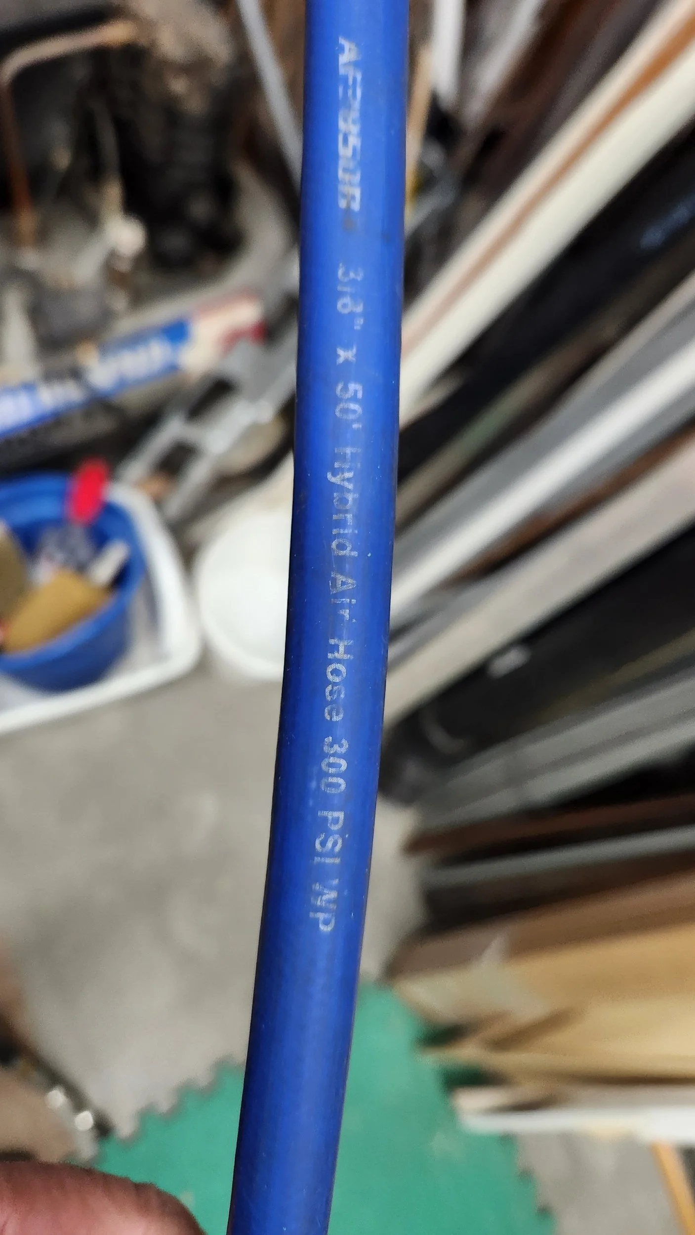

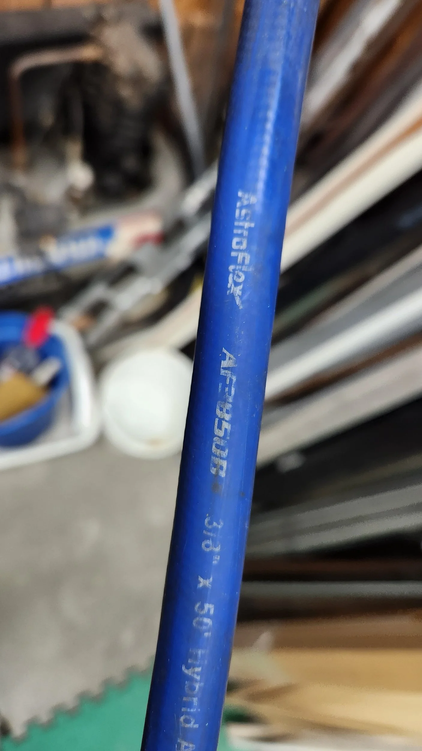

FWIW my main 100 feet of hose is Blue Pliovic (two 50 footers) which has lasted me many years and cooperates nicely on the reel. My backups are Goodyear rubber (now Continental) and those are a bit stiffer and heavier. Like I mentioned I don't try and coil those too tight, maybe 3 foot coils.
edit: I *think* it is Pliovic but now I'm having doubts and will have to go check after breakfast.
