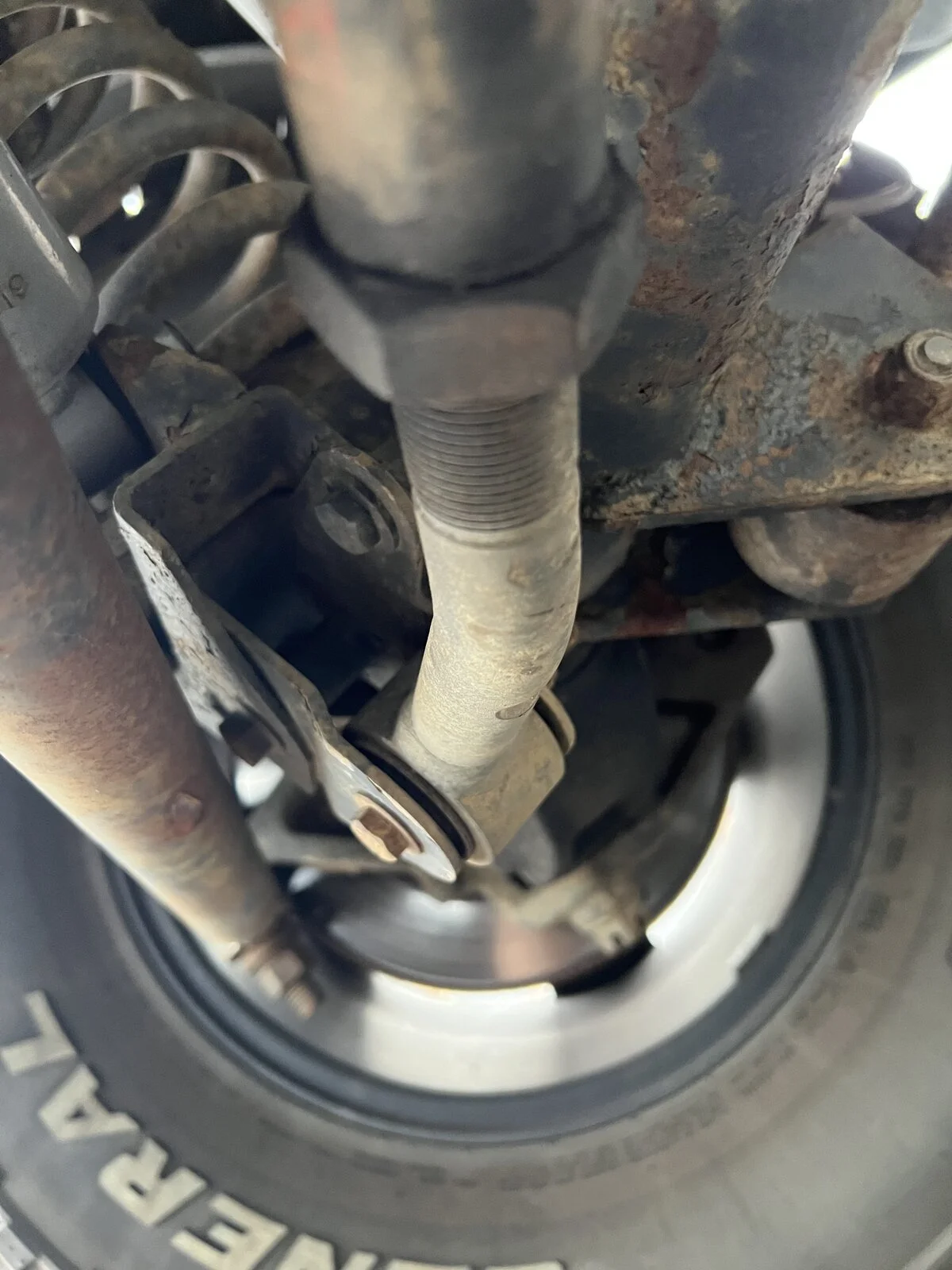

Hey I aw this and thought I'd ask.
I have an adjustable track bar, dropped pitman arm and track bar bracket. From my understanding, scrap the pitman arm for the stock and scrap the bracket all together.
img_7694-jpg.385386
img_7694-jpg.385386
You got it!
