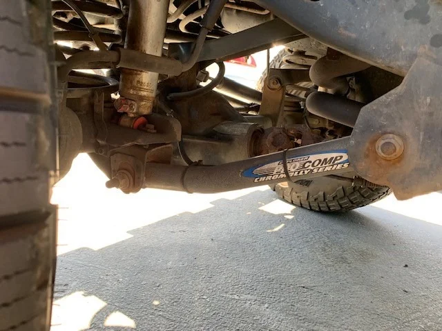

Thanks. Pitman arms are relatively cheap new. I don't notice too much bumpsteer currently. I was inquiring because I had been reading that a dropped arm was a bad idea. If I have to change every piece in the front end, I need to do a bit more planning. I thought maybe just swapping in a stock geometry pitman would be the first step. Maybe the first step is to compile a list of all the parts I might need to swap back to stock.
1. Pitman
2. Adj, trackbar
3.?
That looks like you have some old Fabtech stuff on there. Dropped pitman arms are bad if you are not addressing the track bar angle at the same time. I would take a good look at those control arms too.
