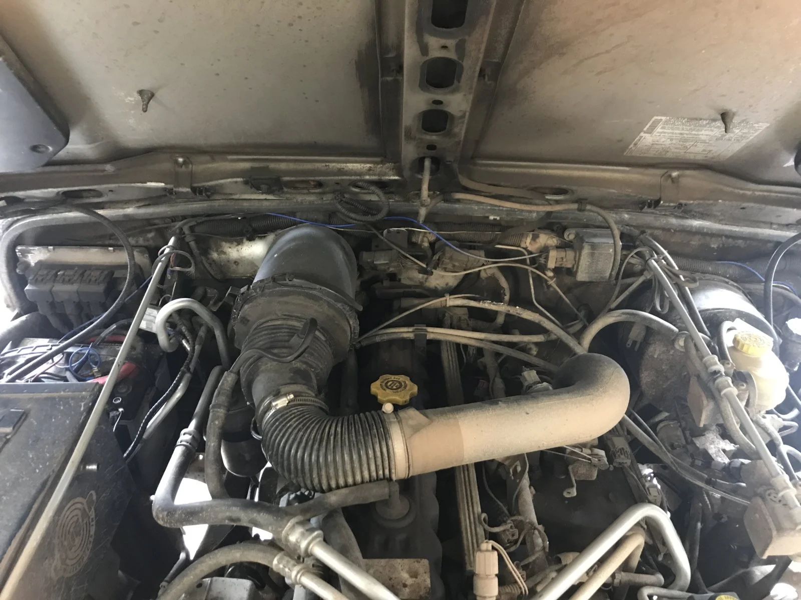

I have taken my TJ with the stock air box as deep as the bottom edge of the headlights with no snorkel. I have always been very careful and always knew how deep before I went in. I friend of mine with a snorkel actually floated his TJ across a deep water hole.

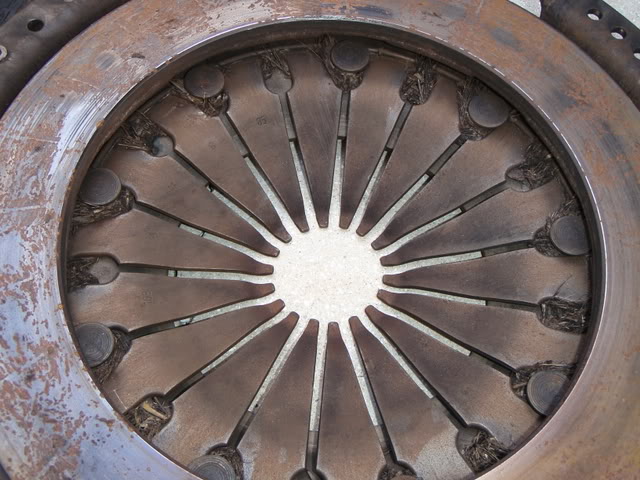

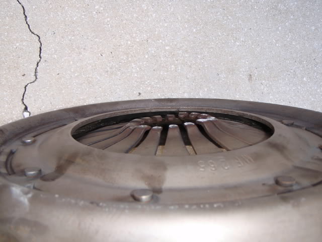

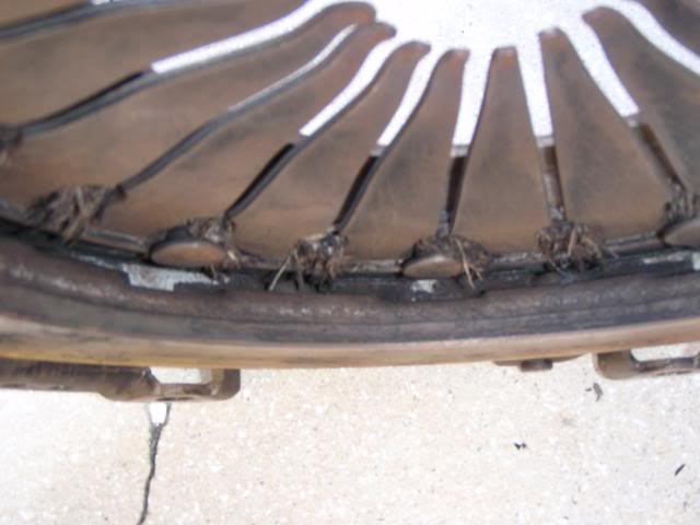

Think of water a cancer, basically you will not see any issues until later in life. Water eventually will cause issues with starter, AC compressor, clutch and wheel hubs. I have gone through 3 starter. My AC compressor has been making noise since 2010 and about 2012 it finally died on me. because of all the crap in the water and vegetation etc.. I had to replace my clutch because the pressure plate got clogged up with junk from the water. My 6Speed NSG370 transmission is also on its last leg because Jeep never added a breather hose it it and I never knew.

Water playground
Clutch
