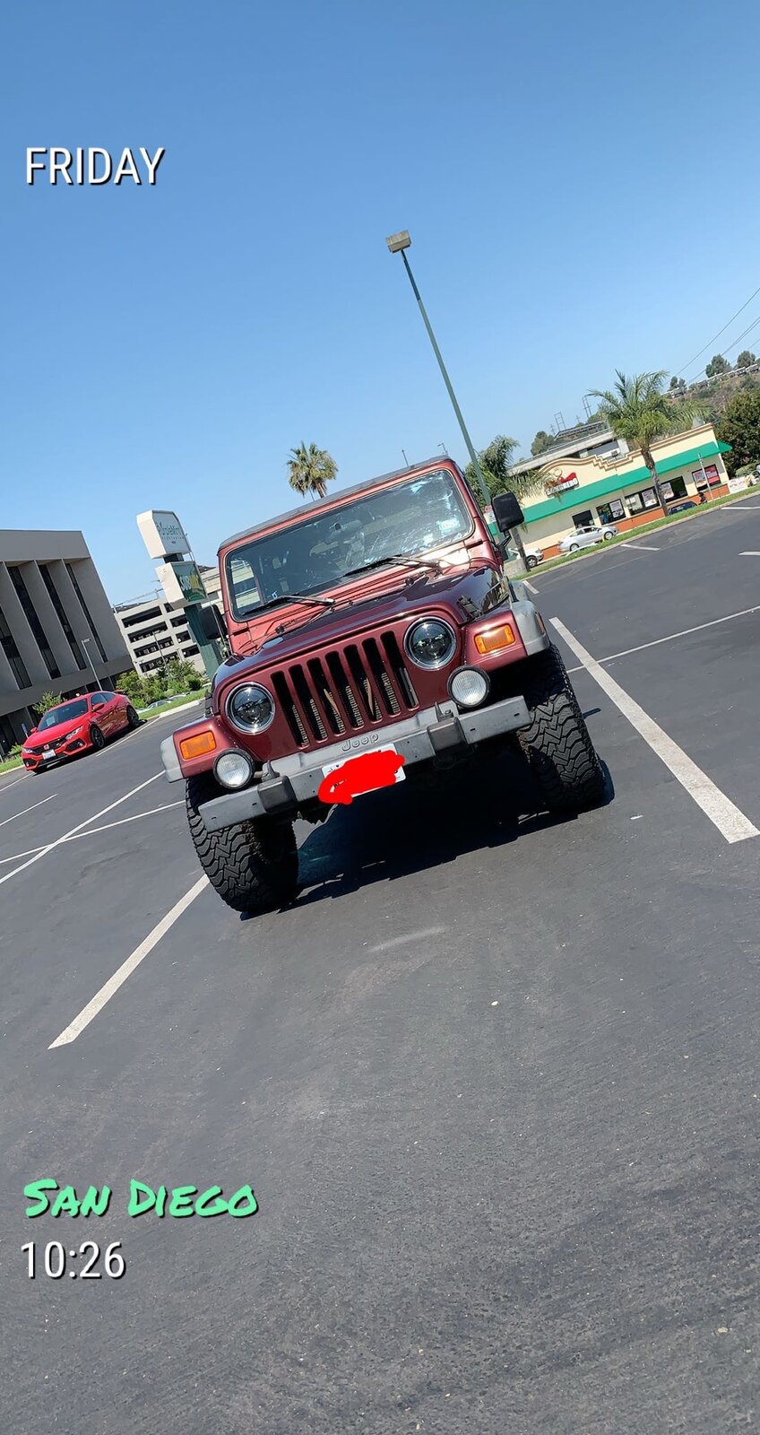

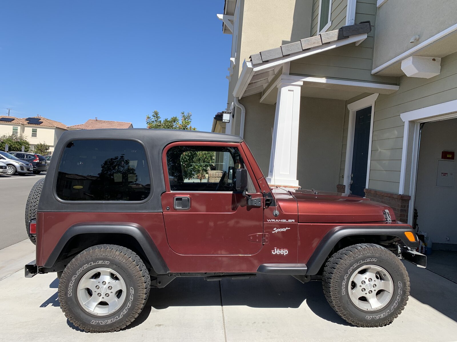

Hello all,
I'm new to the forum and still somewhat new to TJ ownership. I have a 2002 TJ Sport, 4.0L, Dana 30/Dana 44, 15in rims on 31's, all stock except for LED Headlights. My goal is to be able to run 35's. I've read through this thread and a few others and im looking to start purchasing parts and starting upgrades. My Jeep is my daily driver but I also like to take it offroading and camping and all of that. I don't do any super crazy rock crawling or insanely hard trails, but I have done Diablo's Drop off out here in SoCal once. I have about 10K saved up for upgrades. I'll be moving to Virginia at the end of the year so my terrain will shift a bit but i imagine that won't affect the upgrades too much.
All of this being said, I have a question:
1) What should be the order of things to upgrade? I want to avoid breaking things and also minimize cost (i.e. figuring out stuff i can do at the same time, rather than doing stuff like opening my diffs multiple times and having to buy seals and fluid all of that over and over.)
I've seen people somewhat answer this question but when I look into buying parts for an upgrade I keep running into situations where I can't do an upgrade without doing another upgrade 1st and then that upgrade requires another upgrade and then all of the parts are sold by different vendors and some of them aren't compatible, etc., etc., etc.
I figure the short answer is to just figure it out/ welcome to owning and upgrading a 20 year old vehicle, but I just thought I'd ask.
Thank you all for all of the time and effort y'all have put into this thread already! I look forward to anyone's input.
