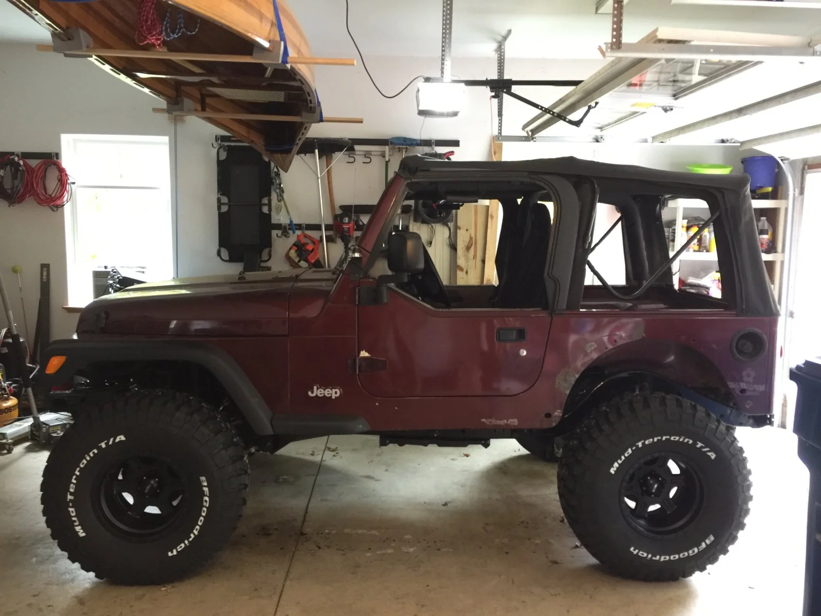

I just got a 4.0 with automatic it has 4in lift with 35s but 3.05 gears it really hates the 35s and previous owner also welded the rear gears but he gave me 2 8.8 rears one with 4.11 gears drum brakes and one with 3.55 disc breaks to make a disc break 4.11 and kit to put the 8.8 in my thing is if i have to buy gears for the front are 4.11 really enough i was thinking 4.56 gears and just build the 30 and 35 it will be on highway and dirt roads hit some mud holes in it and hunt out of it no rock climbing but some slick ass red clay gumbo and post oak mud
So if i remember correctly with your automatic transmission (32RH by the way) 4.56 should be the correct gearing. If i was in your position I would do a gear swap on the disc brake equipped 8.8 and swap that in. I wouldnt bother building up the Dana 35 since you already have the 8.8. Sell the other two extra 8.8's off to help recoup some of your cash when its all said and done! Hope this help's.
Reactions: Cgcrock
I just got a 4.0 with automatic (what year or transmission?) it has 4in lift with 35s. It has 3.05 gears and it really hates the 35s.
Previous owner didnt do any real research and welded the rear gears.
He gave me 2 Ford 8.8 rears, one with 4.11 gears and drum brakes, and one with 3.55 gearing and disc brakes. Disc kit is with 3.55 gearing for the 8.8.
If i have to buy 4.11 gears for the front to match possible 4.11 gesring in the 8.8 axle, i was thinking 4.56 gears instead front - rear, and just build the 30 and 35.
It will be on highway and dirt roads, hit some mud holes, and hunt. I will not be rock climbing, occasionally some slick ass red clay and post oak mud.
