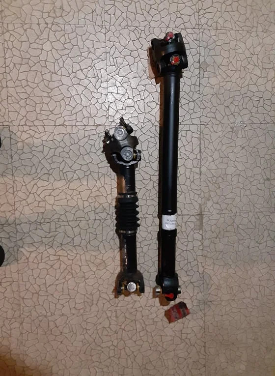

driveshaft is in......y'all know what they look like installed, so no pics.
i give up a pic of used to be vs now it is. didn't get the accordion boot on this 1 but i can swap it over if i feel the need.
