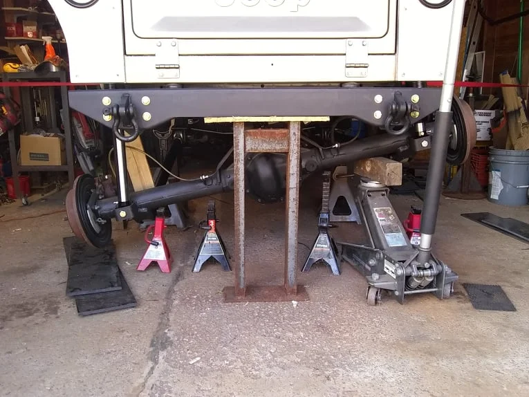

well the rusty stilts are gone, traded up for fancy hardware. gonna pressure them up tomrw. it's about 1/2-3/4"'s below where it will sit in the pics.
not diggin how close the valve is to the mount and need to cycle things to check, might need to take a die grinder and radius an easement.
i dicked around an for to much time figuring out that gas fume issue. i think i got it beat. i piped the vents into the charcoal brick and it seems to have helped significantly. now i gotta find room to stuff it out of site.
to air those beasts up i have to drop it to the basement, full compression and then take the elevator up. i get some pics of the basement.
and after looking at the pics i think i better be sure that bottom knuckle end wont rub on the inside when it droops too. IFRC those boxed brackets where for hanging off the top of the tube originally and i flipped them to run them under and never coisidered the hole was not centered. and i see i'm in the deep end.
so i cycled this stuff and the bottom lobe confinement and the valve will be fine. i couldn't get full extension due to a vapor lock in my struts but within 2.5" of the basement.
now i have a new concern. at a full articulated droop a strut is gonna go 90* and possibly just into the minus side at full extension (another 2.5").
the rear upper triangulation seems to be effective. but is this an issue or not?
