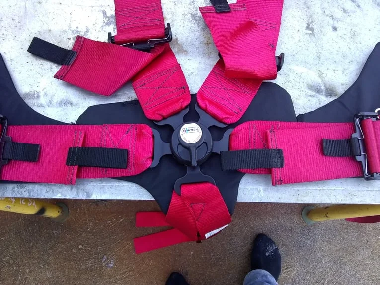

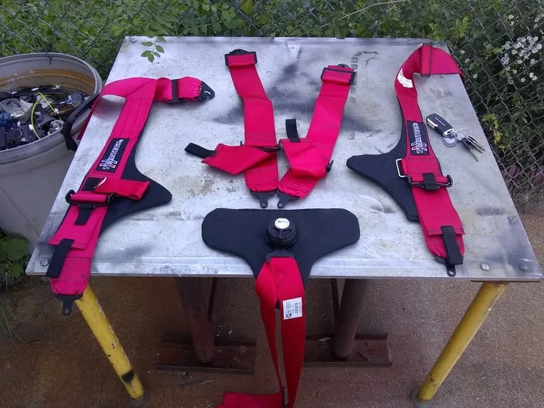

my shop owners mechanic came in today and i asked him what he knew about seat harnesses, since the boss was into racing and has oh, IDK 5 or 6, 1 of a kind race vehicles he takes out and plays with on wkends. he says follow me, we gt into the back room and he tosses this at me and says take it............they can't use it because of the date stamp. but it's only been in 1 car for 1 wkend and then tossed into the never again box.
tad bit more than i need with the nutbuster on there but it'll keep me secure. and i need something since the OE belts are gone. it'll do for now, but it doesn't scream comfortable to me.

What are the odds… I have that exact same harness sitting in my garage that I got from an old racer when the dates expired. I’m interested to see what you come up with for mounting to the floor

The latch still works without the "submarine strap" doesn't it? Back in my Formula SAE days, those nut busters were critical to prevent sliding down in the seat. We had a joke about the belts... Make them hurt for a couple minutes before driving, or they'll hurt for days after.

i got it hooked together all wrong but figured it out. i think it's the JetPilot harness 4-500$.
i don't think the anti sub strap comes loose from the lock. or it needs to be tripped to release it doesn't come free like the others

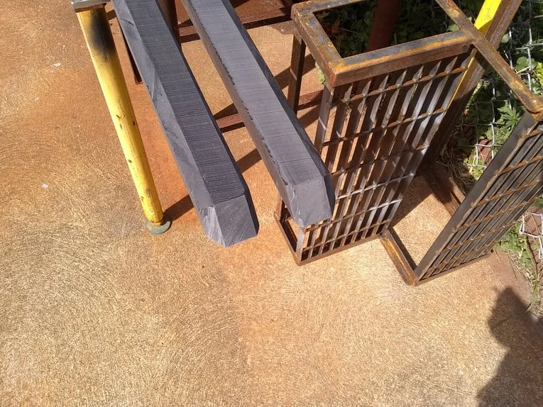

snagged these 2 big ass drops of UHMW from the dumpster 2" x 1.5" x 5', fits just right in between those flares so i might just make some rub rails along the top edge of the rocker.
maybe take a 1/2"-3/4" x 45* cut of the bottom outside edge and a 1/4 x 45* off the top to knock the edge off.
angle in the front and back edges with some lead in.

Those will look real nice as rub rails.
i'd be happy with just "they work".
even in a bar this size it's still flexible along the length, but a small section is hard to bend. so enough fasteners not spaced to far will be key.
where it should excel is when it would be side loaded against something.
and hey if i jack um up they only cost me some bolts and my time. .

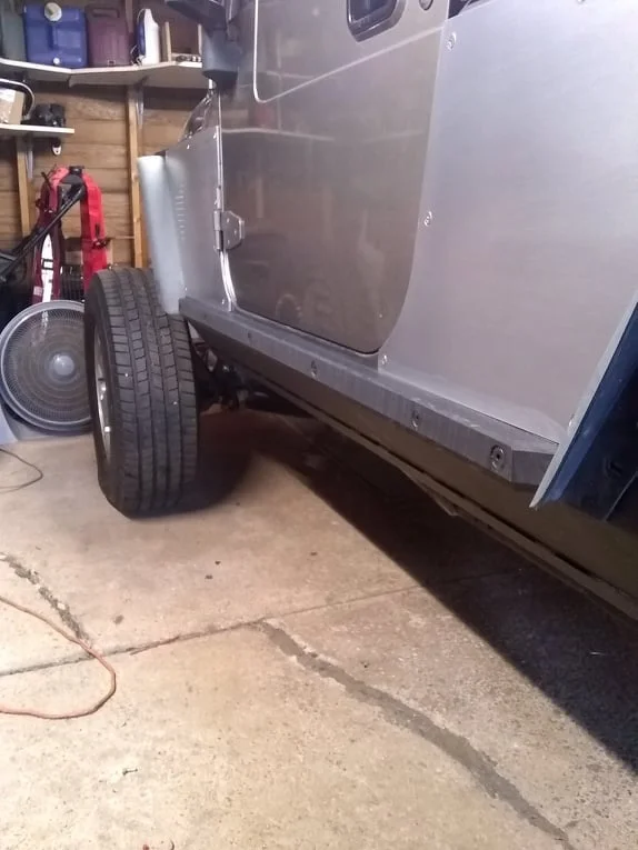

so i spent a little time messin with the table saw and got a shape on the UHMW bars. not proud of the counter sinks but it's all good from 10ft.
and a pic of how it looks mounted.
the holes in the tub with nutserts stayed 5/16". the through penetrations now have 3/8" hardware in them (2 under the door and the last).

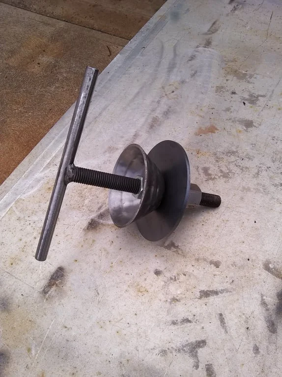

and i had some time to kill at the shop ..............and lug nuts on the spare might be a PITA, so i whipped this up. maybe i can incorporate it and have a single fastener and let the cone pin the rim ID..

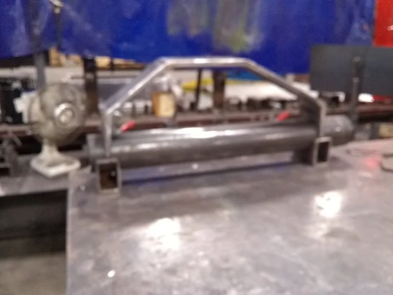

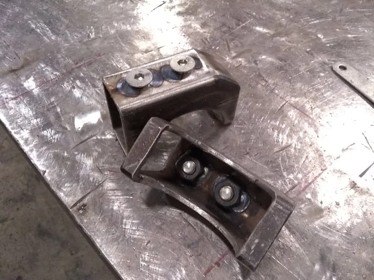

bent up this thick ass 1/2" beast to keep control of that monster 14B and a couple brackets for the bottom of the tube to hang a drag skid from.
the truss needs adjustments........i don't measure stuff and most times i build by memory or eyeball. i can take the height down another 3/4" by making the tube notches deeper.
Looks great. Damn you make a lot of stuff at work for your rig. Not that I'm complaining.
I like the slider above the boat side. Can we get some pics of how you sealed off the boatside front and back?

dam now i'm busted............ nothing yet. the aluminum inner fender covers the front edge, and the back end is the open angled profile for now..
so the front edge of the "slider" is only a few inches forward off the torque box end, so there is not much there to be bent.
the rear end is carried long, past the body by almost a ft. i did not want that elongated wheel opening with a huge void ahead of the wheel and right now it still over hangs the ends of the armor cut and needs trimmed about 2" more.
i do have material to then gusset/box both ends and the rear would benefit from an inner fender brace to help distribute any loading force.
