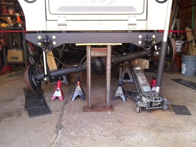

pics sucks, no room and bright sun, sorry.
axle stuffed and links and driveshaft at full compression..
bottom floor everybody out................ i have a couple inches under the tub still and could have used them had i chosen a 12" strut or poked the top through the tub, but my OCD said keep all 4 corners the same. and i wasn't ready to rip the tub internally more than i have already done to sink the fuel cell.

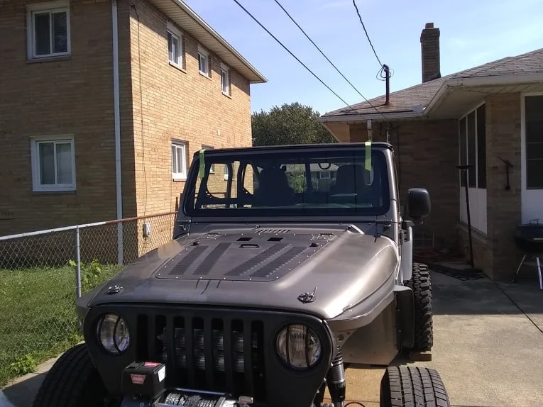

installer was all good with it all and tickled he didn't have to dig 1 out, had it done in an hr.
roll bars didn't effect him on the inside.
he didn't just lay out a gob of cement and smash it down. he laid a nice wide patch on the whole pinch seam at least an inch wide all the way around the frame, then did the same to the glass about 3/4" around it's perimeter then mated the 2 for a nice wide seal.
and IDK why the F i can't take a decent picture, but i'll post it anyways.
