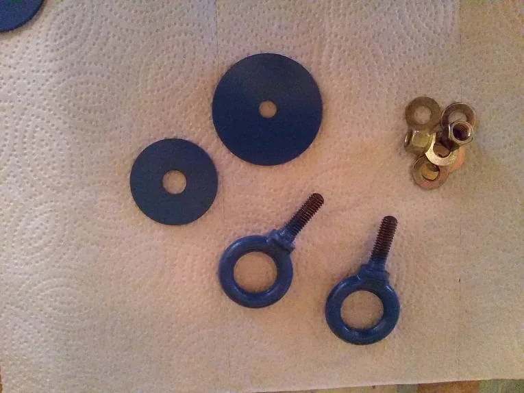

I’m interested to see what you come up with for mounting to the floor
not sure if i'm gonna use that monster or not but if i do i have rings for the floor for the shoulder straps.
the lap belts would also be bolted to the floor with aid of an L bracket and a couple large washers.
