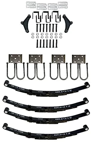

suspension kit ordered (5200# ea axle), all new stuff from the frame mounts to the U bolts.
not this but basically the same.
