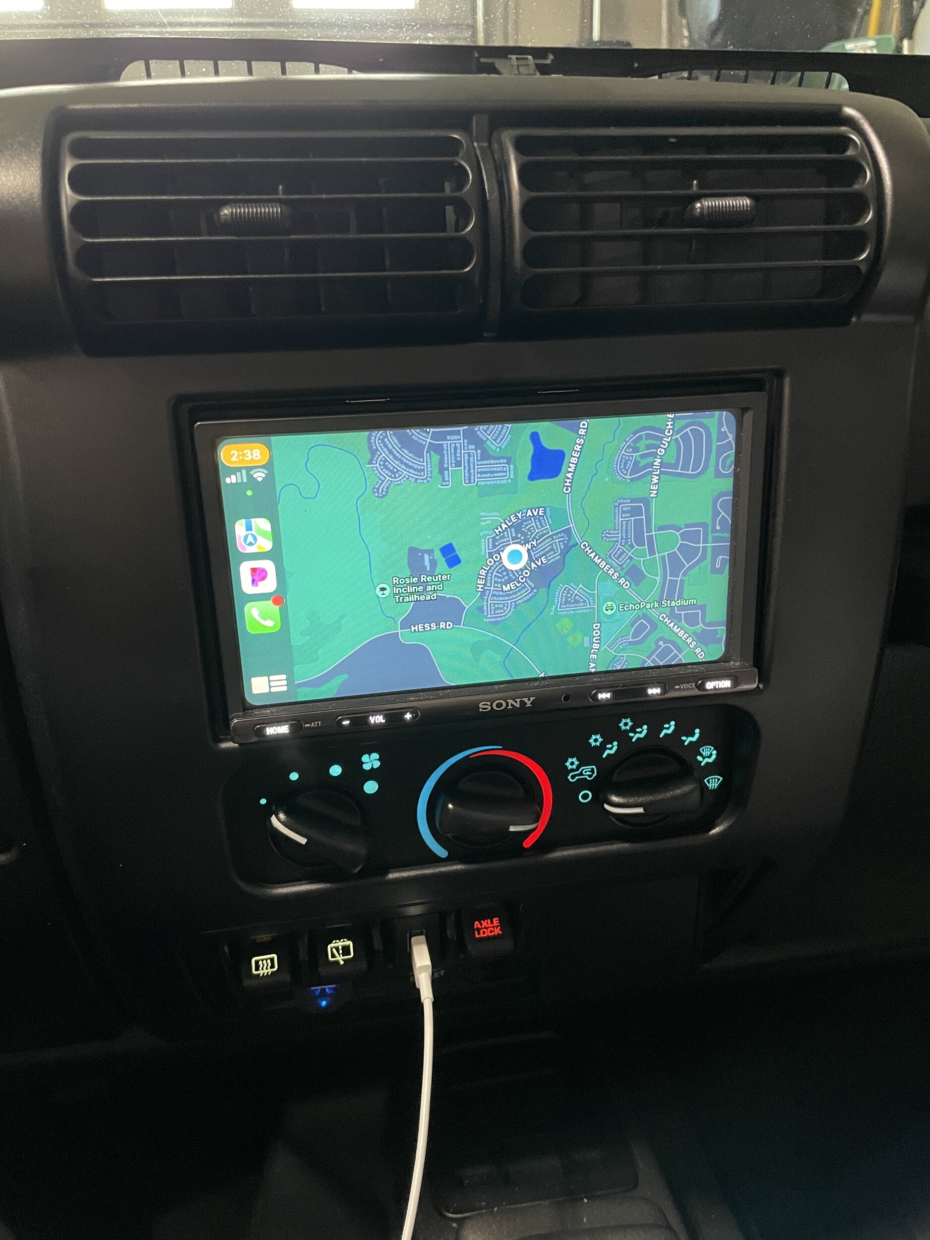

Absolutely love it! No cutting and I used on old switch blank I had laying around for the usb.
Reactions: AndyA and AndyG
Thanks, I just measured the usb housing and then dremeled the proper sized rectangle in the switch blank. Looking back and not that it would be much of a difficult task but I wish I would have moved my hardtop switches over towards the axle lock switch and put the usb in the first switch location. Personal preference I suppose but something to think about if you’re going to have it all apart. I am stickler for not wanting to cut holes in the dash or any other panel for that matter figured I had a couple of extra switch blanks laying around in my Jeep parts box so cutting one those up did not phase me.

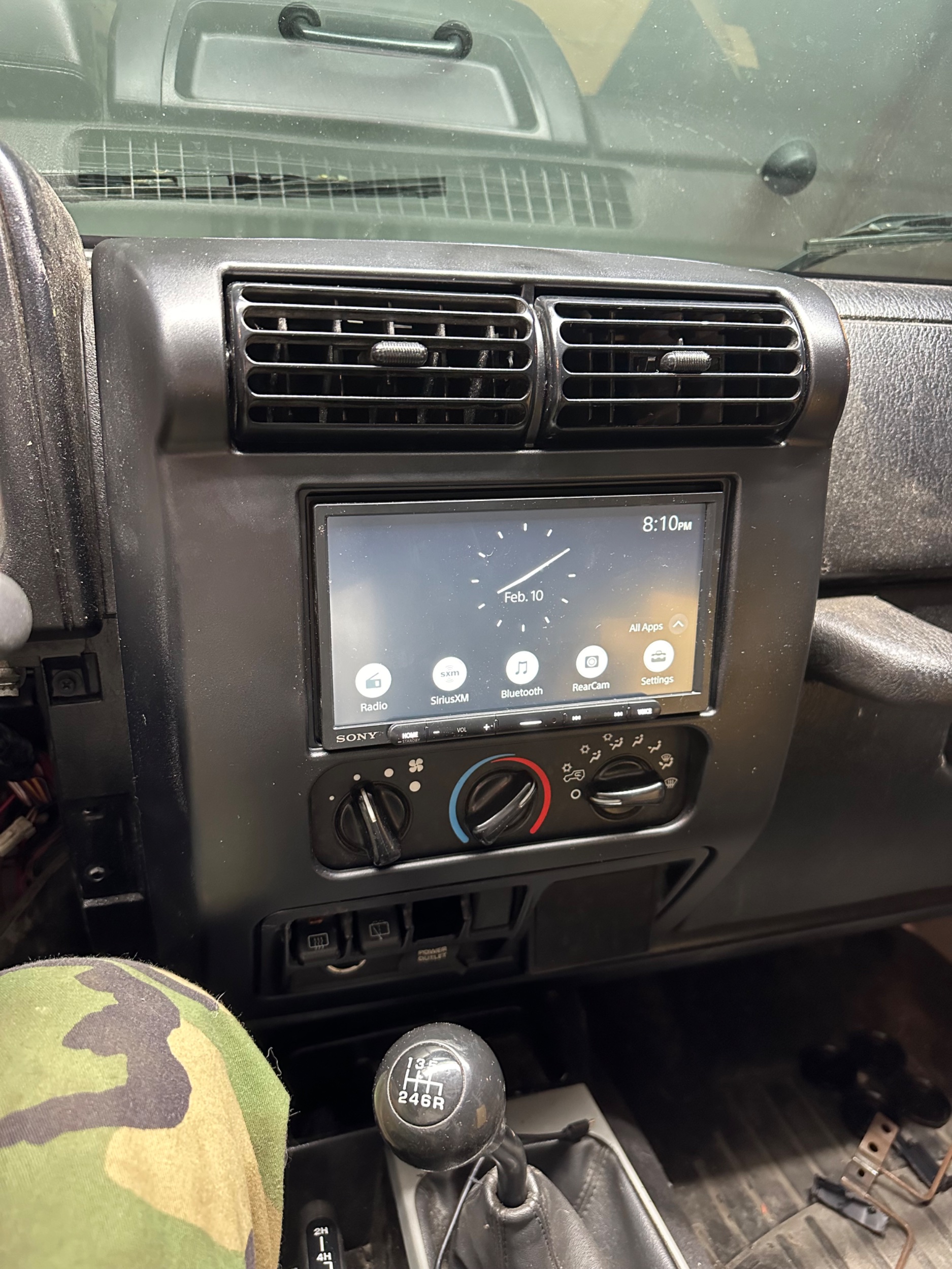

Here is the final mess of wires:
And here is the result.

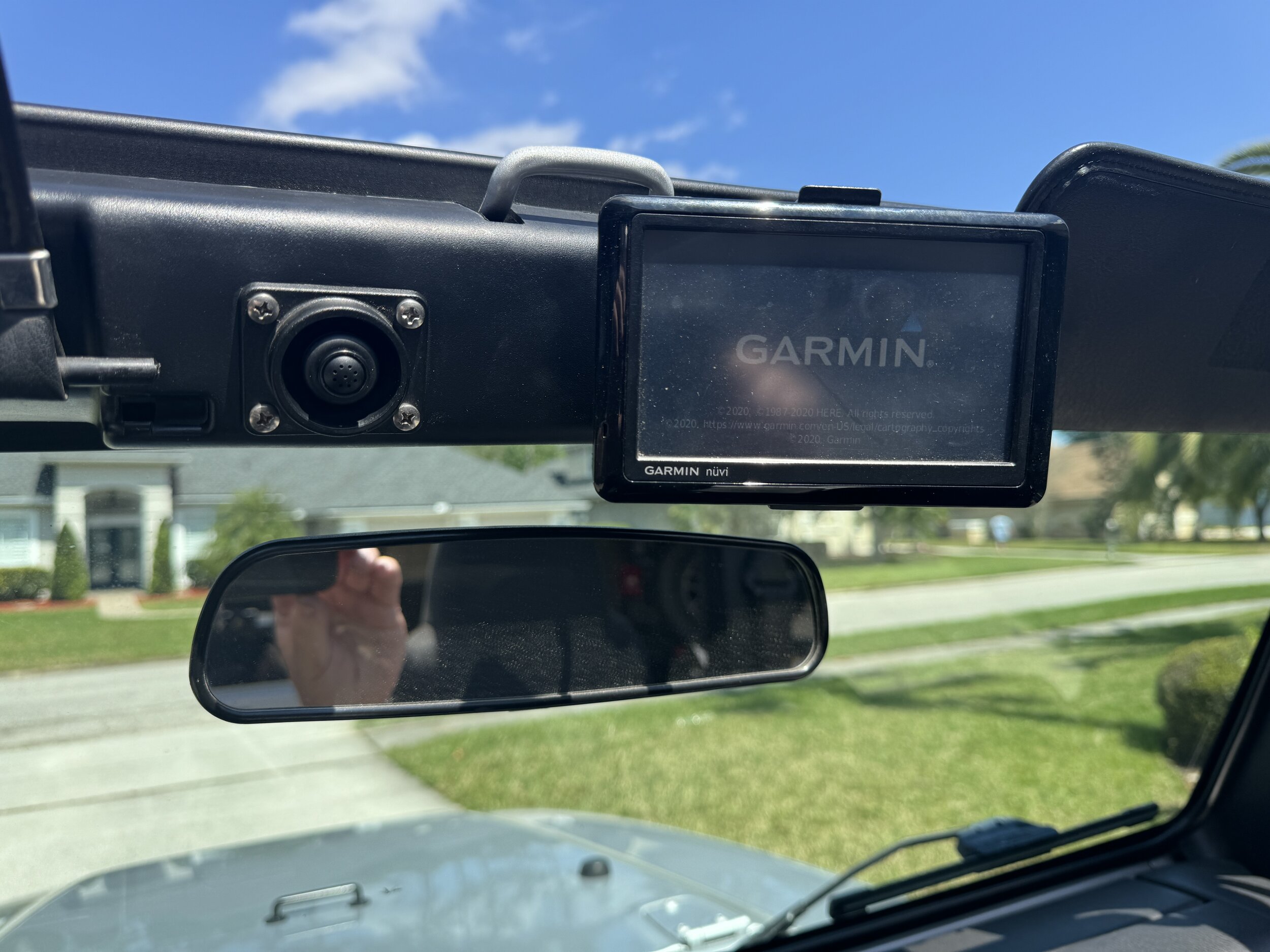

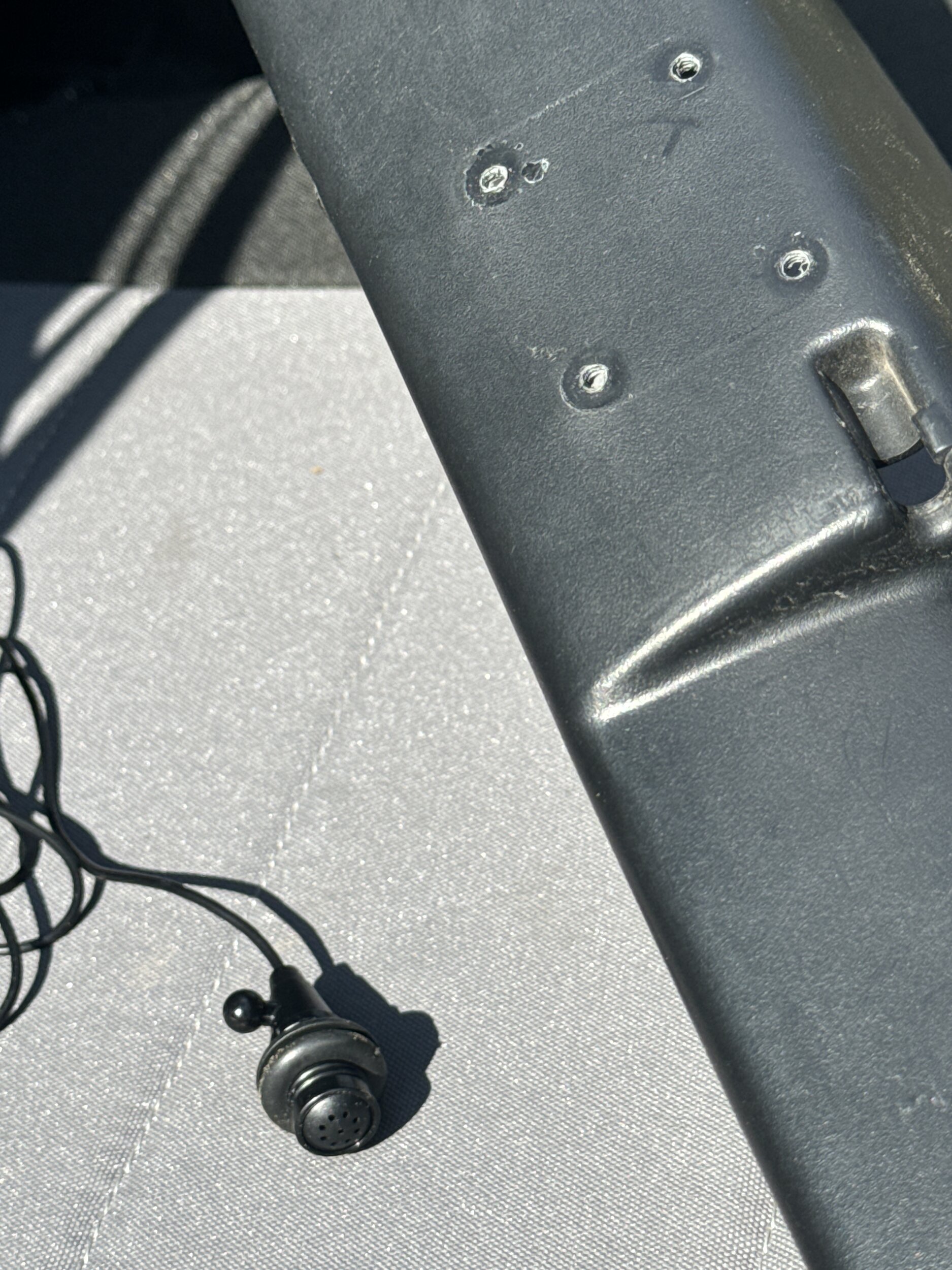

Thanks for the thorough write up! I installed a double DIN right away when I got my TJ but it's been buggy and not a great screen so I used this thread as motivation to upgrade. I found the Sony XAV-AX5600 for same price as the OP's XAV-AX3200. Very similar features but the 5600 has a better screen. While I'm waiting for it to ship I stole the microphone idea but modified it some. I had also installed a phone holder up high on the trim piece above the windshield, it was not a great place for the phone so I moved the phone but it is a great place to mount the mic. I also had the four small holes that I wanted to cover up. I used parts of the old phone holder, a grommet, and metal clip to make it all work.

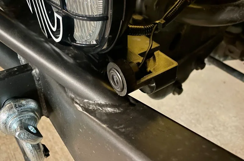

The front camera mount kept coming loose - something to do with the stresses on the 3D printed design. I decided to re-work it for the front bumper, sitting under a KC fog light.
