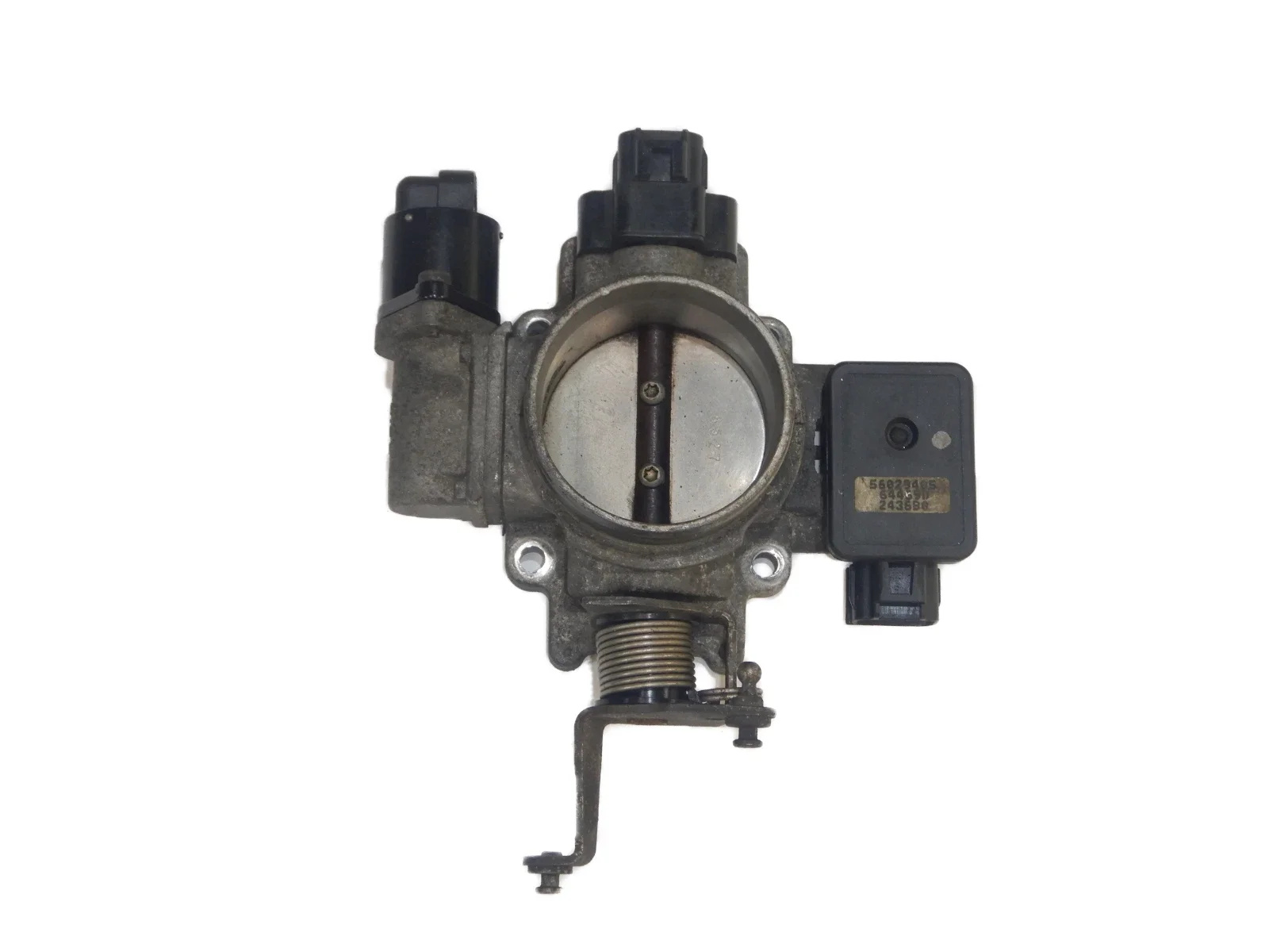

Here's a photo of a throttle body for reference; the throttle cable arm is towards the bottom of the frame, the MAP sensor is on the right, the TPS is up top, and the IACV is on the left. In your engine bay, the throttle cable part will be facing the grille, and the TPS will be towards the windshield. You'll need to disconnect the intake and move it out of the way, unplug the three sensors, pop the little plastic end of the throttle cable off, and then take the four little bolts off that attach the throttle body to the intake manifold. Then you can give everything a once-over, reassemble, reseat the connectors, and give it a whirl. If you want, slap a picture of the IACV in here when you get it off, and I can eyeball if the plunger looks stuck out (it was on mine, which is why it was dying unless I had my foot on the gas). Oh, and if you need a new IACV (or possibly the other two sensors too), it might be worth trying to order at least OE if not OEM, because my parts-store-brand sensors kinda suck, and it's only been a year.
Sorry if that's a little confusing, it's actually a pretty easy process. For a less verbose explanation, possibly w/ some visuals, you can just google "Jeep TJ Throttle Body Cleaning" and scope out one of the numerous YouTube videos on the subject.

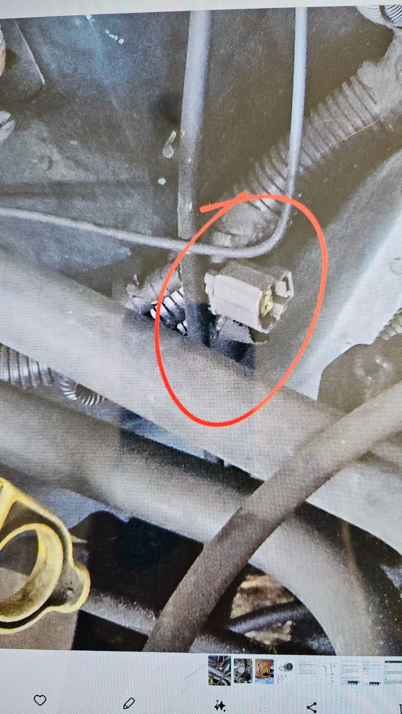

Was overthinking it. Started right up with the new battery. But, in looking things over, I came across these 2 loose connectors. I think the first one is for a/c (which I don't have). What's the other one?? x
