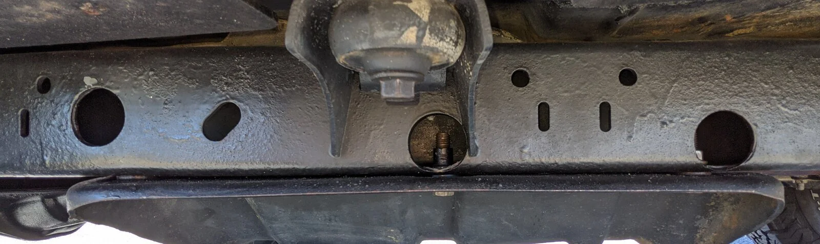

Been awhile since I've had my skid off, but I thought it mounted flush to the frame?

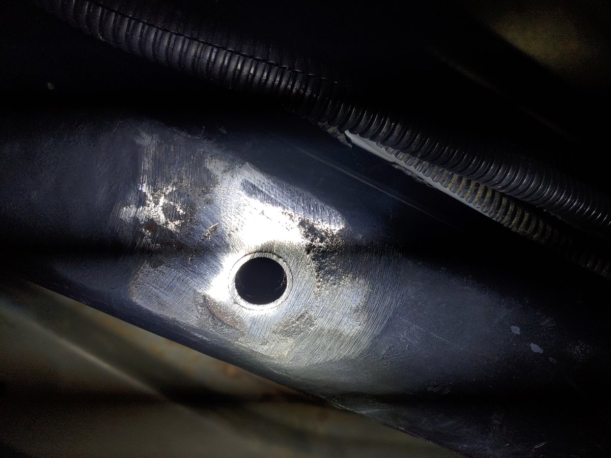

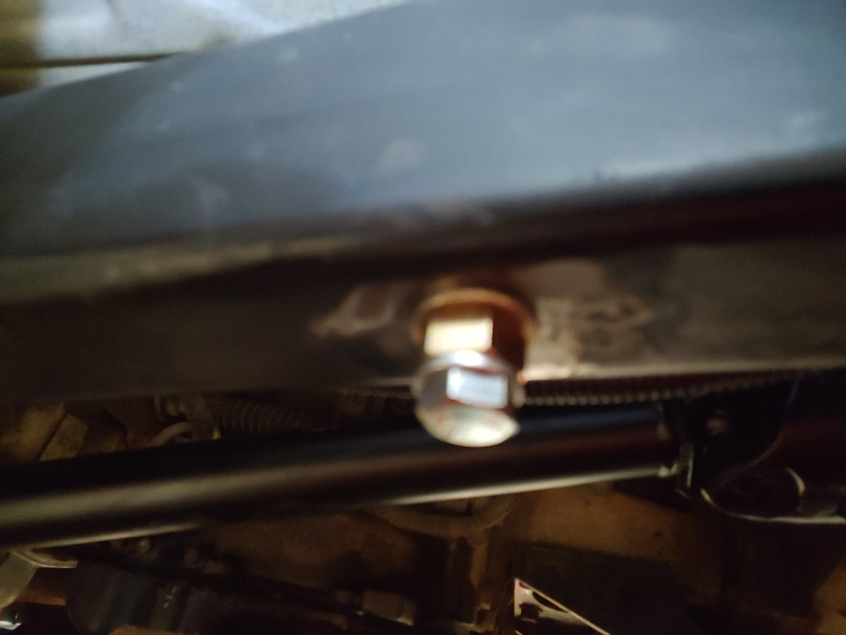

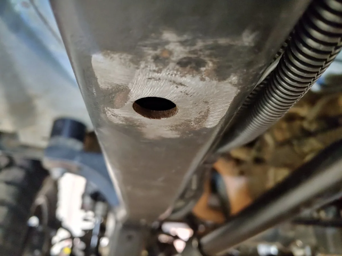

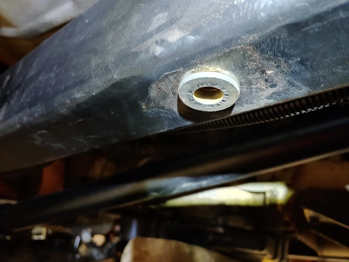

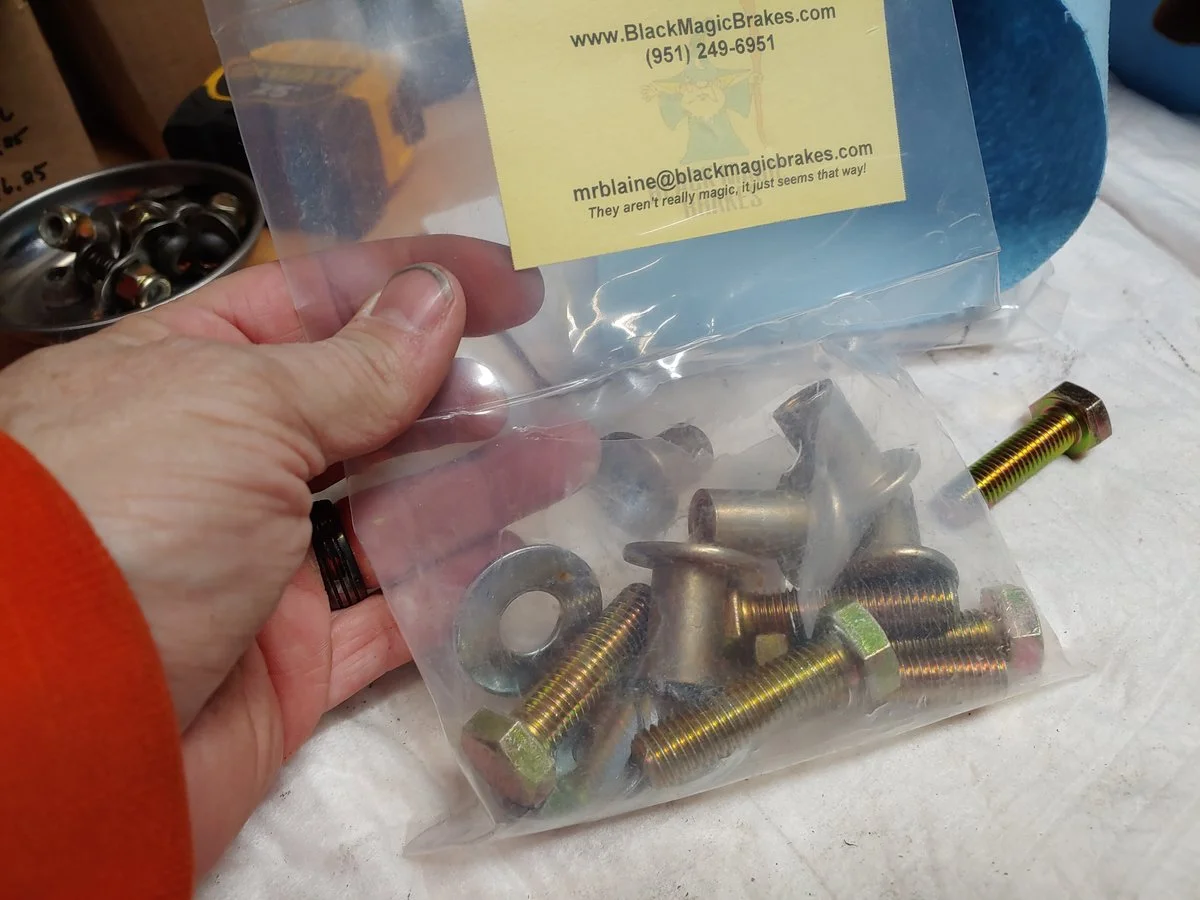

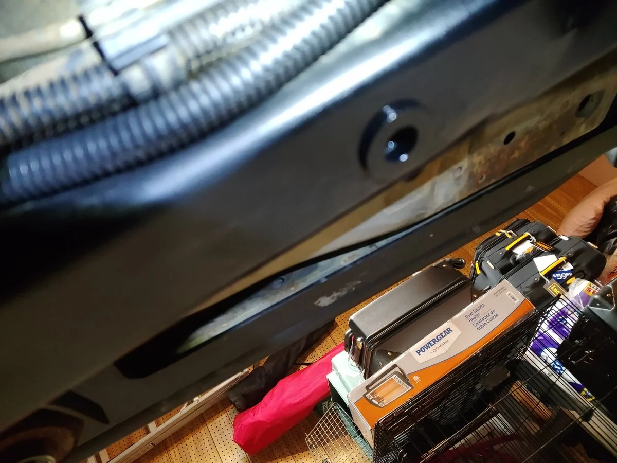

Nutserts arrived today.
1. Make DIY nutsert tool
http://www.justaddrocks.com/Nutsert_Instructions.htm2. Grind down nutsert flanges
3. Punch though nutsert barrels and fish out with magnet
4. Insert nutsert with tool and torque to 50 ft lbs.
5. Paint frame and nutsert area.
Worked like a charm; stripped nutsert problem solved. Thank you @mrblaine
I might have overlooked it, but where did you get the nutserts from please.

Frame hole size for early and late nutserts is the same, .625 or 5/8". Just replace the nutsert and don't complicate things.

There is not enough material to run a 5/8 tap through.

Do you guys just leave the left over bits of nutserts rattling around in the frame rails?
I did. But It only took a few minutes with a magnet. Had it taken longer or required more effort, they may have stayed there.
