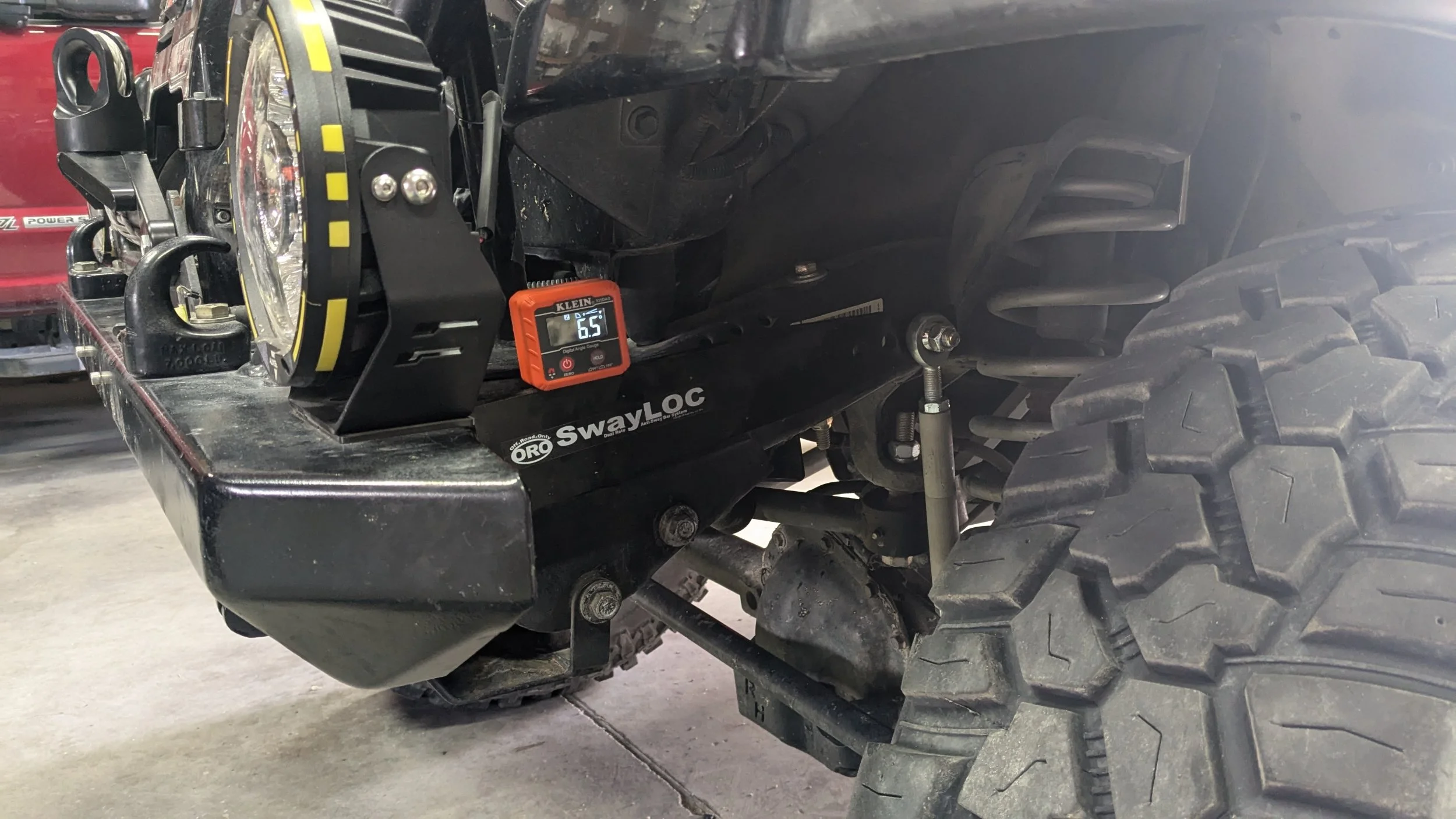

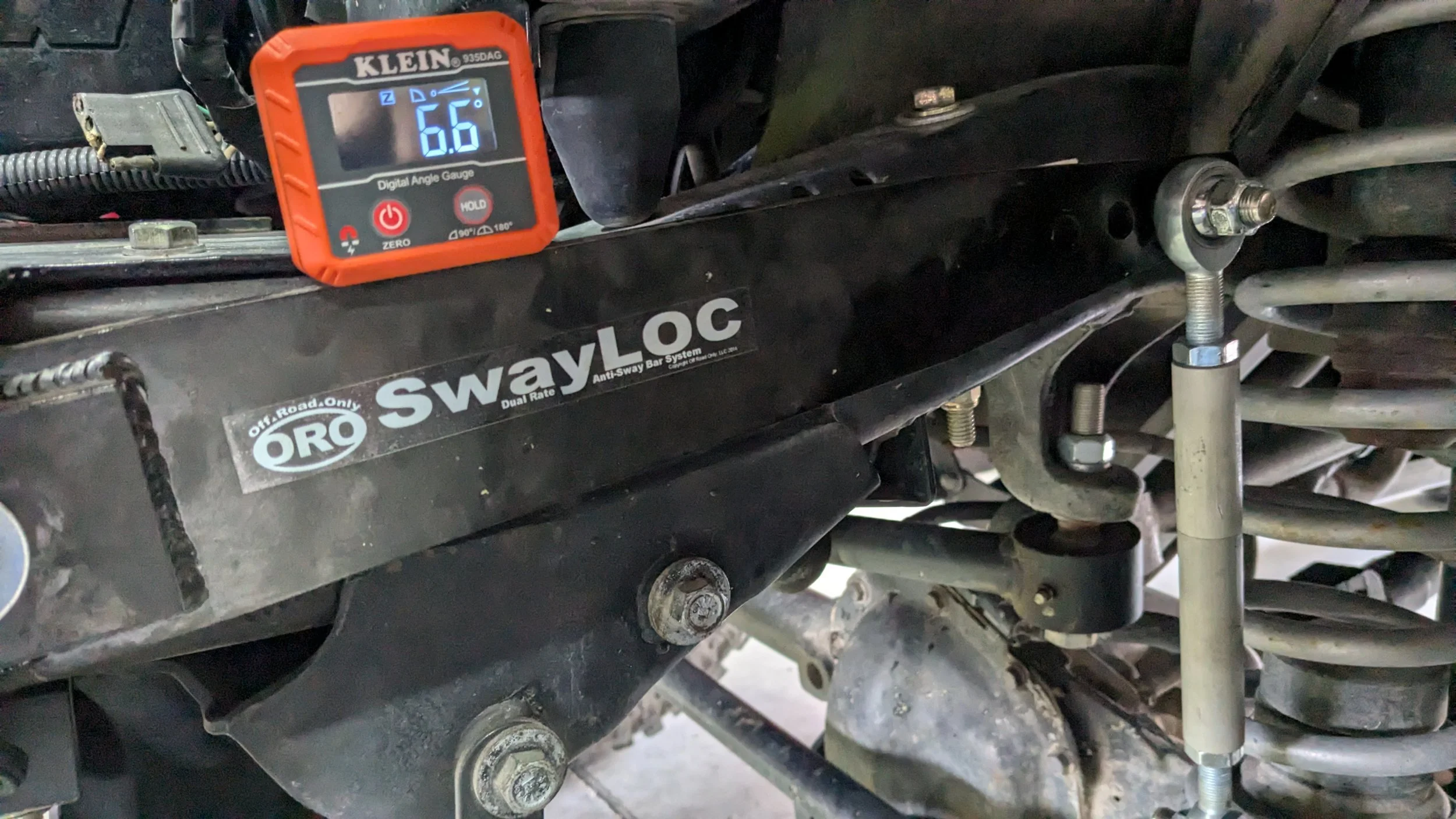

Finally got on and off-road after 2 months out of town w/o the LJR. Had a recovery Monday and did a couple hundred highway miles RT and 20 ish off-road.
Love this SL. But.. wanted to try the 2nd from back hole to see if on road might be even better - so I moved it and, since I was in there, adjusted the link lengths to increase the angle.
Ended up at 6.6* which is about double what I had.
S'aright?
S'aright?
I've never measured the angle. I just set it as high as it could go without hitting the back edge of my bumper at full stuff/bump. That minimizes tire contact and is much too high to invert at droop.
