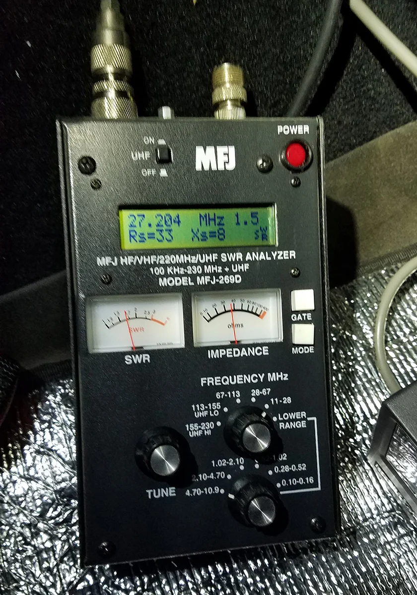

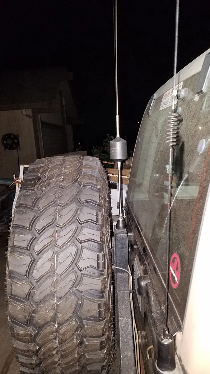

I run a Wilson 5000 and it gets to 1.5 SWR on ch 20.
I don't have any Firestiks.
Reactions: SSTJ and CharlesHS

Some people have good luck with the Firestik and some don't, I have witnessed the tail light mount torn off while on the trail and consider upgrading the coax to RG-8U. Recommend you borrow a stainless 3' whip, move the antenna mount to the tire carrier area and then retest that antenna SWR...
I would bet you would end up with an SWR of <1.5 across the channels.
