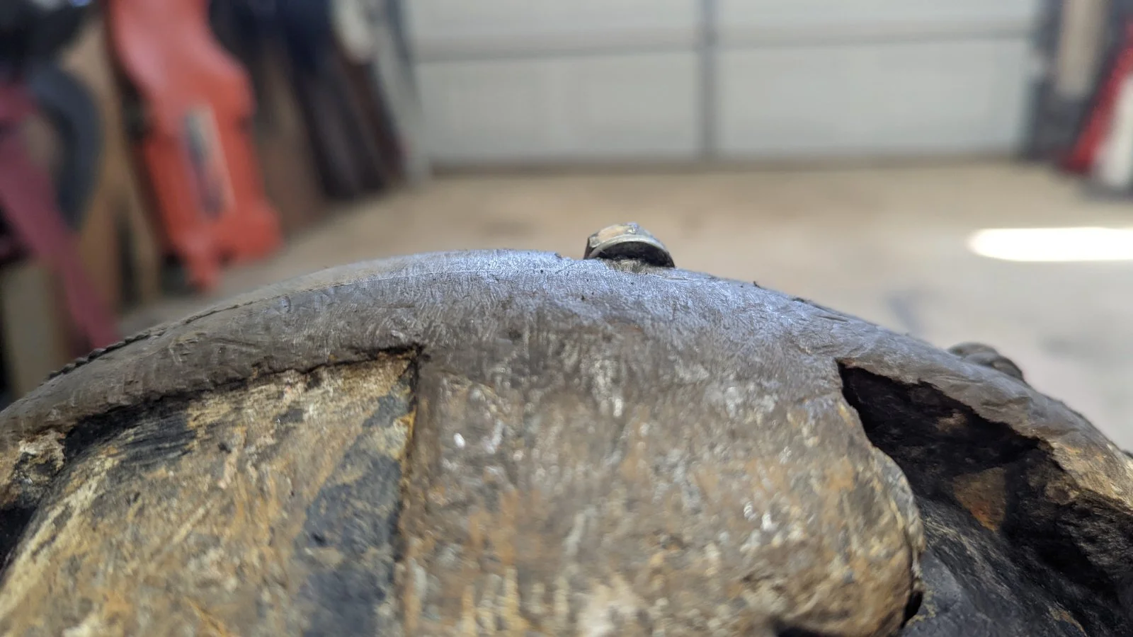

I am not much of a picture taker, but I got a few.

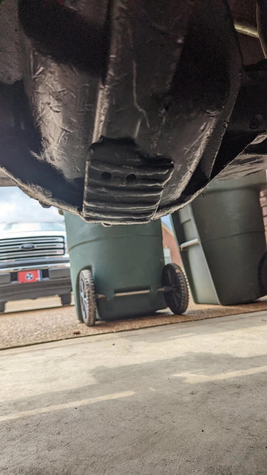

Here is how much it was wore down:
And here is the plate installed:
The horizontal beads is the hardface.
I used my press to bend the plate, it had to be bent in two directions so it took some tweaking to get it right. The two holes in the plate were already in the plate from another project, they weren't added or needed for this.
Not sure if this is the correct way, but I will find out!
What made you decide to do the hard face laterally across the axle instead of along the axis of the driveline?
I did think that running them lateral would be better but horizontal was more comfortable for me to run the beads. Also, my original thought was to cover the whole plate with beads (no gaps) thus direction wouldn't matter because it would be an equal height surface. However, the heat input was pretty high with running those beads and I didn't have the time to allow to cool and burn more beads (needed the jeep back together). If the hardfacing looks like it holds up, I will run more beads the next time I have the axle out (I bought 5 lbs of rods!)

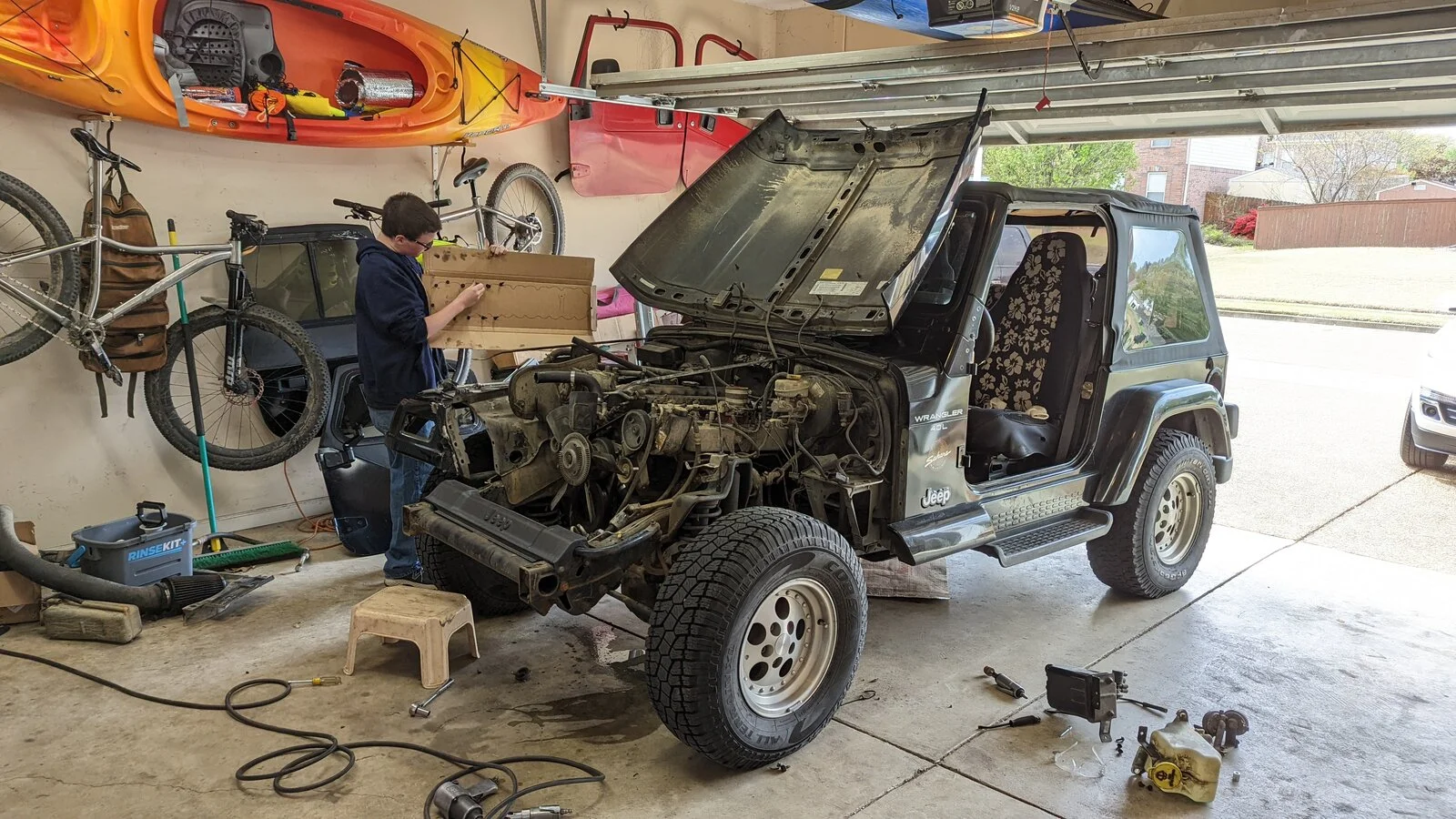

Christian had Good Friday off so I took the day off so we could work on his Jeep.
Two new fenders, new grill, and I had him change the valve cover gasket since it was leaking. He learned that your always one broken bolt away from a long day when reinstalling the valve cover, lucky it wasn't the very back bolt and we were able to get it out pretty quickly. I still need to straighten the bumper but he had to go to work so that will wait.

The plate that I added to the bottom of the rear diff seemed to hold up well, all the paint was removed and it was shiny, but there was no gouging or mat'l missing from the plate.
