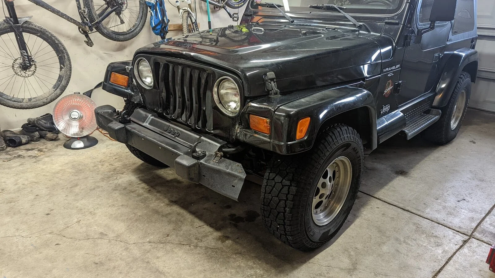

On Christian's TJ, I was able to bend the grille back enough to get a new radiator installed and to get the headlamps pointed forward. I did that last Friday so he was only out a vehicle for one day. He said he likes the look because it gives it character. He really just doesn't want to be without his wheels!!

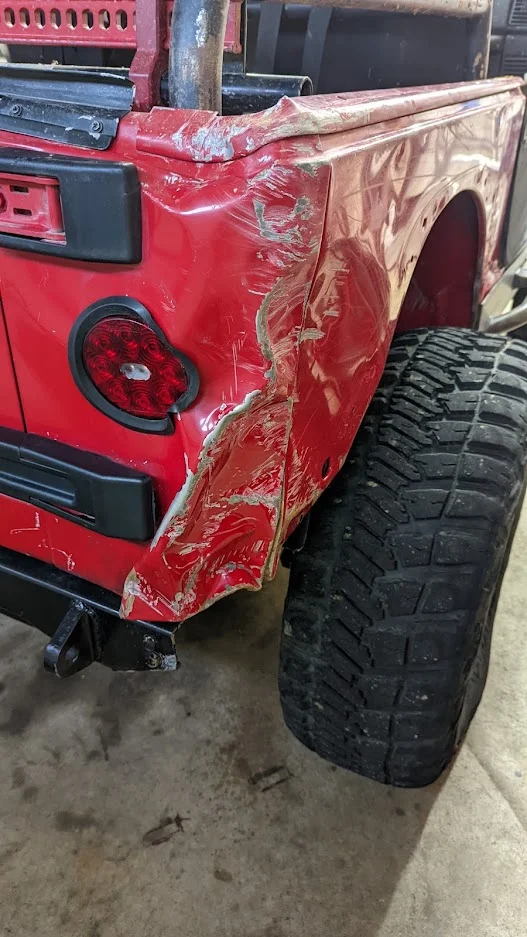

-Right rear corner. Not worried about the body damage, but I will need to fix(bend back to somewhat original) top rail so that I can install soft top.

Vic - do you have a spare front driveshaft? If not, my advice would be to order a TW shaft, then send the Adams shaft back for repair. If it’s a warranty issue, push them to cover the parts as well. Then keep the Adams as a spare.
….and yeah, I remember watching that corner go crunch.

Post ride inspection showed the following:
-really dented in the right rear corner and broke off plastic tailgate hinge surrounds.
That is quite a bit more than a "dent!" I read, "really dented" and thought you folded the fender in our something... I did not expect that!
What pisses me off is not that I "dented" the corner, it is that I still ended up pulling winch cable. Then to top it off, Jeff made it look easy a few minutes later.
Reactions: TRE3TOP and Wildman
The part that pissed me off was winching because of deep ruts. Even after you knocked the top off I still had to winch. I had a great time and hopefully we will have better conditions next time.
Yeah, those ruts sucked. I think winching my diff housing through there may be what damaged my winch rope. I think that is the hardest my winch ever worked, at one point I was wondering if it was even working since I was barely moving. Chainsaw and reroute would have been better.

-Straightened and tweaked the right rear fender top rail to allow for soft top to be reinstalled.
